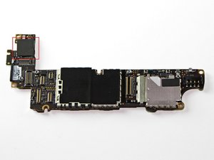

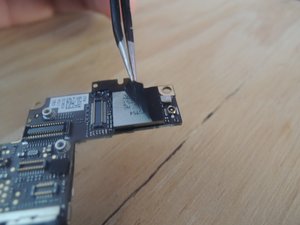

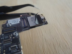

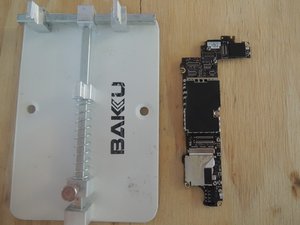

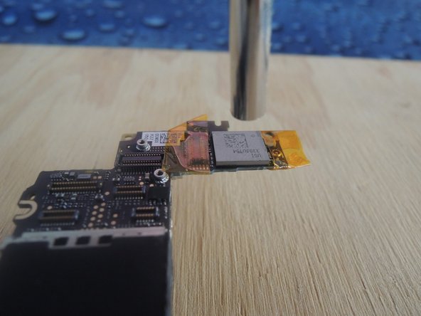

    • Remove the adhesive protection on the Wi-Fi/bluetooth chip.
    • Now we can see the Murata SS1830010 chip.
  25. How to Fix iPhone 4S Wi-Fi Grayed Out: step 25, image 1 of 3 How to Fix iPhone 4S Wi-Fi Grayed Out: step 25, image 2 of 3 How to Fix iPhone 4S Wi-Fi Grayed Out: step 25, image 3 of 3

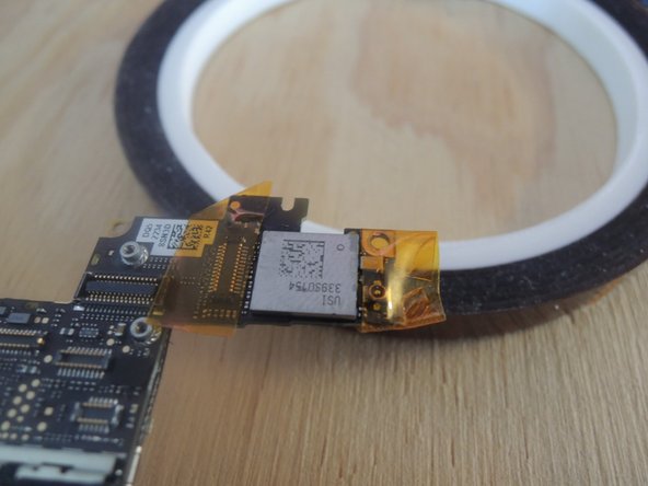

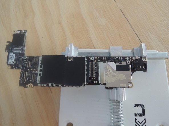

    • Put the logic board in a PCB holder or small vise, to safely hold it while reflowing (it's going to get hot!).
    • Protect the logic board with Kapton tape that has good insulating and temperature characteristics (temperature range: −269 to +400 °C).
  26. How to Fix iPhone 4S Wi-Fi Grayed Out: step 26, image 1 of 1

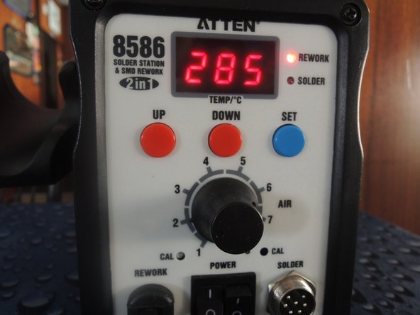

    • Now we need a hot air rework station with a small nozzle:
    • The nozzle's size must be 1/2 or 1/4 of the chip size.
  27. How to Fix iPhone 4S Wi-Fi Grayed Out: step 27, image 1 of 3 How to Fix iPhone 4S Wi-Fi Grayed Out: step 27, image 2 of 3 How to Fix iPhone 4S Wi-Fi Grayed Out: step 27, image 3 of 3
    • Edit: the correct temperature is almost 180-200 °C because around the chip there is a little black protection that can go under the chip.
    • Set a low air flow: 1 or 2 (on a 1 to 7 scale).
    • Now, doing circular movement, you have to reflow for 4-5 minutes.
    • Be careful to reflow only the Wi-Fi chip and not any of the surrounding ICs or circuits.
    • After 5 minutes, gradually decrease the temperature from 200 to 0 °C.
  28. How to Fix iPhone 4S Wi-Fi Grayed Out: step 28, image 1 of 1
    • After reflowing, wait ten minutes to allow the logic board to cool before handling it.

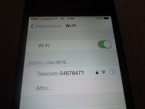

    • Here is the final result.
  30. How to Fix iPhone 4S Wi-Fi Grayed Out: step 30, image 1 of 2 How to Fix iPhone 4S Wi-Fi Grayed Out: step 30, image 2 of 2

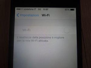

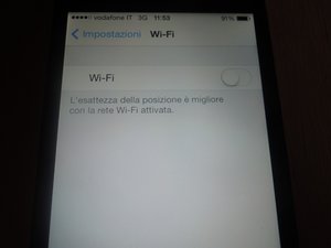

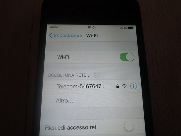

    • These are the pictures before and after the reflow:
    • In the first image, the Wi-Fi color is light grey (not working).
    • In the second image, the Wi-Fi color is dark grey (working).

Mille grazie, Andrea! I completed the repair thanks to your awesome Guide. Could it be you forgot to describe disassembly of the camera + surroundings? I took it out, too.
However, thank you,
Alex
Alex Holzhey - Reply

Congratulations!!! It works perfectly!! Step by step following your guide and everything is fine.
Thank you
