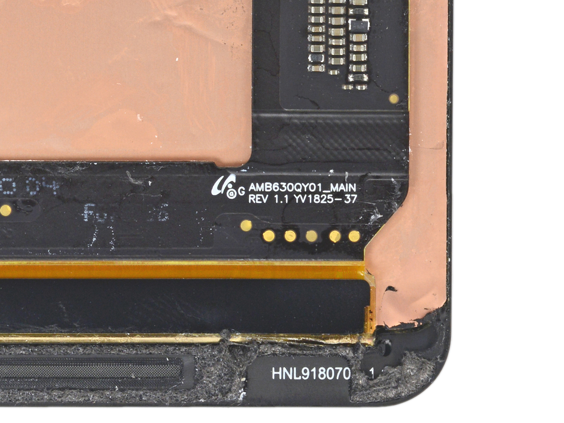

    • In the name of science, we opt to dismantle our display to learn from whence it came. Its defenses are strong, but no match for heat, patience, and a can-do attitude.
    • At first, the frame's black border tricks us into thinking the display curves down to the frame. Future pryers, beware!
    • Drumroll please.... it's a Samsung! Rumors were all over the place, but it looks like Google is going with Samsung's trusty AMOLED panels this year.
    • Samsung's panels should be a little more reliable than last year's, but unfortunately this one comes with a Samsung-esque repair process as well.
    • Replacing a Pixel 3 screen will be tricky, and will most likely require replacing the whole frame of the phone.
    • Last, but not least, a display chip sitting alone on the display cable:
    • Samsung S6SY761X touch controller (as seen on the S9+)
    • GigaDevice GD25LQ80 8 Mb serial flash memory
