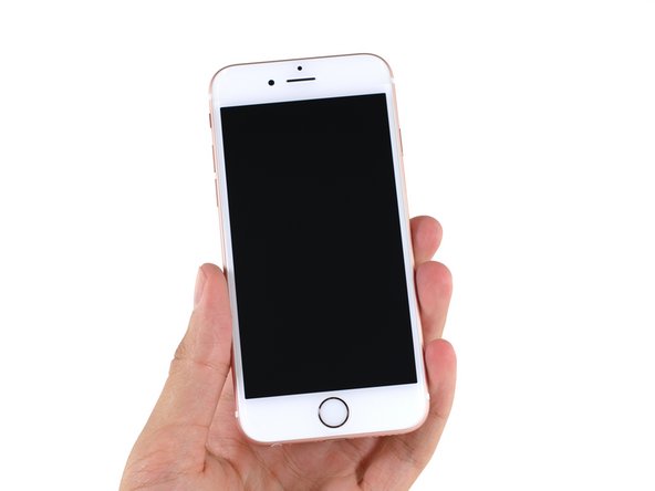

    • It’s finally time to see what this revolutionary new iPhone has in store for us.
    • At a glance, the 6s is the spitting image of its older sibling, but there's a lot more to it than meets the eye. Here's some of what's under the hood:
    • Improved Touch ID home button
    • 5 MP FaceTime HD Camera
    • Retina HD Display with 3D Touch
    • Laid out side-by-side, there are few notable differences between the two—sans the new Rose Gold enclosure.
    • Upon closer inspection, the 6s is a hair larger than the 6 (138.3 x 67.1 x 7.1 mm vs. 138.1 x 67.0 x 6.9 mm), and it's stamped with a new model number: A1688.
    • The 6s has also packed on a bit of weight when compared to its older sibling, weighing in at 143 grams vs. the 6's 129 grams.

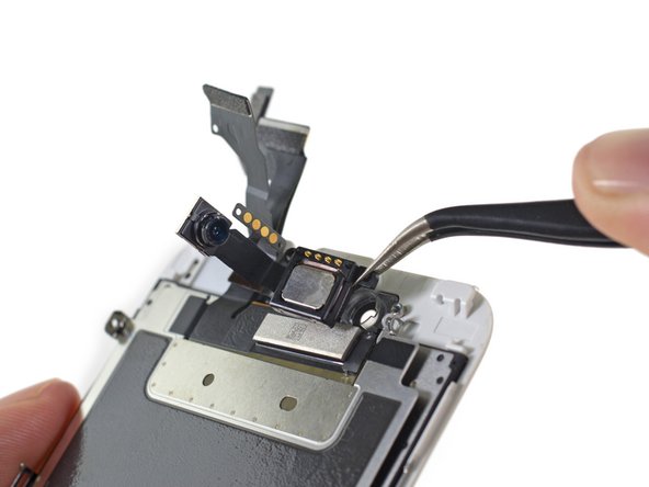

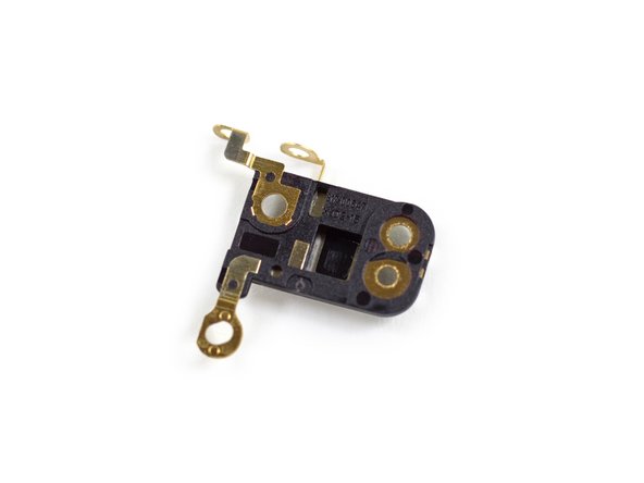

  8. iPhone 6s Teardown: step 8, image 1 of 3 iPhone 6s Teardown: step 8, image 2 of 3 iPhone 6s Teardown: step 8, image 3 of 3
    • In order to take out the shield plate we first have to remove a bracket, speaker, and the FaceTime camera.
    • While the FaceTime camera has jumped from 1.2 MP all the way up to 5 MP, its overall form factor remains surprisingly similar.
    • We have to take a moment to calm down as we get closer to unearthing the secrets of the new 3D Touch display assembly.

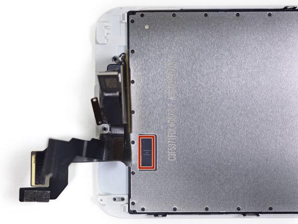

  9. iPhone 6s Teardown: step 9, image 1 of 3 iPhone 6s Teardown: step 9, image 2 of 3 iPhone 6s Teardown: step 9, image 3 of 3
    • With the LCD shield plate removed, we get our first glance at what we believe is the 3D Touch IC:
    • 343S00014 (Naming scheme is very similar to other Apple ICs, but the jury is still out on the manufacturer)
    • By the way, we want to (again!) send out a big thanks to our good friends at MacFixit Australia for letting us use their office in Melbourne for the teardown. They stock Mac and iPhone upgrades/accessories, and also carry our iFixit toolkits. Thanks MacFixit Australia!

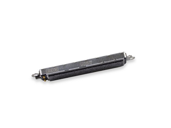

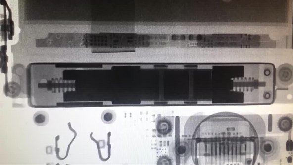

    • Back to rose gold tacks... It's time to take out the iPhone's new Taptic Engine.

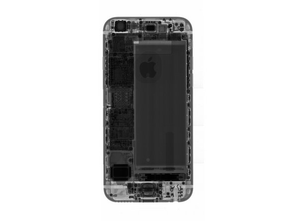

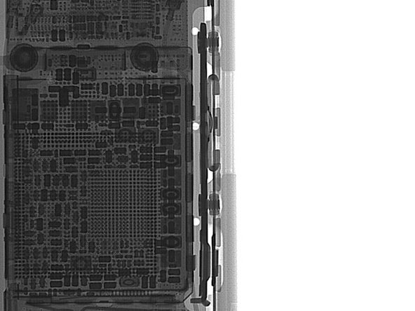

    • A blast of X-ray radiation reveals a peek at the linear oscillating mechanism underlying Apple's latest mechanical wonder, said to reach peak output after just one oscillation.
    • That's not Photoshopped for contrast—dense materials like magnets absorb more X-rays, so the haptic feedback mechanism looks dark and crisp compared to other materials (like the aluminum frame).
    • Once removed, there is not much showing what is going on inside—just a couple spring contacts, some cryptic markings, and big label complete with the Apple logo mark.
    • If you 3D Touch your phone while wearing X-ray specs, this is what you'll see. Shake it like a Polaroid picture, Taptic Engine.

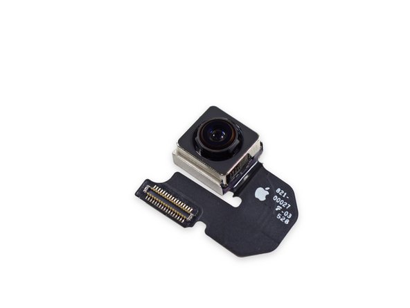

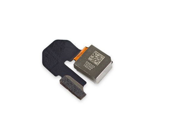

  14. iPhone 6s Teardown: step 15, image 1 of 3 iPhone 6s Teardown: step 15, image 2 of 3 iPhone 6s Teardown: step 15, image 3 of 3
    • Next out, the iPhone's 12 MP peeper!
    • This year's camera offers a substantial spec bump from the 6, including the first resolution increase since the iPhone 4s.
    • 50% more focus pixels means faster, more accurate autofocus without a drop in quality.
    • The new iSight camera also brings the iPhone into the arena of 4K video recording, which has previously been dominated by Android phones.
    • Increased pixel density often comes at the cost of a decrease in individual pixel quality, due to crosstalk from competing photodiodes, but this new iSight camera includes some cool technologies that mitigate that issue.
    • There are electrically insulating trenches etched between the sensor's photodiodes, a process called Deep Trench Isolation, to compensate for leakage between densely-packed pixels.

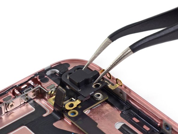

  15. iPhone 6s Teardown: step 16, image 1 of 3 iPhone 6s Teardown: step 16, image 2 of 3 iPhone 6s Teardown: step 16, image 3 of 3
    • And now, for a trip into the Twilight Zone...
    • We find a strange 2.5 mm hex head in the place of the more standard stand-off screw. Add a new tool to your smartphone arsenal...
    • And out comes the Lovecraftian antenna unit seen in previous models.

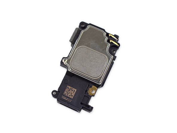

  21. iPhone 6s Teardown: step 22, image 1 of 3 iPhone 6s Teardown: step 22, image 2 of 3 iPhone 6s Teardown: step 22, image 3 of 3

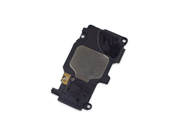

    • Time to pick out the last goodies. The first to drop: the bass speaker.
    • A closer look at the speaker reveals... not much, actually.
    • The 6s speaker appears to be a very close cousin to the speaker from the iPhone 6. We suspect the difference in shape can be attributed to the addition of the Taptic Engine.

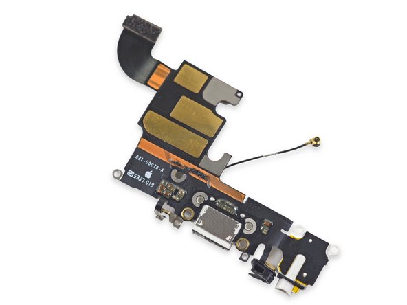

    • And now, the famous "everything cable" (a.k.a. the Lightning cable assembly), featuring not one, but two microphones!
    • Beyond the two microphones, the Lightning cable assembly plays host to an impressive array of components:
    • Lightning port to meet your charging/data transfer needs.
    • Headphone jack for your audio needs.
    • Cell antenna cables for all your cellular needs.
    • While the Lightning cable assembly is a fine example of engineering efficiency, it doesn't bode well for repairs. A single broken component means the whole cable will need to be replaced.

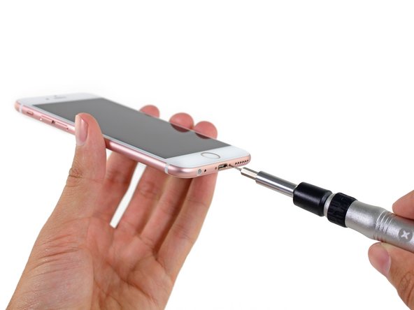

    • The iPhone 6s still uses proprietary Pentalobe screws on the exterior, requiring a specialty screwdriver to remove.
