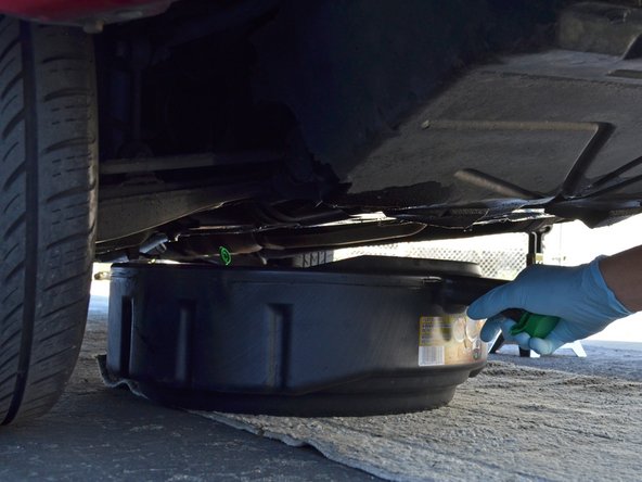

    • Locate the 19 mm hex oil drain plug on the passenger side of the oil pan.
    • Place an oil drain pan underneath the oil drain plug.
    • Be sure that the drain pan is positioned so that it will catch the oil when it is streaming out of the oil pan.

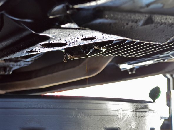

  5. 1990-1997 Mazda Miata Oil Change: step 5, image 1 of 3 1990-1997 Mazda Miata Oil Change: step 5, image 2 of 3 1990-1997 Mazda Miata Oil Change: step 5, image 3 of 3

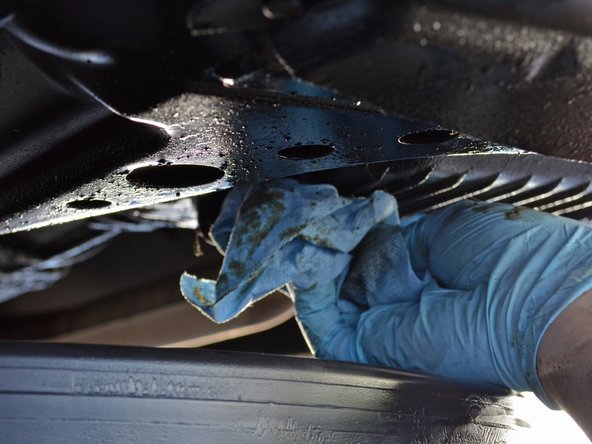

    • Watch the draining oil for shiny specks. Metal flakes in the oil could mean that there is a serious problem with the internals of your engine.
    • Allow oil to drain out of the oil pan until it slows to small drops.
    • Once the draining has slowed significantly, wipe off the area around the oil drain with a rag or towel.
    • Replace the drain plug and hand-tighten it.

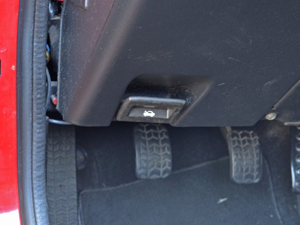

    • Open the driver's side door and locate the hood release lever.
    • Pull the lever until you hear the hood click open.

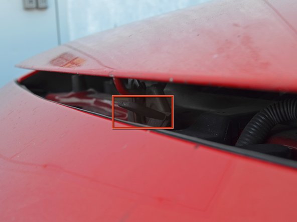

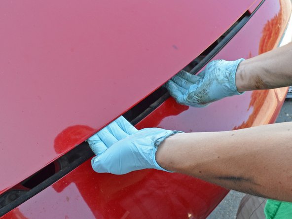

    • Locate the black hood catch lever just to the driver's side of the center of the hood at the front of the car.
    • Lift the lever with one hand while lifting up the hood with the other.

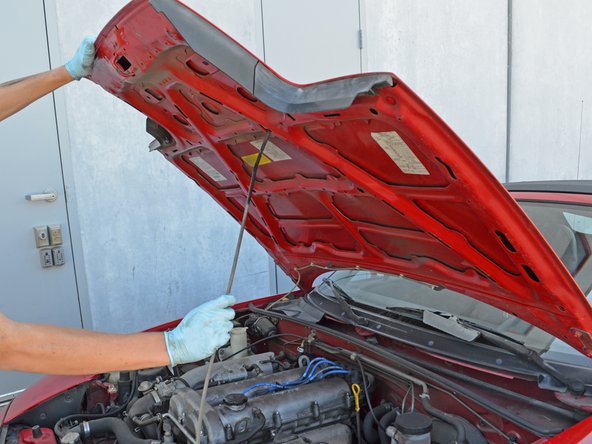

  7. 1990-1997 Mazda Miata Oil Change: step 7, image 1 of 3 1990-1997 Mazda Miata Oil Change: step 7, image 2 of 3 1990-1997 Mazda Miata Oil Change: step 7, image 3 of 3
    • With the hood raised, insert the hood prop into the hole marked "rod" on the inside of the hood.

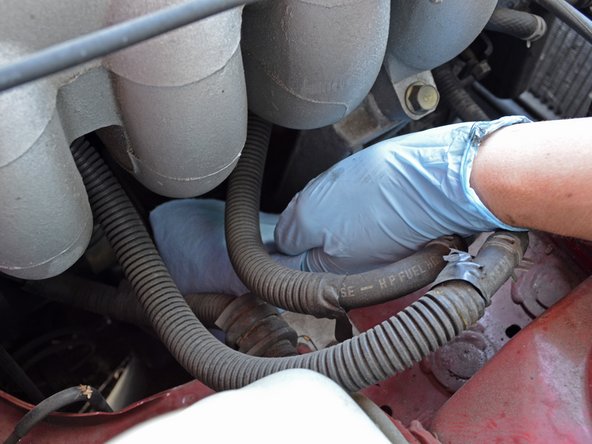

    • The oil filter is a small cylinder, about 2.5" in diameter, located on the right side of the engine underneath the intake manifold.
    • Hold a rag or towel underneath the oil filter and grab the filter with your hand. The rag will be used to catch any leaking oil when removing the filter
    • Loosen the oil filter by twisting it counterclockwise.
    • You may have to use an oil filter wrench if the filter is on too tight. There is very limited space next to the engine, though, so a wrench that fits over the top of the filter is ideal.

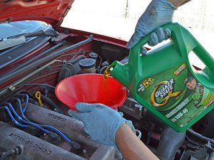

    • Remove the oil filler cap at the front of the engine by twisting it counter-clockwise and then lifting it up.
  15. 1990-1997 Mazda Miata Oil Change: step 15, image 1 of 3 1990-1997 Mazda Miata Oil Change: step 15, image 2 of 3 1990-1997 Mazda Miata Oil Change: step 15, image 3 of 3
    • Place a large funnel into the oil filler hole in the top of the valve cover.
    • Pour 3.8 quarts of oil into the funnel.
    • If you're using one of those 5 liter (5.3 quart) "oil change" jugs, we've got the math covered. Pouring 3.8 quarts out will leave you with about 1.5 quarts.
