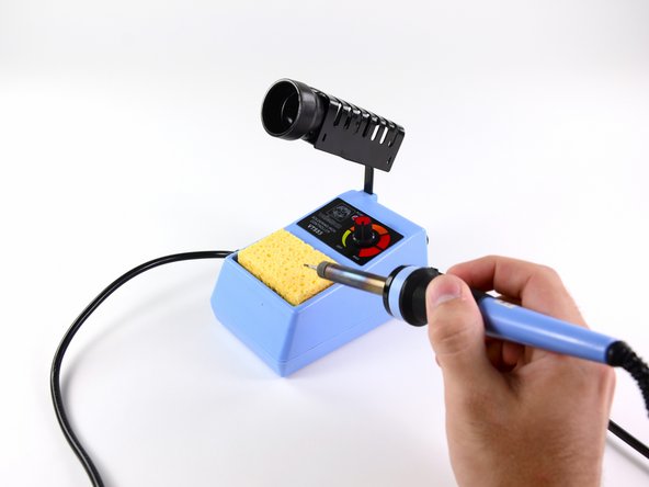

  2. Electronics Skills Kit 101: step 2, image 1 of 2 Electronics Skills Kit 101: step 2, image 2 of 2

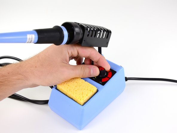

    • The most important tool for any soldering job? Your soldering iron, of course! For this procedure we'll be using the soldering station that we sell in our parts and tools store.
    • For this project, you won't want your soldering iron to exceed 40 watts at the tip. For our station which draws 50 watts of power from the wall, it is safe to crank it up all the way to max.
    • If this is the first time you're firing up your soldering iron, you may notice some smoke and a not-so-pleasant scent. Don't worry; this is just the coating on the tip burning off. Wait a couple minutes for the soldering iron to stop smoking.

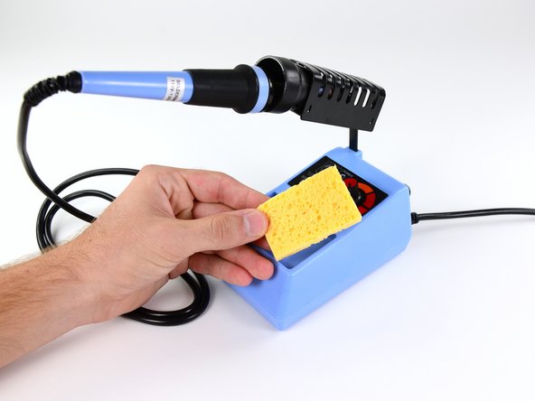

    • Before you start soldering, be sure to dampen your cleaning sponge. A dry sponge will just get burned.
    • It is always a good precaution to wear safety goggles while soldering. Hot pieces of solder occasionally shoot off and a scorching piece of metal to the eye will ruin even the greatest optimist's day.

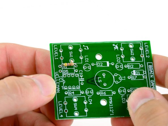

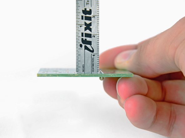

  3. Electronics Skills Kit 101: step 3, image 1 of 3 Electronics Skills Kit 101: step 3, image 2 of 3 Electronics Skills Kit 101: step 3, image 3 of 3
    • We'll start with resistor R1 in your kit, which has yellow, purple, brown, and gold rings on it (more on what these colored rings mean later).
    • Bend the leads of the resistor to 90o angles about 1.5 mm away from the body of the resistor.
  4. Electronics Skills Kit 101: step 4, image 1 of 2 Electronics Skills Kit 101: step 4, image 2 of 2

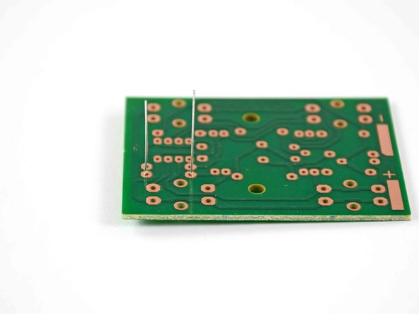

    • Place the leads of the resistor through the holes on either side of the rectangle marked R1 on the circuit board.
    • Resistors do not have to be installed in a particular orientation. Either lead can go into either hole.

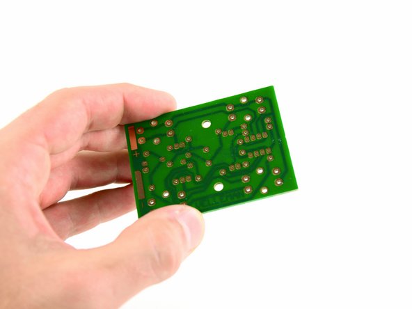

    • Turn the board over so that the copper traces are facing up and the resistor leads are pointing straight up in the air, as seen in the second picture.
    • You may also bend the leads outward to hold the resistor in place, but this is not necessary. As per NASA guidelines, any angle up to 30° down from vertical is acceptable.

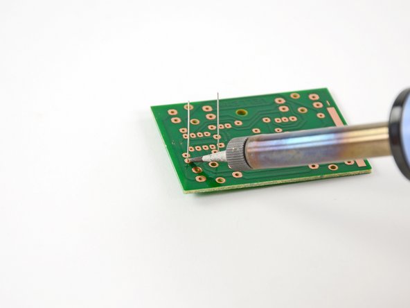

  5. Electronics Skills Kit 101: step 5, image 1 of 3 Electronics Skills Kit 101: step 5, image 2 of 3 Electronics Skills Kit 101: step 5, image 3 of 3
    • You must be itching to throw down some molten metal by now; however, you still need to prepare the tip of your soldering iron.
    • Now that your soldering iron's tip is hot, clean it by melting a small amount of solder directly on the tip and wiping it off on your damp sponge.
    • Melt another small ball of solder onto the tip of the soldering iron, but do not wipe it off. This is called "tinning" the iron, and will improve heat conductivity, allowing you to solder more quickly and efficiently.
    • Regular cleaning and tinning of your soldering iron while working will lead to better solder joints and longer tip life.

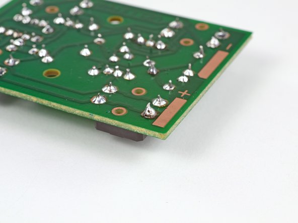

  6. Electronics Skills Kit 101: step 6, image 1 of 3 Electronics Skills Kit 101: step 6, image 2 of 3 Electronics Skills Kit 101: step 6, image 3 of 3

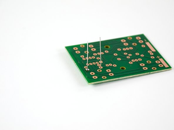

    • Here we are: the moment of truth. It's time to get that solder flowing.
    • Set the tip of the soldering iron on the two parts to be connected. In this case, that's the resistor lead and the copper trace on the circuit board.
    • Touch your solder to the tip of your soldering iron to melt it onto the joint. Don't hold it there for more than a second or two.
    • Quickly, but not frantically, pull both the soldering iron and the solder away from the joint.
    • Your solder joint should be shiny and conical, and not expand beyond the copper trace.

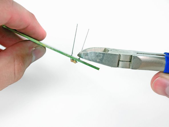

    • Use the same method above to solder the second resistor lead to the circuit board.
    • After soldering a joint, if you are going to put the soldering iron down, be sure to place it back in its stand to prevent burning yourself or anything around you.
    • Cut the extra lengths of the resistor leads with a pair of wire cutters. NASA workmanship standards state that any length up to 2.29 mm is acceptable.

    • Use a pair of wire cutters to remove about an inch of the positive terminal surface mount lead.
    • Bend the lead around and through the positive ring terminal on the battery compartment.
    • Use your now perfected through-hole soldering skills to solder the lead to the battery terminal.
    • Cut off any excess lead.
