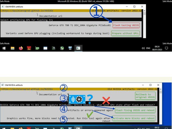

  3. Fix visual artifacts/code 43 for NVIDIA GTX470-780 by programmatically disabling bad parts, Flash VBIOS several times: step 3, image 1 of 1
    • 1. Perform a first VBIOS flash: select the problematic GPU and press "Flash testing VBIOS" near it.
    • After flashing is done, press "Reboot"
    • 2. Run the software again. If the graphics driver starts up fine, press the "Activate more blocks and reboot" button at the bottom. Otherwise, press the "Flash fixing VBIOS and reboot" button. The software will try another VBIOS variant
    • 3. 4. 5. Rerun the tool after rebooting up to 3 times to let the utility select the best VBIOS
  4. Fix visual artifacts/code 43 for NVIDIA GTX470-780 by programmatically disabling bad parts, Finalizing: step 4, image 1 of 1
    • After a successful modification, a pair of memory chips are disabled. Fixed GPU works fine in any computer
    • If the utility fails to fix the GPU, use the "Rollback to original VBIOS" button
