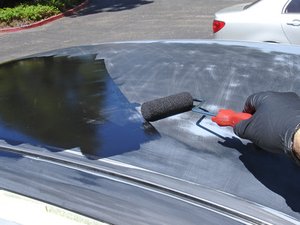

  4. Hand Painting a Car: step 4, image 1 of 3 Hand Painting a Car: step 4, image 2 of 3 Hand Painting a Car: step 4, image 3 of 3
    • Make a mixture of 50% Rustoleum paint, and 50% mineral spirits. The paint will be very, very thin.
    • If you over-apply the paint, it will run down the sides! Over-applying the paint will negate all the hard work you put into prepping the car for painting. If it happens, use a rag doused with pure mineral spirits to wipe off the runs.
    • Apply several thin coats of paint onto the car. Wait approximately 30 minutes between each coat to allow the paint to partially dry.
    • You will probably have to apply at least five thin coats of paint before the body (especially the Bondo areas) are no longer visible. Don't rush, and don't over-apply the paint.

WOW I can't believe you rolled it after you did all that work to sand and mask off everything. How did it come out? You must have done a lot of 600 to smooth it all out. Do yourself a favor, go to Harbor Freight, get a spray gun and compressor. People Please don't use a brush!!! roller is much better but will leave bumps.
JonnyGood - Reply
It worked fine for me, @%^$$@$.
neilriggers -
If memory serves, the optimum pressure for a spray gun is about 25 psi and the optimum distance is a foot (300mm) and when doing so, you need to DIRECT spray the panel, which isn't necessarily easy with all the angles etc. For the top coat, I found using a wide fan spray to be best, which resulted in the least number of imperfections, but you need to remember, your local environment WILL affect it, a dust free spray room is obviously the best, but thats not always available
