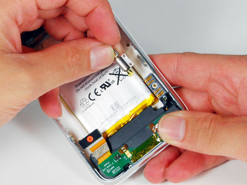

    • Remove the two Phillips #00 screws securing the vibrator to the rear panel.
    • These screws are smaller diameter than all the others. Make sure you don't mix them up with the other screws. On reassembly, only these two screws will fit.
  18. iPhone 3GS Vibrator Replacement: step 18, image 1 of 1
    • Lift the vibrator up and out of the iPhone.
