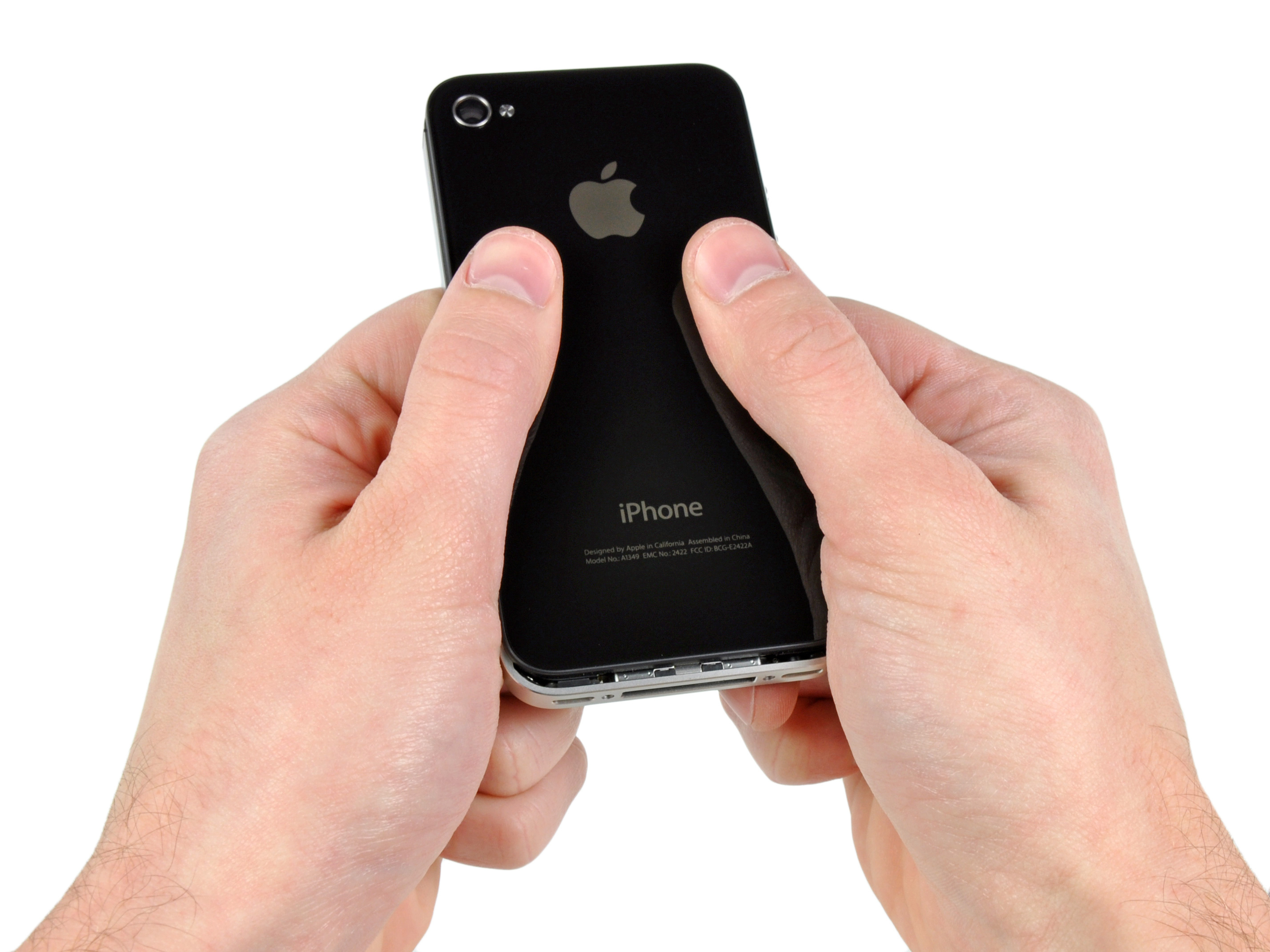

Remove the rear panel to access the internal components of your iPhone.
Power off your iPhone before beginning disassembly.
Remove the two 3.6 mm Pentalobe P2 screws next to the dock connector.

If you have trouble removing the back after sliding it, do not force or pry it. You didn't push it far enough. Gently push it further and it will come off easily!
On the iPhone 4S Mirrored Rear Panel there was a clear plastic covering on the INSIDE side of the Panel that covers a jagged black area. There is also a small plastic covering over the camera lens, also on the inside side of the Panel. The iFixIt step-by-step instructions do not include any information about whether to remove these or leave them. I chose to peel them off and it appears everything works okay. But there probably should have been a mention about what to do with these "stickers."
Thanks! I didn't notice the scuff covers until we noticed the poor quality of the photos. After I took the back off and removed the film covers, the photos are back to the original quality. Thanks again for your comment. The covers should have an obvious tab on them for easy removal
