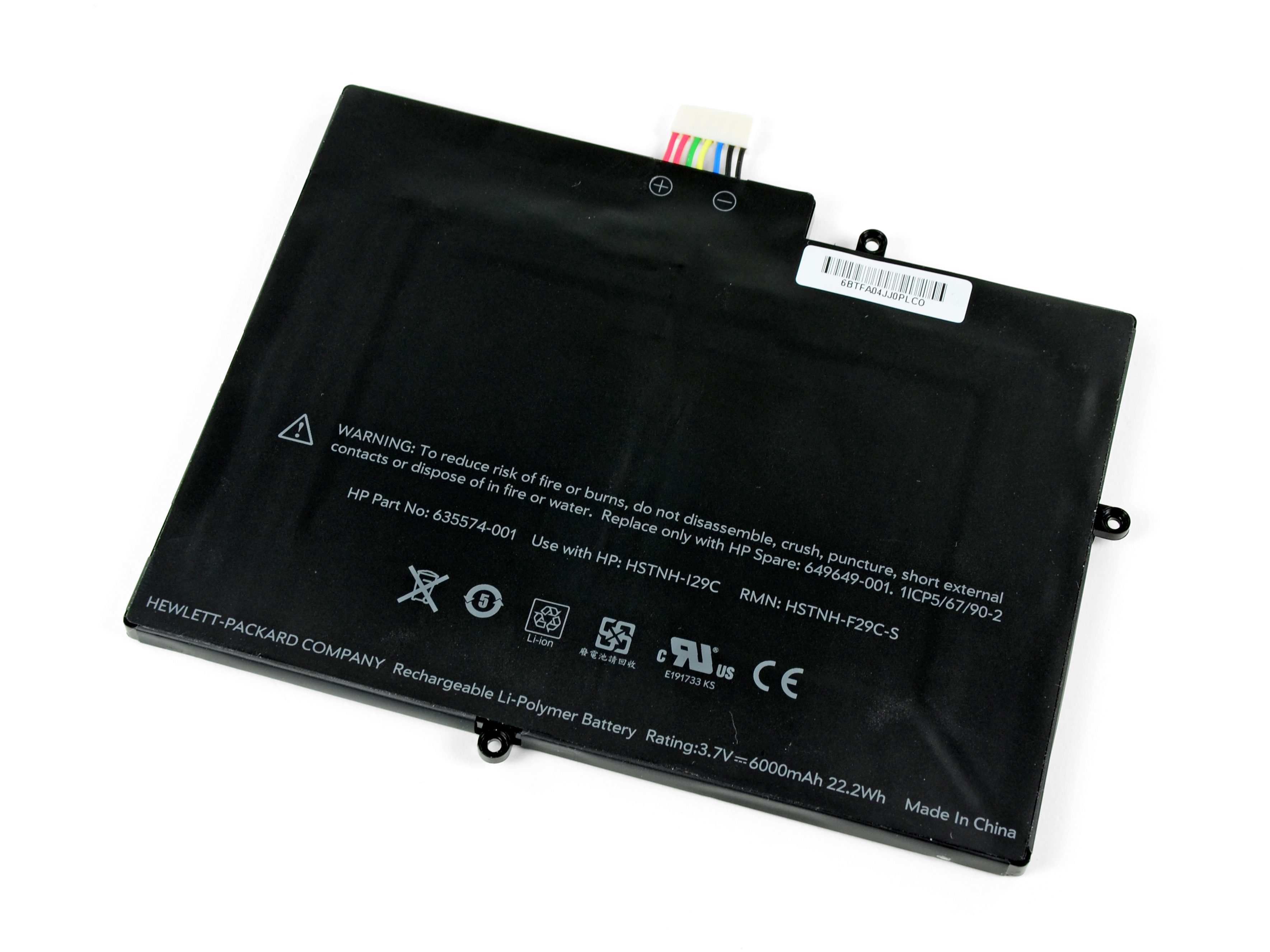

Use this guide to replace a worn-out battery.
In the following steps, you will use a metal spudger to lift the front panel out from the rear case of your TouchPad.
Use the edge of a plastic opening tool to peel up the two pieces of copper tape covering the USB connector board near the battery and the motherboard.
Pull the vibrator motor connector straight away from its socket on the USB connector board.
Remove the USB connector board from the TouchPad.
NOTE: First verify that there is a connector before pulling! The vibrator motor may be soldered directly to the USB Board requiring the motor to be pried up and removed together with the board.
