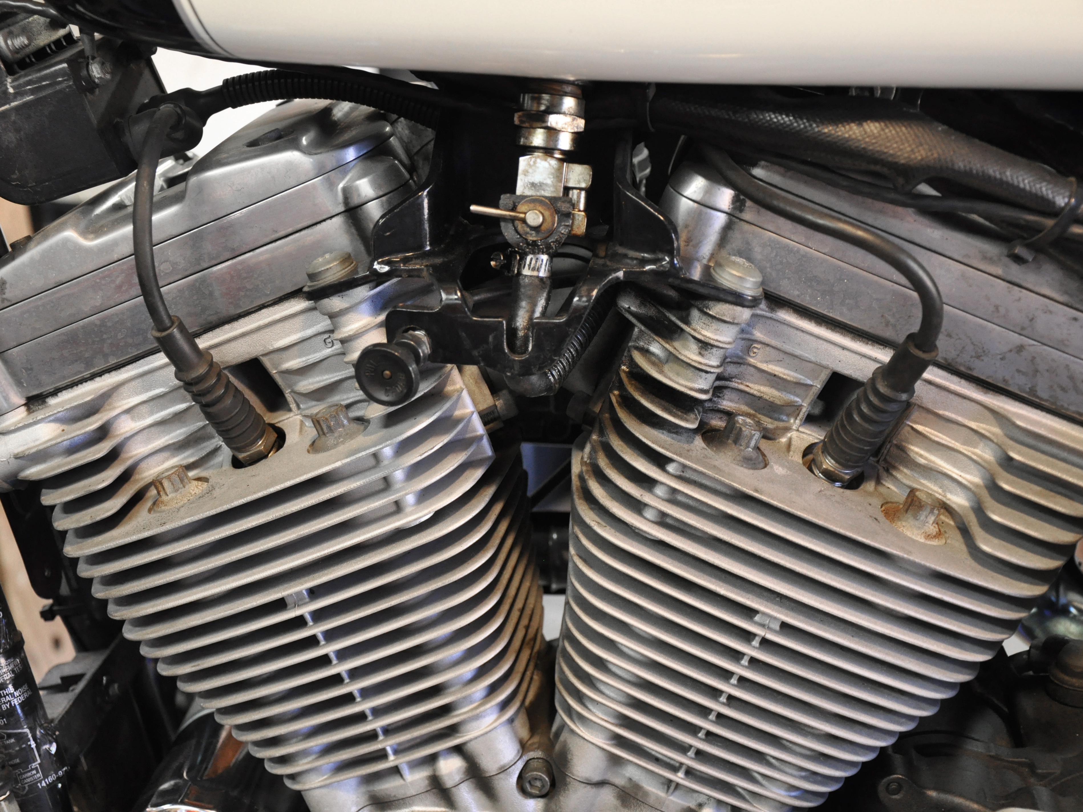

Harley-Davidson Sportster Evolution Spark Plugs Replacement
  1. Harley-Davidson Sportster Evolution Spark Plugs Replacement, Spark Plugs: step 1, image 1 of 1
    • The spark plugs are easy to spot on the left side of the motorcycle.
    • The procedure for removing the spark plugs is the same for both the front and back cylinder, and either spark plug can be replaced first. This guide will show how to remove and install the spark plug in the rear cylinder.

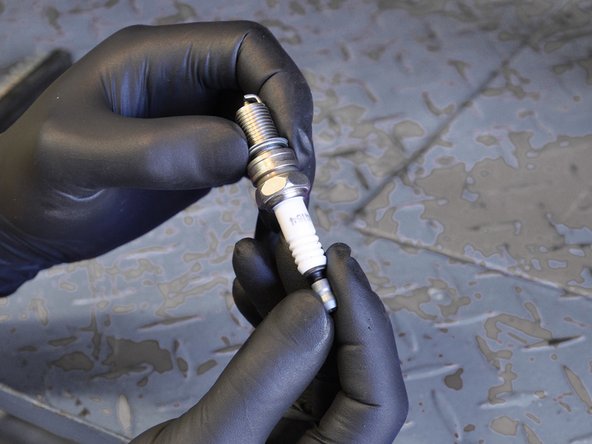

  4. Harley-Davidson Sportster Evolution Spark Plugs Replacement, Checking the new spark plug: step 4, image 1 of 3 Harley-Davidson Sportster Evolution Spark Plugs Replacement, Checking the new spark plug: step 4, image 2 of 3 Harley-Davidson Sportster Evolution Spark Plugs Replacement, Checking the new spark plug: step 4, image 3 of 3
    • Always inspect your new spark plugs before installing. Check the gap on your replacement spark plugs with a feeler gauge. It should be set to .040 inches (1.016mm).
    • If they are not pre-installed, make sure that the crush washer and terminal nut are installed.
