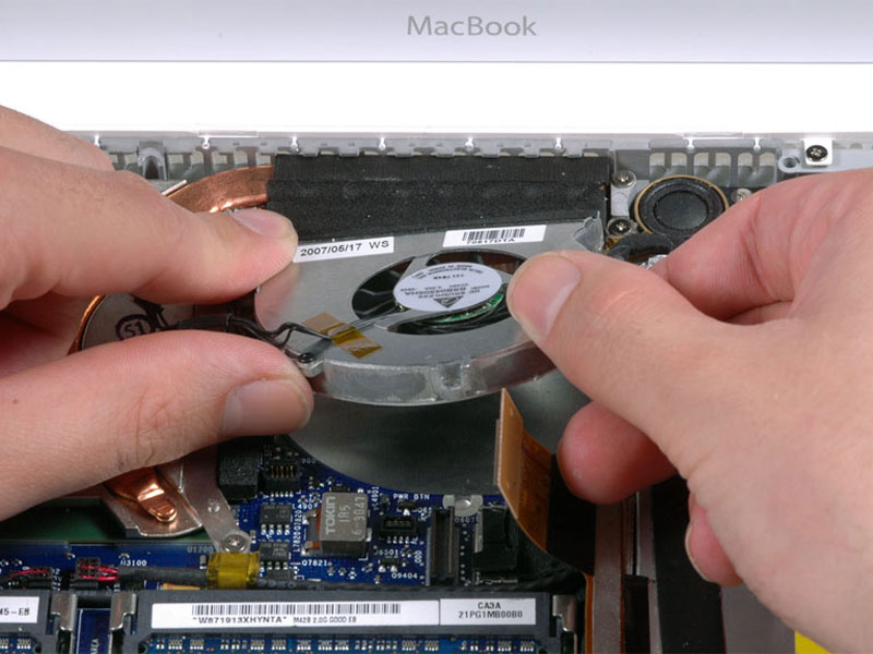

  19. MacBook Core 2 Duo Fan Replacement: step 19, image 1 of 1
    • Lift the fan and its attached mounting bracket up and out of the computer, being careful not to rip the black felt tape.

My wife's MacBook has been overheating for some time, and then shutting itself down. Your instructions were great, but I did note that I needed to unscrew the cable tie near the speaker in Step 17.
The system had some dust in it, used the air can to spray it all out. Dust was on the heatsink vents, too. Closed it all up, and peak temps during a software install that crashed it three times yesterday was 145F - yesterday it was passing 170F and crashing.
Thanks for the instructions, ifixit!
