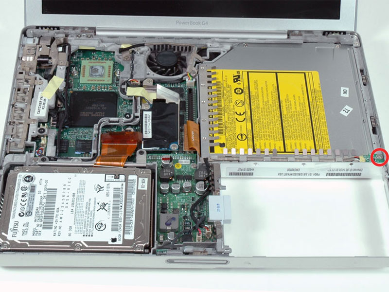

  22. PowerBook G4 Aluminum 12" 1-1.5 GHz Fan Replacement, Fan: step 22, image 1 of 1
    • Remove the single Phillips screw securing the hall effect sensor board to the optical drive.
