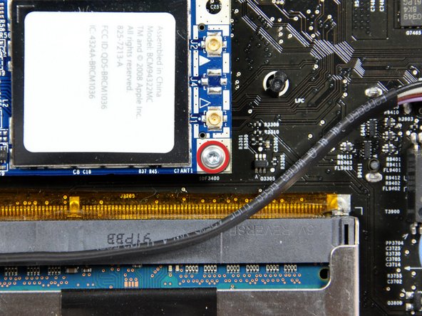

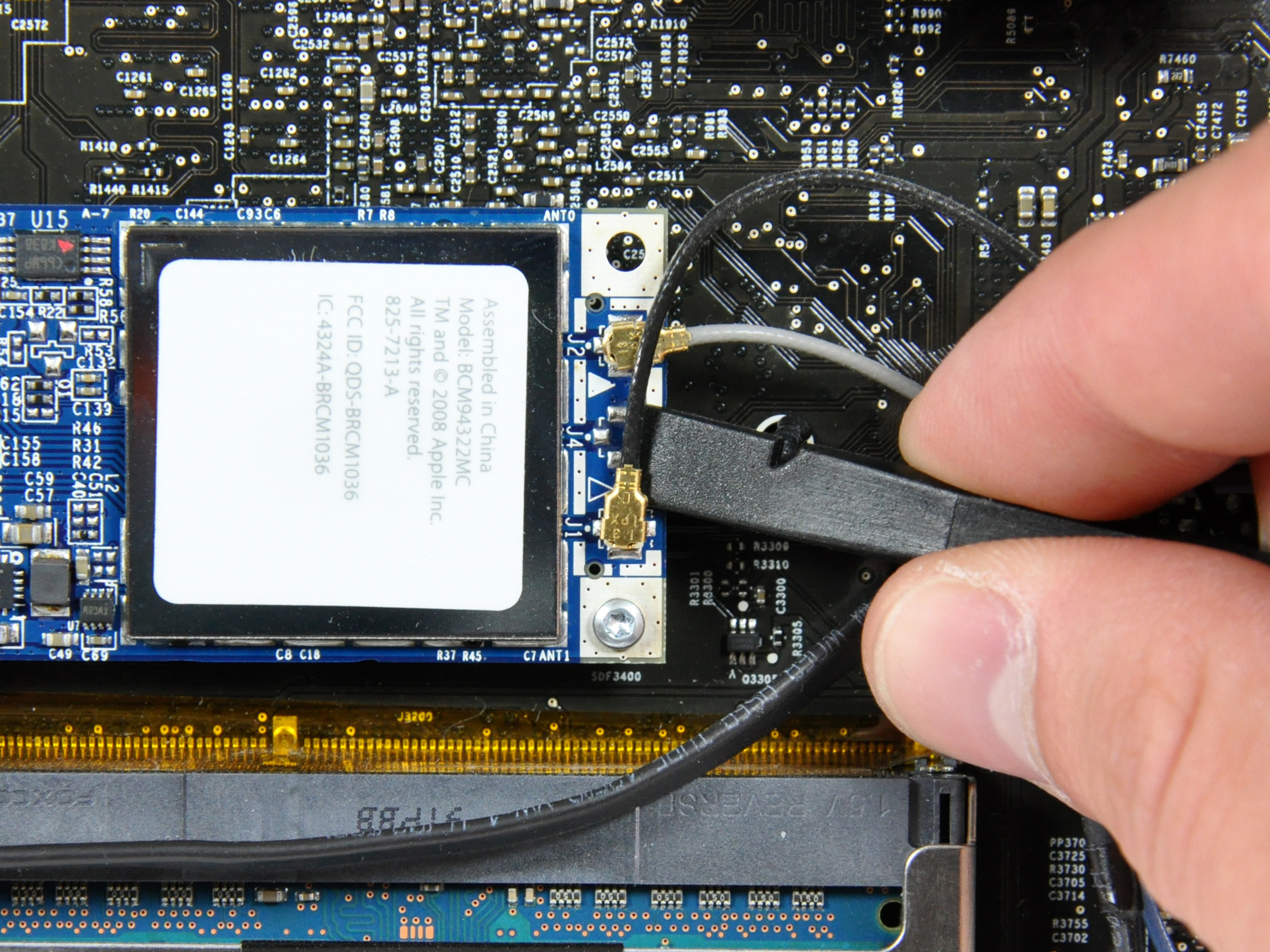

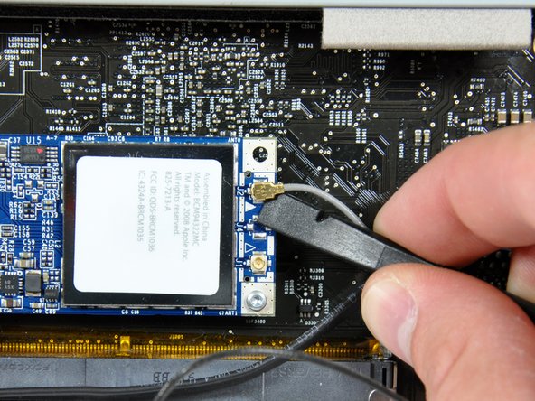

Use the flat end of a spudger to pry both antenna connectors up off the AirPort Extreme card.
