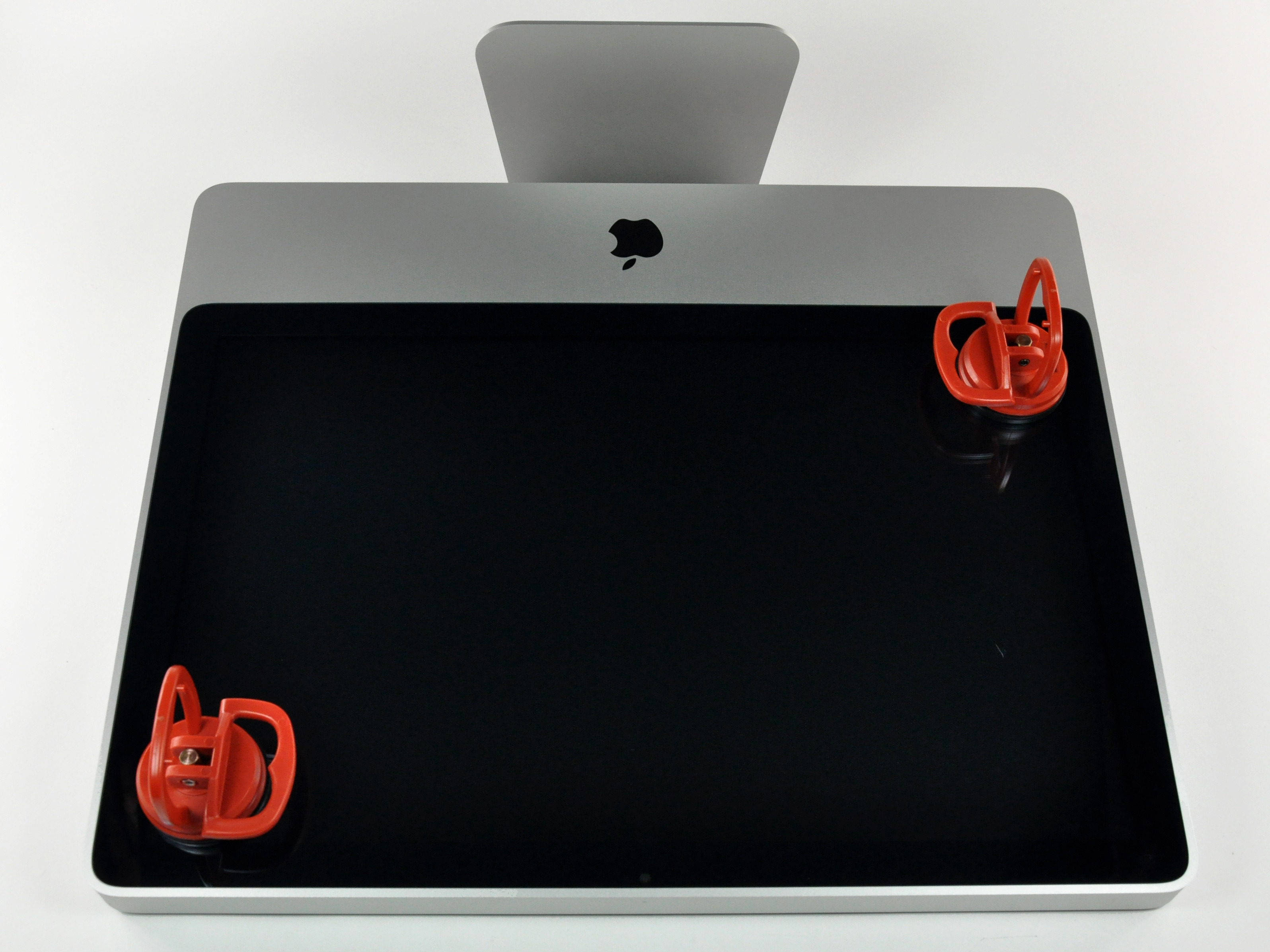

    • The glass panel is fixed onto the front bezel with fourteen magnets around its perimeter.
    • Stick two suction cups to opposing corners of the glass panel.
    • To attach the suction cups we sell, first position the suction cup with the movable handle parallel to the face of the glass panel. While lightly holding the suction cup against the glass, raise the movable handle until it is parallel with the other handle.
    • If your suction cups refuse to stick, try cleaning both the glass panel and the suction cup with a mild solvent.
  2. iMac Intel 20" EMC 2266 Glass Panel Replacement: step 2, image 1 of 1
    • Gently pull the glass panel straight up off the iMac.
    • The glass panel has several positioning pins around its perimeter. To avoid shearing these pins off the glass panel, be sure to only pull straight up during removal.
    • Be meticulous about cleaning the LCD and the inside face of the glass panel before reinstallation, as any fingerprints or dust trapped inside will be annoyingly visible when the display is on.
    • When replacing the glass, be sure there's nothing between the glass and the frame. Stray cables could be damaged or crack the glass.
