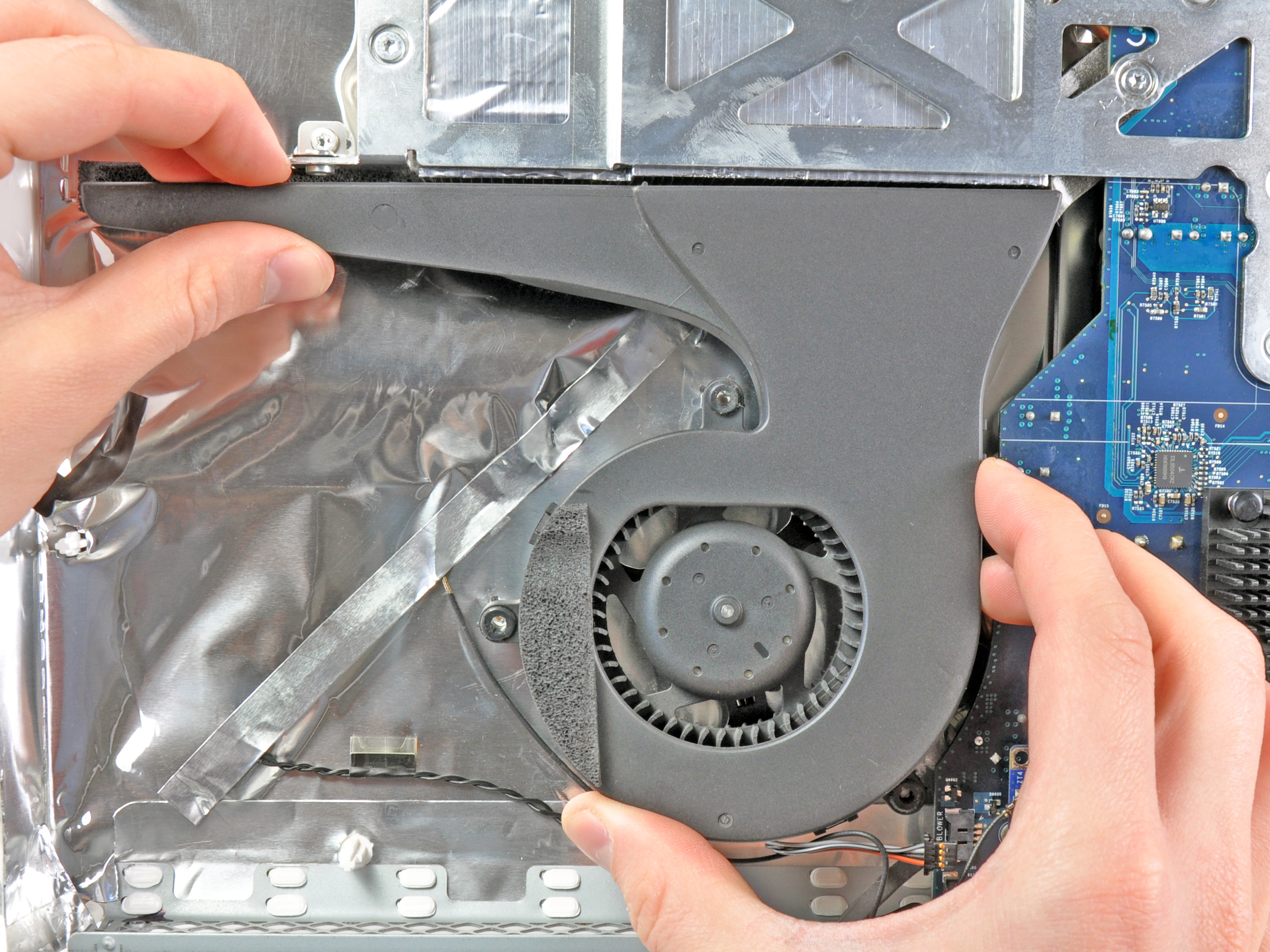

iMac Intel 24" EMC 2111 CPU Fan Replacement
Introduction
Go to step 1Use this guide to replace the large fan that cools the CPU and GPU heat sinks.
Loosen the two Phillips screws securing the access door to your iMac.
Remove the access door.
Remove the following screws along the lower edge of your iMac:
Three 6 mm T8 Torx screws
One 8 mm T8 Torx screw
To lift the front bezel off the iMac, simultaneously:
Use your thumbs to press in the RAM arms and hold the iMac down.
Use your index fingers to pull the small bridge of material on the front bezel toward yourself.
Pull the front bezel up with your index fingers.
Once the small bridge of material has cleared the RAM arms, lift the front bezel by its lower edge just enough to clear the bottom edge of the rear case.
Peel back the piece of EMI tape covering the bottom edge of the left speaker.
Also peel back the tape stuck to the curved side of the left speaker.
