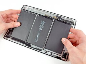

iPad 2 Wi-Fi EMC 2415 Battery Replacement
  1. iPad 2 Wi-Fi EMC 2415 Battery Replacement, iOpener Heating: step 1, image 1 of 2 iPad 2 Wi-Fi EMC 2415 Battery Replacement, iOpener Heating: step 1, image 2 of 2

    • Holding the iPad by the top and bottom right corners, rotate the front glass away from the iPad.
    • Be careful of any adhesive that may still be attached, and use an opening pick to cut any adhesive that may still be holding the front panel down.
    • During reassembly use a microfiber cloth and compressed air to clean any dust or fingerprints off the LCD before reinstalling the glass.
  28. iPad 2 Wi-Fi EMC 2415 Battery Replacement, LCD: step 28, image 1 of 1
    • Remove the four 2.0 mm Phillips screws securing the LCD to the rear case.
  29. iPad 2 Wi-Fi EMC 2415 Battery Replacement: step 29, image 1 of 2 iPad 2 Wi-Fi EMC 2415 Battery Replacement: step 29, image 2 of 2
    • The front panel ribbon cables are connected beneath the LCD. To access them, you'll need to temporarily flip the LCD over and out of the way.
    • Be very careful when moving the LCD, and do not attempt to remove it from the iPad—its display data cable will remain connected while it is rotated over.
    • Lift the LCD from its long edge closest to the volume buttons and gently flip it out of the rear case—like turning the page in a book.
    • Set the LCD face down on the front panel.

  47. iPad 2 Wi-Fi EMC 2415 Battery Replacement, Battery: step 47, image 1 of 3 iPad 2 Wi-Fi EMC 2415 Battery Replacement, Battery: step 47, image 2 of 3 iPad 2 Wi-Fi EMC 2415 Battery Replacement, Battery: step 47, image 3 of 3
    • Reheat the iOpener in the microwave for one minute.
    • Remember to be careful not to overheat the iOpener during the repair procedure. Wait at least two minutes before reheating the iOpener, and never microwave it for more than one minute.
    • Place the heated iOpener on the back of the iPad just right of center (the side opposite the rear facing camera). Let it sit there for 90 seconds to soften the battery adhesive.
    • Move the iOpener to the center of the back of the iPad and let the iOpener sit for another 90 seconds.
    • If the iOpener cools significantly between sittings, reheat it for another minute.
    • Move the iOpener to the left edge (the side with the rear facing camera) of the back of the iPad and let the iOpener sit for another 90 seconds.
  48. iPad 2 Wi-Fi EMC 2415 Battery Replacement: step 48, image 1 of 2 iPad 2 Wi-Fi EMC 2415 Battery Replacement: step 48, image 2 of 2
    • Starting with the battery cell closest to the dock connector, run a plastic opening tool underneath the edge of the battery closest to the logic board void to make enough room to insert the flat end of a spudger
    • Run the flat end of a spudger along the two long sides of each battery cell to completely separate them from the adhesive securing them to the rear case.
    • If the adhesive is very difficult to separate, reheat the rear panel and try again.
  49. iPad 2 Wi-Fi EMC 2415 Battery Replacement: step 49, image 1 of 1
    • Before prying up the middle battery cell, use the edge of a plastic opening tool to lift the battery connector board away from the rear panel.
    • Do not excessively bend the battery connector board. Be especially careful when prying up around the screw post on the aluminum rear case.
  50. iPad 2 Wi-Fi EMC 2415 Battery Replacement: step 50, image 1 of 1
    • Next use your spudger to separate the adhesive along the long sides of the middle battery cell.
    • Repeat the process for the final battery cell, reheating the case if necessary.
  51. iPad 2 Wi-Fi EMC 2415 Battery Replacement: step 51, image 1 of 1
    • Carefully lift the battery out of the rear panel and remove it from the iPad 2.
