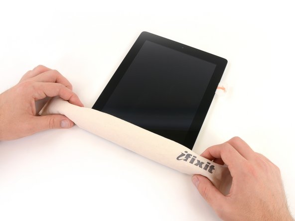

    • Again, as you may find yourself working with broken glass during this procedure, we strongly recommend wearing safety glasses for protection from flying shards.
    • Lay the iOpener flat on the right edge of the iPad, smoothing it out so that there is good contact between the surface of the iPad and the iOpener.
    • Let the bag sit on the iPad for approximately 90 seconds before attempting to open the front panel.
