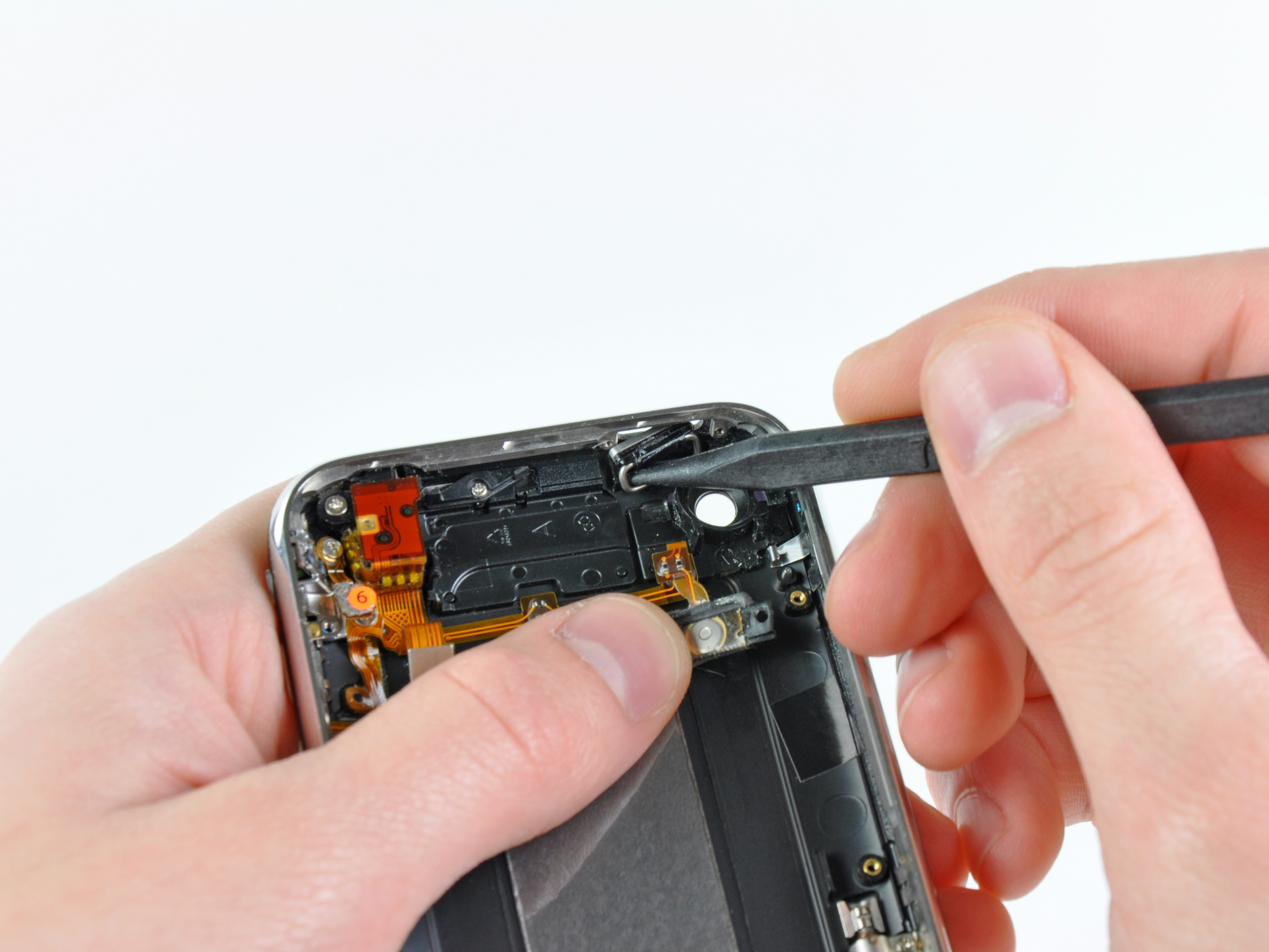

Use a spudger to pry the battery up from the rear case. The battery is attached with an adhesive strip around the perimeter of the battery.
Remove the two Phillips #00 screws securing the on/off switch to the front bezel.
