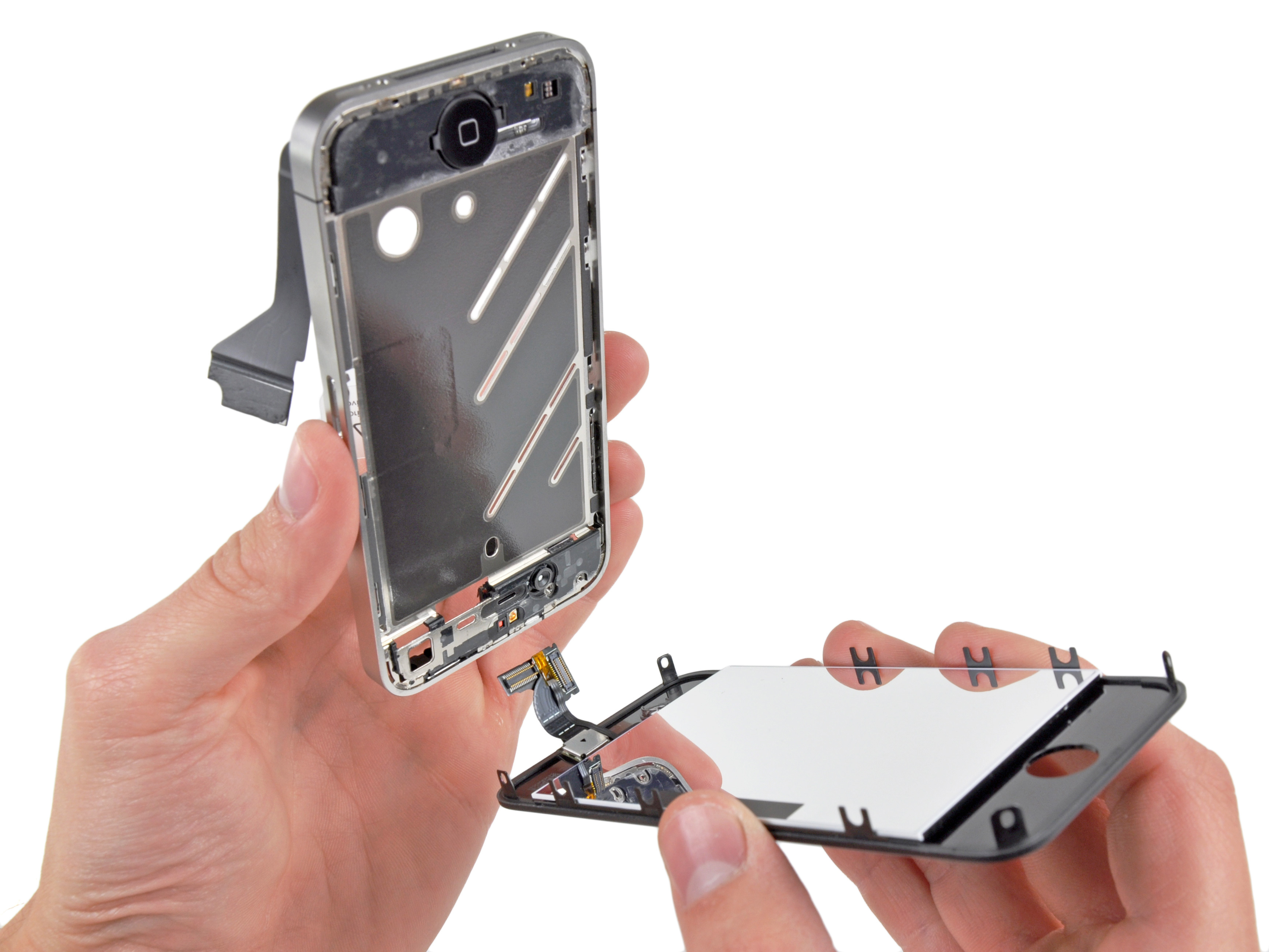

Slowly and gently lift the top edge of the front panel assembly away from the steel inner frame.
Continue to rotate the front panel assembly away from the steel inner frame until it slowly begins to peel off the adhesive applied below the home button area.
It may be easiest to insert a spudger at the top and work it around the edges, spreading gently as you go.
Carefully pull the lower edge of the front panel assembly away from the steel inner frame.
De-route the digitizer and LCD cables through the steel inner frame, and remove the display from the iPhone.
When the front panel has been correctly installed, both the LCD and digitizer cables should be immediately next to one another and should be the same length, as shown in the second photo.
During reassembly, do not touch the metallic area at the base of the LCD data cable, as this can cause problems with the LCD. If you do touch it accidentally, clean it gently with an alcohol wipe before continuing.
