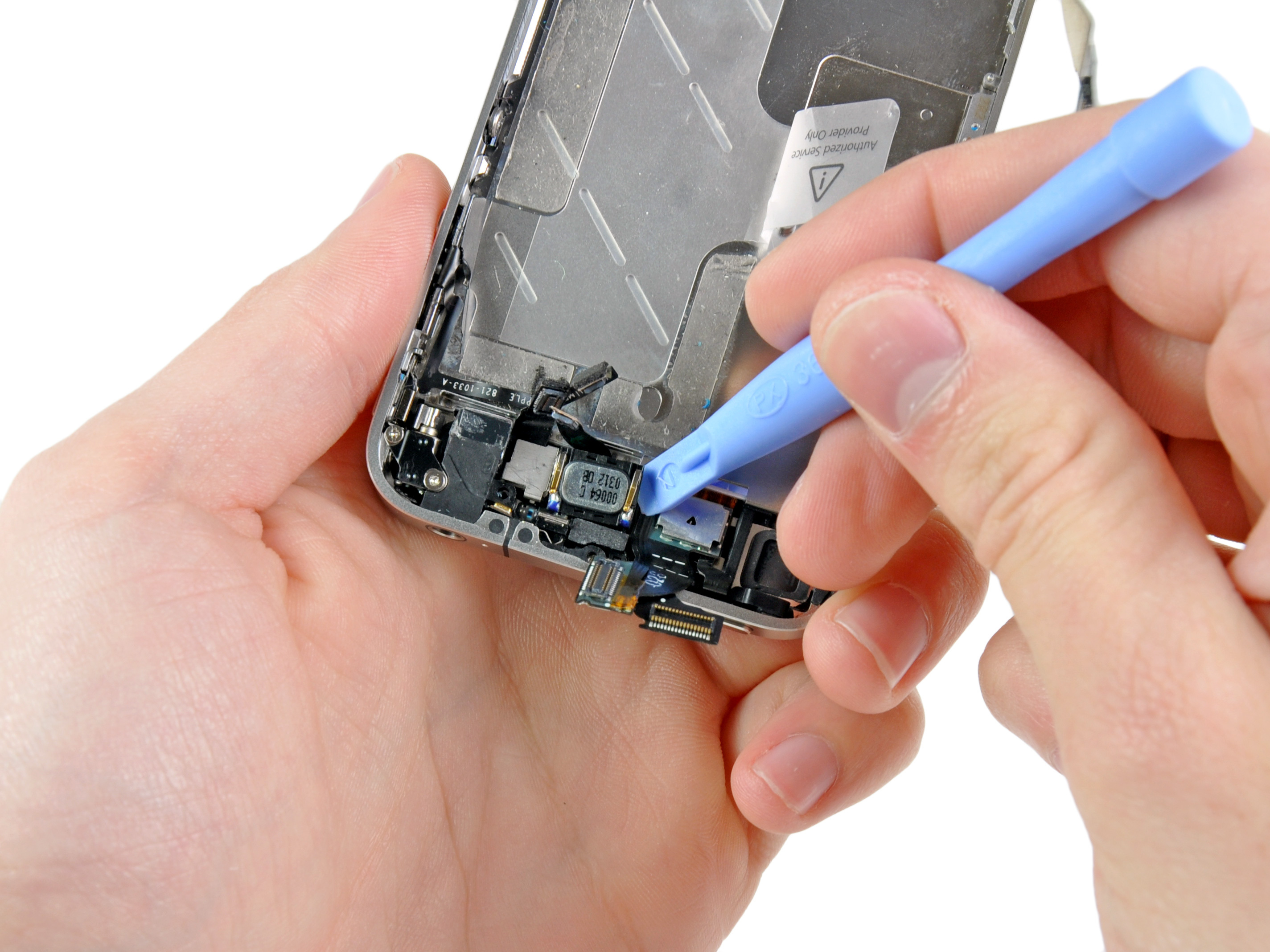

  11. iPhone 4 Earpiece Speaker Replacement: step 11, image 1 of 1
    • Use a plastic opening tool to pry the lower antenna connector up off its socket on the logic board.
