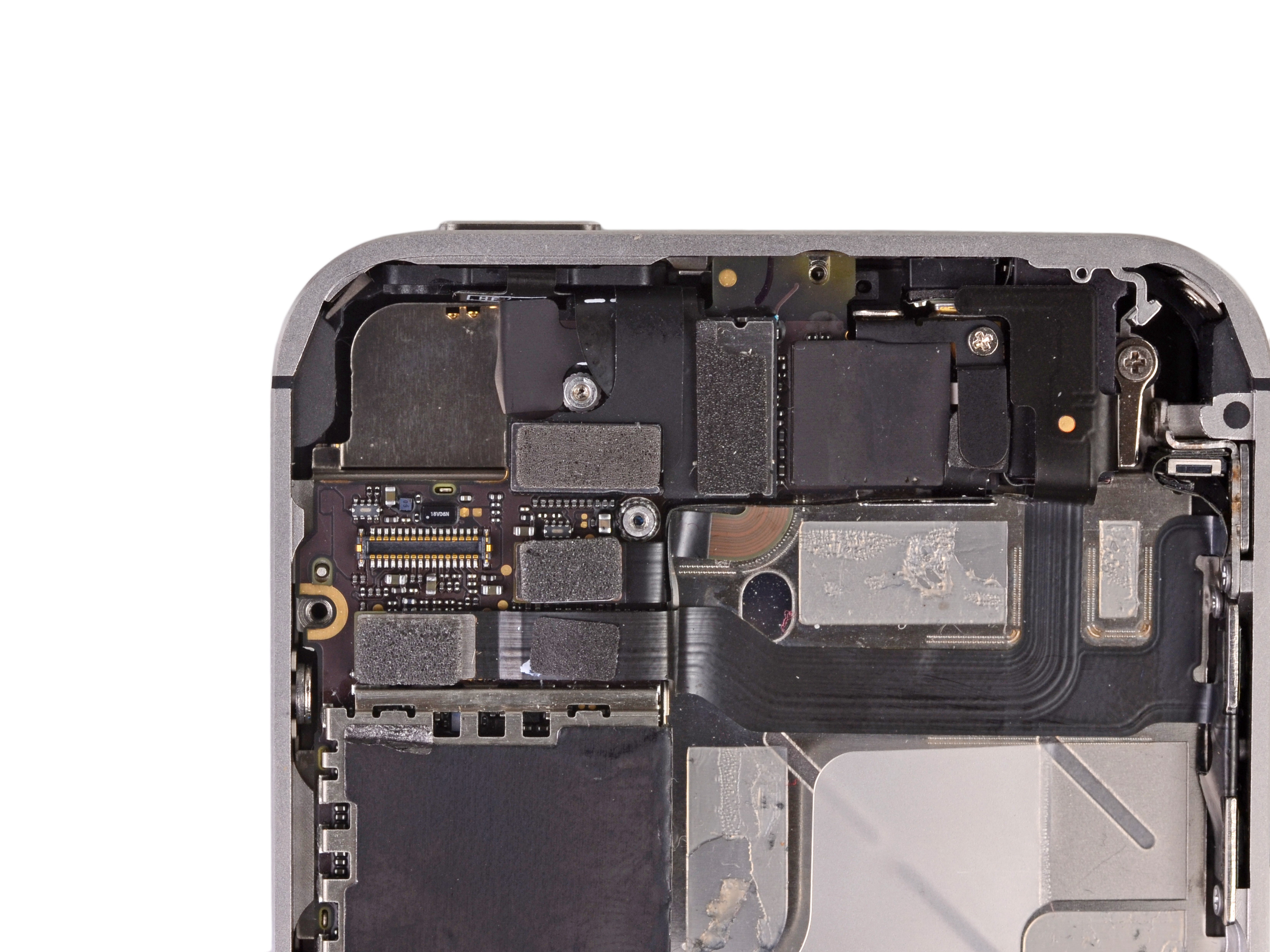

  19. iPhone 4S Logic Board Replacement, Logic Board: step 19, image 1 of 2 iPhone 4S Logic Board Replacement, Logic Board: step 19, image 2 of 2
    • Remove the five cables near the top of the logic board in the following order:
    • Headphone jack/volume button cable
    • Front facing camera cable
    • Digitizer cable
    • Display data cable
    • Power button cable (located underneath the headphone jack/volume button cable as shown in the second picture.)
    • To disconnect the cables, use the edge of a plastic opening tool to gently lift their connectors up and out of the sockets on the logic board.
    • Be careful not to break any of the small and delicate surface mount components as you disconnect the cables.
  20. iPhone 4S Logic Board Replacement: step 20, image 1 of 1
    • Remove the 1.5 mm Phillips screw securing the grounding clip to the logic board near the headphone jack.
  21. iPhone 4S Logic Board Replacement: step 21, image 1 of 2 iPhone 4S Logic Board Replacement: step 21, image 2 of 2
    • Use the tip of a spudger to pry the small grounding clip up off the logic board.
    • Carefully grasp the grounding clip and remove it from the iPhone.
    • Before reassembly, be sure to clean all metal-to-metal contact points on the grounding clip (not the mating halves of connectors) with a de-greaser such as windex or isopropyl alcohol. The oils on your fingers have the potential to cause grounding issues.
  22. iPhone 4S Logic Board Replacement: step 22, image 1 of 1
    Tool used on this step:
    Standoff Screwdriver for iPhones
    $5.49
    Buy
    • Remove the 4.8 mm standoff screw near the headphone jack.
    • Standoff screws are best removed using a standoff screwdriver or bit.
    • In a pinch, a small flathead screwdriver will do the job—but use extra caution to ensure it doesn't slip and damage surrounding components.
