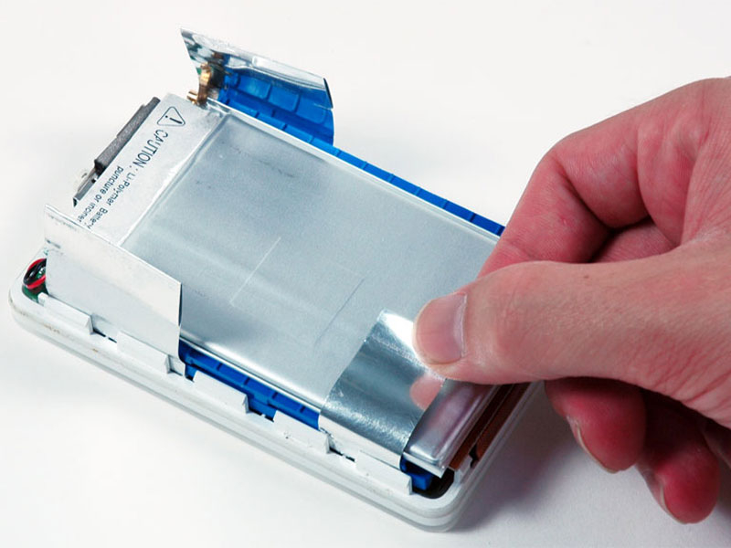

  7. iPod 2nd Generation Hard Drive Replacement, Hard Drive: step 7, image 1 of 1
    • Peel up the metallic tape attached to the top of the battery.
  8. iPod 2nd Generation Hard Drive Replacement: step 8, image 1 of 1
    • Lift the battery up from the hard drive and lay it next the the iPod (it is still connected to the logic board).
  9. iPod 2nd Generation Hard Drive Replacement: step 9, image 1 of 1
    • Carefully disconnect the orange ribbon cable from the hard drive.
    • If the cable doesn't come free easily, it may be helpful to gently wiggle the cable from side to side.
    • Lift the hard drive out of the iPod.
