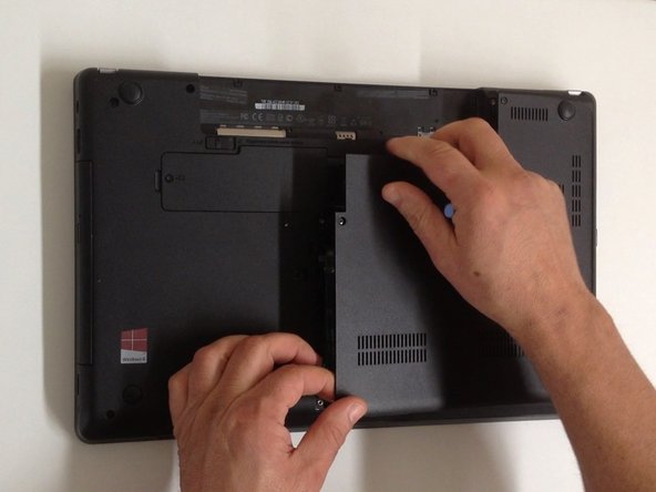

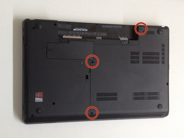

  1. Lenovo ThinkPad Edge E530 HDD Replacement, HDD Cover: step 1, image 1 of 3 Lenovo ThinkPad Edge E530 HDD Replacement, HDD Cover: step 1, image 2 of 3 Lenovo ThinkPad Edge E530 HDD Replacement, HDD Cover: step 1, image 3 of 3
    • Switch-off the Laptop and remove the battery.
    • The HDD/Memory Cover is held by 3x Phillips screws. Remove them.
    • Remove the Cover.

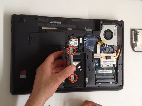

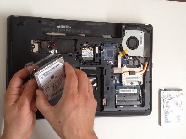

  2. Lenovo ThinkPad Edge E530 HDD Replacement, HDD (Hard Disk Drive): step 2, image 1 of 3 Lenovo ThinkPad Edge E530 HDD Replacement, HDD (Hard Disk Drive): step 2, image 2 of 3 Lenovo ThinkPad Edge E530 HDD Replacement, HDD (Hard Disk Drive): step 2, image 3 of 3
    • There are 2 x philips screws, securing the HDD Caddy Case. Remove them and slide the HDD to disconnect it from the SATA Connector.
    • The Caddy Case is held to the HDD by 4x Phillips screws. Remove them and separate the HDD from the case.
    • After installing the new HDD you must install a new OS or clone your old HDD.
    • You can install SATA HDD, 2.5" up to 1TB.
