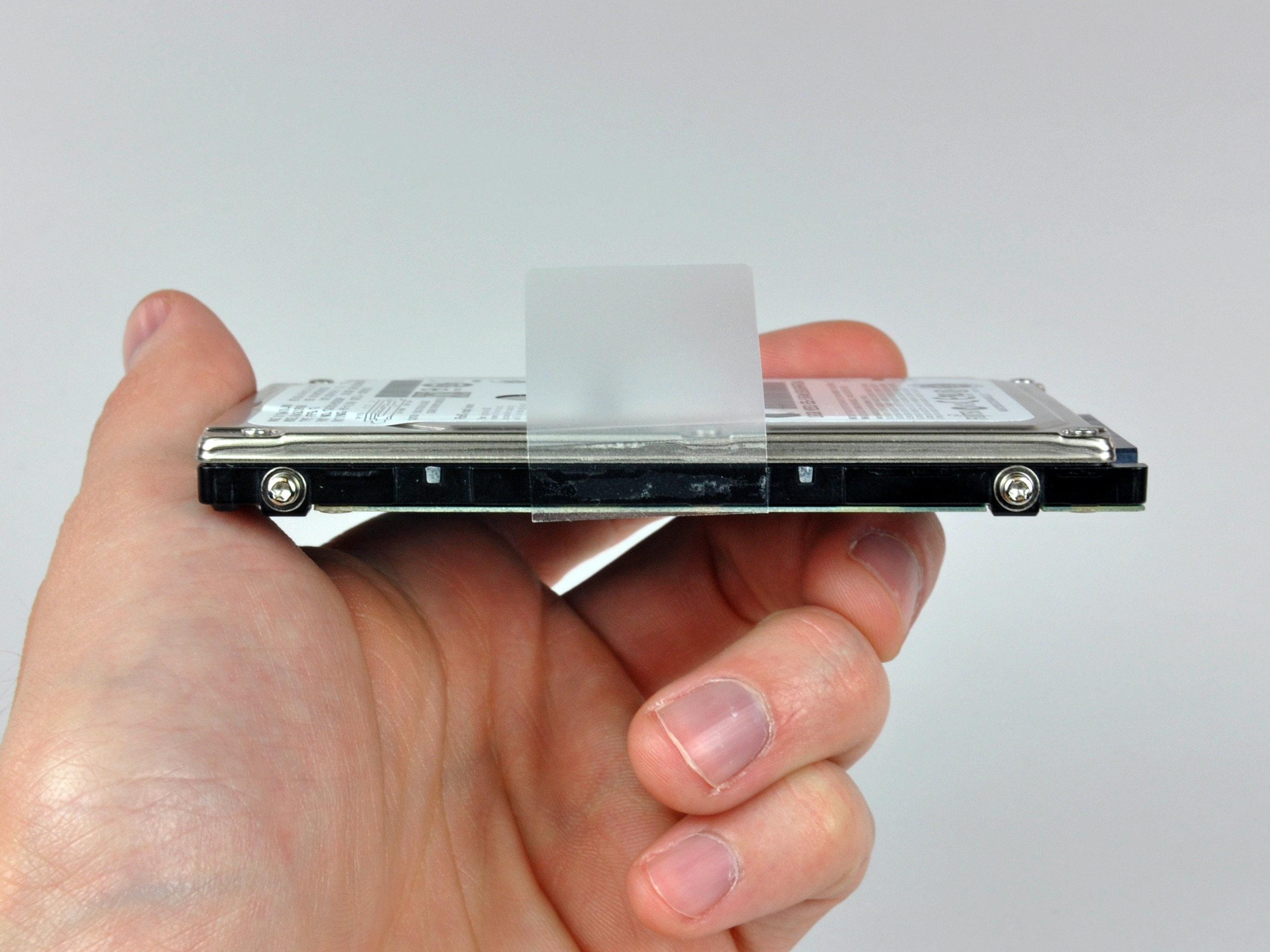

  8. MacBook Pro 13" Unibody Mid 2009 Hard Drive Replacement, Hard Drive: step 8, image 1 of 2 MacBook Pro 13" Unibody Mid 2009 Hard Drive Replacement, Hard Drive: step 8, image 2 of 2
    • Remove the two T6 Torx screws from each side of the hard drive (four screws total).
    • You'll need to transfer these screws to your new hard drive if you're changing drives.
