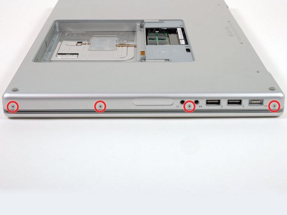

    • Remove the four 3.4 mm Phillips screws on the port side of the computer.

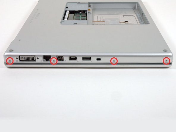

    • Rotate the computer 90 degrees again and remove the four Phillips screws from the side of the computer.

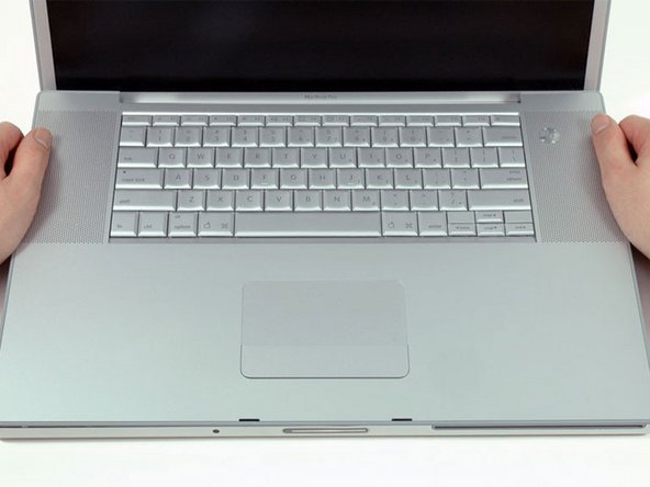

    • Do not yank the upper case off quickly. The case is attached to the logic board via a ribbon cable.
    • Lift up the back of the case and work your fingers along the sides, freeing the case as you go. Once you have freed the sides, you may need to rock the case up and down to free the front of the upper case.
  10. MacBook Pro 17" Models A1151 A1212 A1229 and A1261 Hard Drive Replacement: step 10, image 1 of 1
    • Disconnect the trackpad and keyboard ribbon cable from the logic board.
    • Remove the upper case.

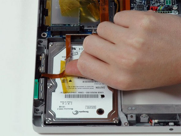

    • Peel up the orange ribbon cable taped to the top of the hard drive. This cable is still connected to the hard drive, so you will only be able to lift up on the cable a little.

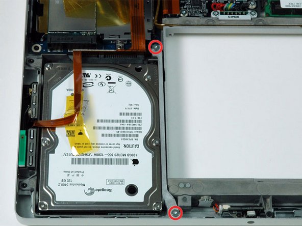

  12. MacBook Pro 17" Models A1151 A1212 A1229 and A1261 Hard Drive Replacement: step 12, image 1 of 1
    • Remove the two T6 Torx screws securing the hard drive retaining bracket to the lower case.

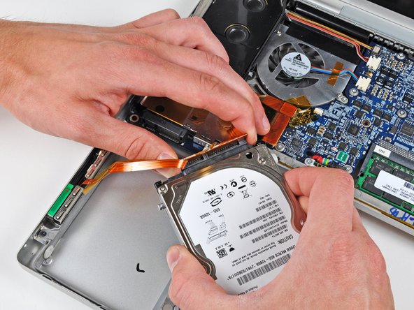

    • Lift the hard drive by tilting it from the right hand side, then lift it gently out of the lower case.
    • If present, remove the piece of tape holding the hard drive connector in its socket on the hard drive.
  15. MacBook Pro 17" Models A1151 A1212 A1229 and A1261 Hard Drive Replacement: step 15, image 1 of 1
    • Disconnect the hard drive cable by pulling its connector away from the hard drive.

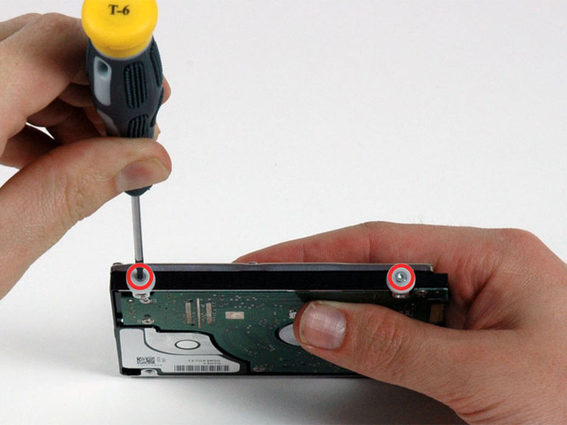

  16. MacBook Pro 17" Models A1151 A1212 A1229 and A1261 Hard Drive Replacement, Hard Drive: step 16, image 1 of 1
    • Remove the two silver T6 Torx screws and white (or black) rubber bumpers from the right side of the hard drive.
    • You'll need to transfer these screws and bumpers to your new hard drive if you're changing drives. Make sure to put these on the right side of the drive when looking at the label with the SATA connector at the far end.

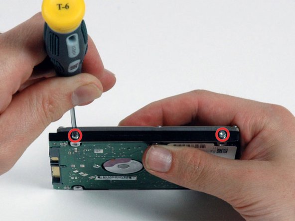

  17. MacBook Pro 17" Models A1151 A1212 A1229 and A1261 Hard Drive Replacement: step 17, image 1 of 1
    • Remove the two silver T6 Torx screws from the left side of the hard drive (the rubber bumpers remain in the case for the left side of the drive)
    • You'll need to transfer these screws to your new hard drive if you're changing drives.
