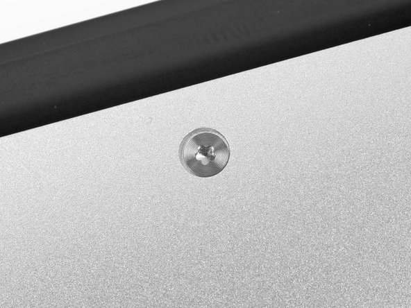

  1. MacBook Pro with Retina Display Bill of Materials, Case Components: step 1, image 1 of 1
    • Pentalobe screw - quantity 10

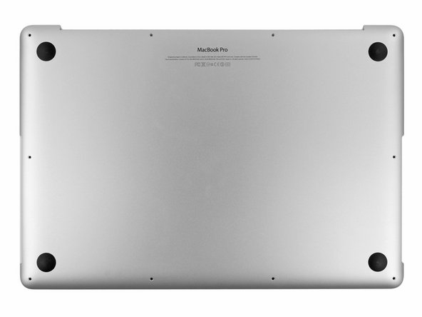

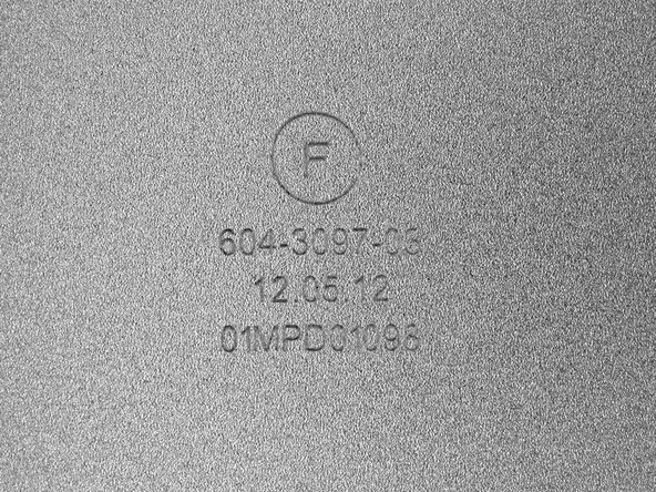

  2. MacBook Pro with Retina Display Bill of Materials: step 2, image 1 of 2 MacBook Pro with Retina Display Bill of Materials: step 2, image 2 of 2
    • Lower case - quantity 1
    • 604-3097-03 12.05.12 01MPD01098

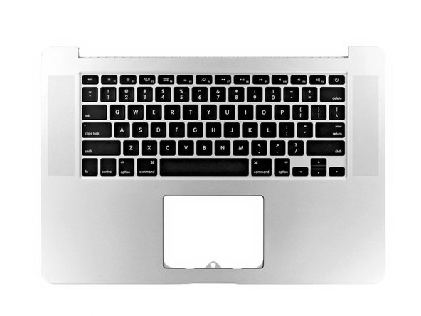

  3. MacBook Pro with Retina Display Bill of Materials: step 3, image 1 of 2 MacBook Pro with Retina Display Bill of Materials: step 3, image 2 of 2
    • Upper case - quantity 1
    • 313-9739-15 2012.05.29 02VPN01076

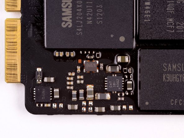

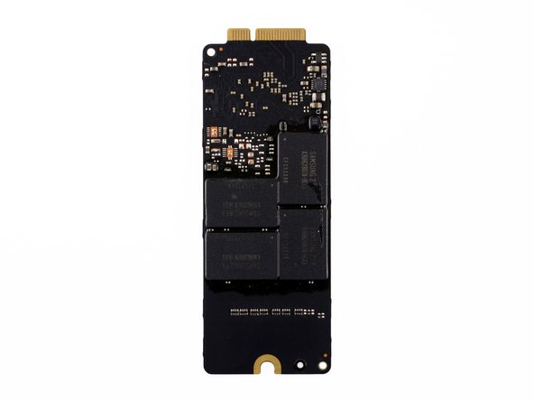

  5. MacBook Pro with Retina Display Bill of Materials, Storage: step 5, image 1 of 3 MacBook Pro with Retina Display Bill of Materials, Storage: step 5, image 2 of 3 MacBook Pro with Retina Display Bill of Materials, Storage: step 5, image 3 of 3
    • Flash memory module - quantity 1
    • Samsung S4LJ204X01 - quantity 1
    • Samsung 213 K9UHGY8U7A - quantity 8
    • Samsung 201 K4T263140F - quantity 1
    • CAT 1BI A3GJ - quantity 1
    • D602A - quantity 1
    • FN1YQ - quantity 1

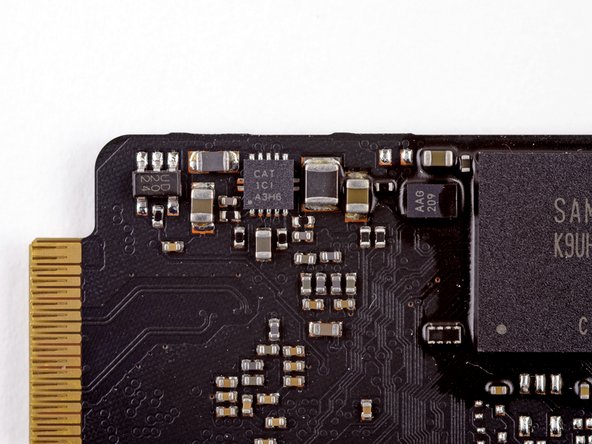

  6. MacBook Pro with Retina Display Bill of Materials: step 6, image 1 of 3 MacBook Pro with Retina Display Bill of Materials: step 6, image 2 of 3 MacBook Pro with Retina Display Bill of Materials: step 6, image 3 of 3
    • AAG 205 VC - quantity 1
    • AAG 209 VC - quantity 1
    • Samsung 213 K9UHGY8U7A - quantity 4
    • CAT 1C1 A3H6 - quantity 1
    • UD 20 24 - quantity 1
    • T5 Torx SSD screw - quantity 1

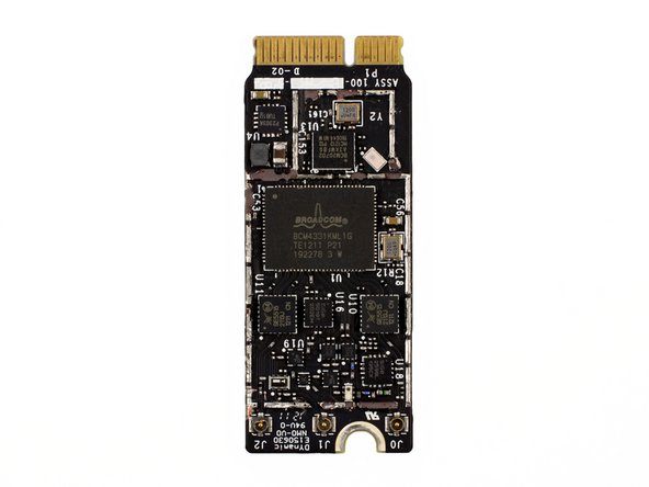

  7. MacBook Pro with Retina Display Bill of Materials, Wireless Module: step 7, image 1 of 1
    • AirPort/Bluetooth board - quantity 1
    • Broadcom BCM4331 - quantity 1
    • Broadcom BCM20702 - quantity 1
    • Skyworks SE5515 - quantity 2
    • SiGe 5019T - quantity 1
    • SiGe 2598L - quantity 1
    • Skyworks SKY3 5404 - quantity 1

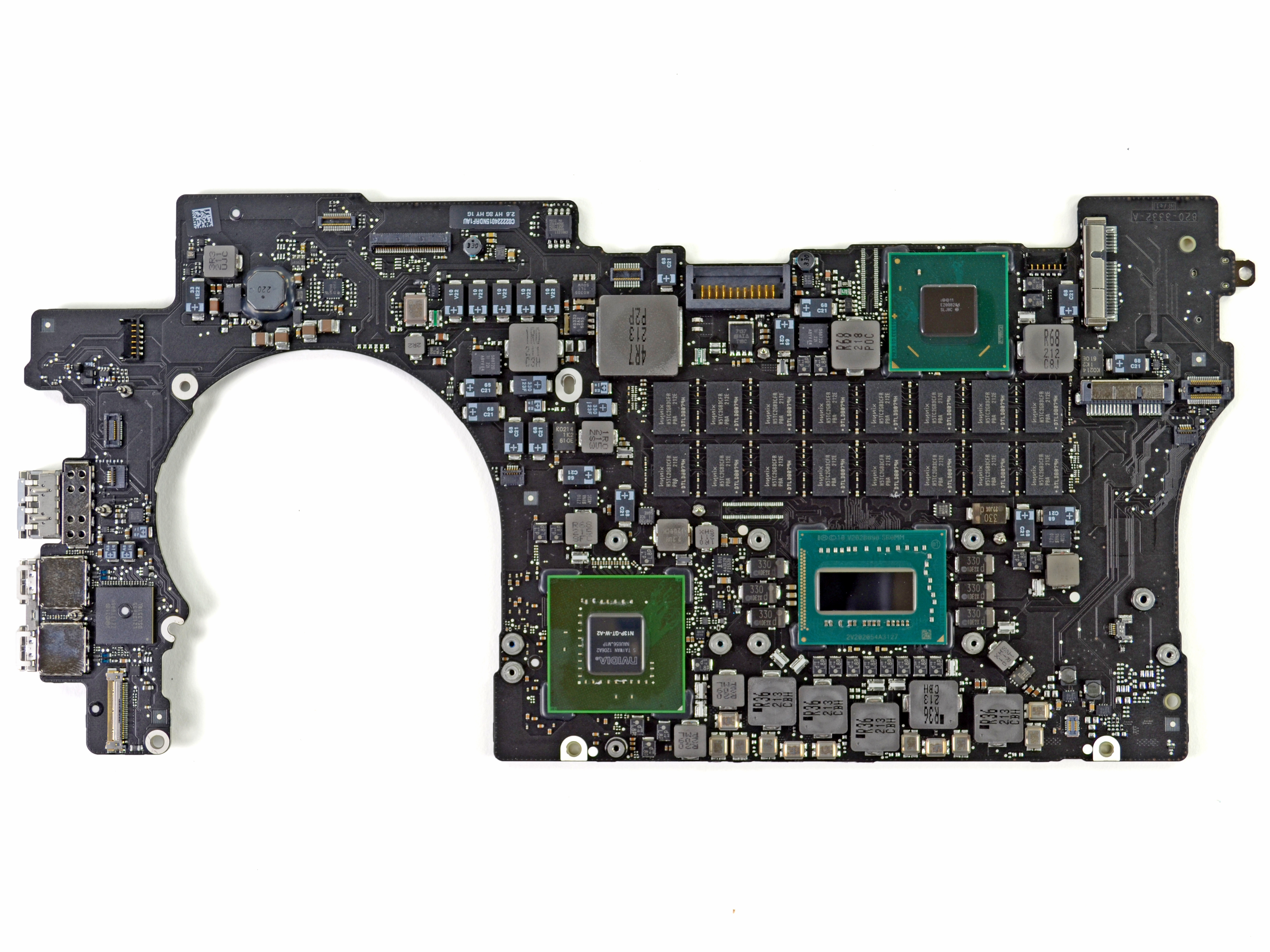

  15. MacBook Pro with Retina Display Bill of Materials: step 15, image 1 of 1
    • NVIDIA GeForce GT 650M GPU - quantity 1
    • Intel Core-i7 3720QM 2.6 GHz processor (Turbo Boost up to 3.6 GHz) with Intel Graphics HD 4000 - quantity 1
    • Hynix H5TC2G83CFR DDR3L SDRAM - quantity 16
    • Intel DSL3510L Thunderbolt controller - quantity 1
    • Intel E208B284 Platform Controller Hub - quantity 1
    • 7137 SAIΔ T18 - quantity 1
    • 3301DE2X - quantity 6
    • LCPG 221D - quantity 2
  16. MacBook Pro with Retina Display Bill of Materials, Logic Board: step 16, image 1 of 1
    • Z710BBN∆ W22C - quantity 1
    • KO214 1K2 61OE - quantity 2
    • 58872D T1 22I A8YV E4 -quantity 2
    • Infineon 4AIRZR F213JB - quantity 1
    • 58873D TI ICE SGKE - quantity 1
    • MXIC 25L6 406E M2I-12GF 3J993600 L121083 - quantity 1
    • National Semiconductor VM21AB 45-EXTJ - quantity 1
  17. MacBook Pro with Retina Display Bill of Materials: step 17, image 1 of 1
    • 10 V22 - quantity 5
    • 68 C21 - quantity 13
    • 331 E22 - quantity 1
    • 33 0I23F - quantity 2
    • 33 1E22 - quantity 1
    • R36 213 CBH - quantity 5
    • R68 218 P0C - quantity 2
    • 4R7 213 P2P - quantity 1
  18. MacBook Pro with Retina Display Bill of Materials: step 18, image 1 of 1
    • L8P - quantity 21
    • 330 22J0K - quantity 1
    • R20 209 PML - quantity 2
    • 1R0 211 SHX - quantity 2
    • 2710 - quantity 2
    • 330 - quantity 1
    • 2R2 - quantity 1
    • 220 - quantity 1
  19. MacBook Pro with Retina Display Bill of Materials: step 19, image 1 of 1
    • 3R3 211 UJC - quantity 1
    • 2.2W 1209CX - quantity 1
    • J8jr - quantity 1
    • Intersil 8014AIRZR - quantity 1
    • BNW1YK - quantity 2
    • 09BF1MLH - quantity 1
    • LDPR 194L - quantity 1
  20. MacBook Pro with Retina Display Bill of Materials: step 20, image 1 of 1
    • 638Z0 - quantity 1
    • AG∆W22B - quantity 1
    • AV0 - quantity 1
    • 23 C30 - quantity 1
    • 470 Ω resistor - quantity 1
    • 100 Ω resistor - quantity 1
    • R005 - quantity 1
    • 1010-SMMC-1209 - quantity 3
  21. MacBook Pro with Retina Display Bill of Materials: step 21, image 1 of 1
    • 1014 55WY 1206 - quantity 1
    • 1011 5KT0 1208 - quantity 7
  22. MacBook Pro with Retina Display Bill of Materials: step 22, image 1 of 1
    • Hynix H5TC2G83CFR - quantity 16
    • Hynix H5GQ2H24AFR - quantity 4
    • Texas Instruments Stellaris LM4FS1AH - quantity 1
    • Renesas R4F2113 H8S series - quantity 1
    • Maxim MAX15119 - quantity 1
    • Cypress Semiconductor CY8C24794-24L - quantity 1
    • TL020403A 6352 102 Z8D202 - quantity 1
    • SMSC USB2512B - quantity 1
  23. MacBook Pro with Retina Display Bill of Materials: step 23, image 1 of 1
    • Infineon 6288C HRTZ F207CVT - quantity 1
    • HD3SS212 24KKW R - quantity 1
    • ZTB TI 22I AVG5 - quantity 2
    • R4F2113 XLG A02 AD01359 1216JPN - quantity 1
    • TPS 51980 TI 21K CSD2 - quantity 1
    • Infineon 9AHRTZ F207WW - quantity 1
    • 3957 B62004 - quantity 1
    • CD3210 A0 T1 231 AHHY - quantity 1
  24. MacBook Pro with Retina Display Bill of Materials: step 24, image 1 of 1
    • 68 C21 - quantity 16
    • E7 Cn - quantity 4
    • J8eb - quantity 3
    • jSq - quantity 8
    • jSn - quantity 1
    • R005 - quantity 1
    • 100 - quantity 1
    • BMH IAX - quantity 2
  25. MacBook Pro with Retina Display Bill of Materials: step 25, image 1 of 1
    • GAW SMH - quantity 1
    • BQZKTI K1C4P - quantity 1
    • 3349 113G - quantity 2
    • 8OB2CBY - quantity 1
    • 27 000 24111 - quantity 1
    • ZTBTI 221AVG5 - quantity 2
    • VA - quantity 1
    • GAV SP9 - quantity 2
  26. MacBook Pro with Retina Display Bill of Materials: step 26, image 1 of 1
    • P8Z3 - quantity 1
    • +AIH 210 - quantity 1
    • Y2T 201 - quantity 1
    • 0134T E2424 - quantity 1
    • 1484AV 24006 - quantity 1
    • KLD23 3Z014 - quantity 1
    • XDDL - quantity 1
    • SU - quantity 1
  27. MacBook Pro with Retina Display Bill of Materials: step 27, image 1 of 1
    • BNW1Y2 - quantity 3
    • V08 - quantity 3
    • KABZ4 - quantity 5
    • 51916 T1
    • BFW2EAB - quantity 1
    • 100 - quantity 2
    • 7615 BAY - quantity 1
    • DP - quantity 2
  28. MacBook Pro with Retina Display Bill of Materials: step 28, image 1 of 1
    • D1 - quantity 1
    • a2 - quantity 1
    • BQZ T1 K 1C4P - quantity 1
    • 82589AH - quantity 1
    • CFT - quantity 1
  29. MacBook Pro with Retina Display Bill of Materials: step 29, image 1 of 1
    • T5 Torx logic board screw - quantity 4
