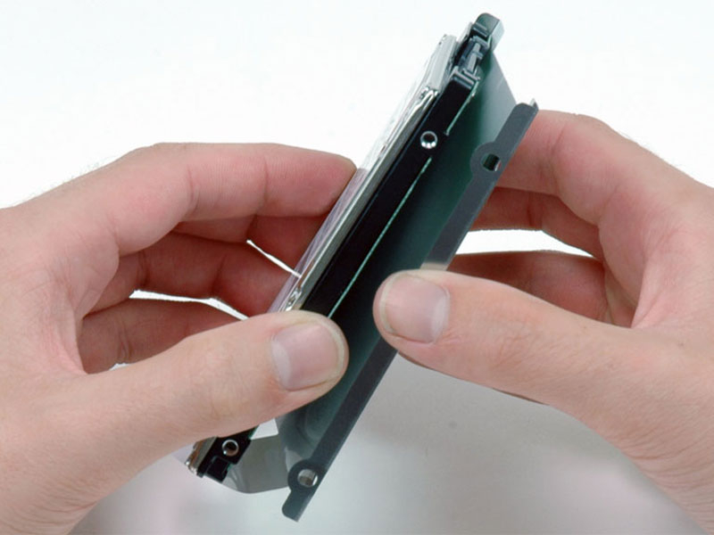

  6. MacBook Core Duo Hard Drive Replacement, Hard Drive: step 6, image 1 of 1
    • Remove the two black T8 Torx screws securing the silver bracket to the hard drive.
  7. MacBook Core Duo Hard Drive Replacement: step 7, image 1 of 1
    • Rotate the hard drive and remove the two black T8 Torx screws on the other side of the drive.
  8. MacBook Core Duo Hard Drive Replacement: step 8, image 1 of 1
    • Lift the silver metal hard drive bracket off of the hard drive.
    • You'll need to transfer this metal bracket to your new hard drive.
