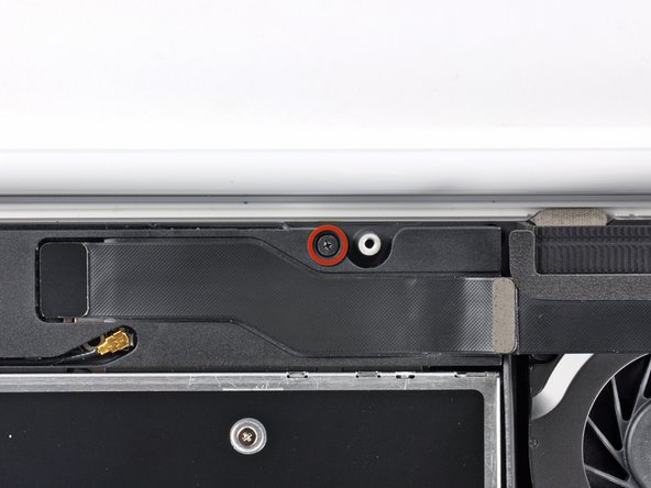

  7. MacBook Unibody Model A1342 Optical Drive Replacement, Optical Drive: step 7, image 1 of 1
    • Remove the single 12 mm Phillips screw securing the top of the rear speaker housing to the upper case.

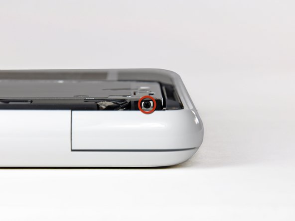

  8. MacBook Unibody Model A1342 Optical Drive Replacement: step 8, image 1 of 1
    • Remove the single 2.2 mm Phillips screw inserted horizontally into the side of the optical drive.
    • This screw is located in a gap within the right speaker assembly, and is visible only from the hinge edge.

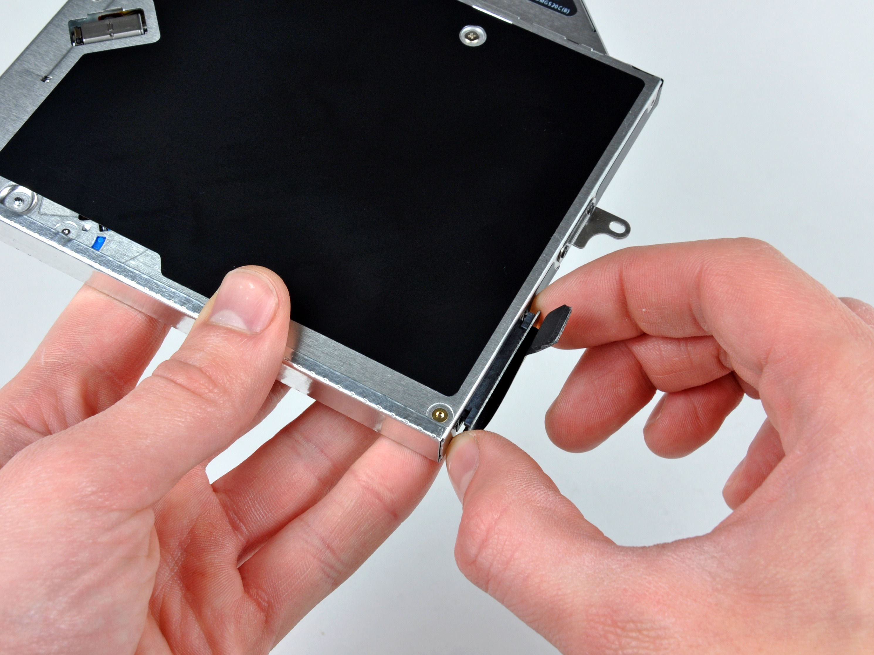

  16. MacBook Unibody Model A1342 Optical Drive Replacement, Optical Drive: step 16, image 1 of 1
    • Pull the optical drive cable connector away from the body of the optical drive.
  17. MacBook Unibody Model A1342 Optical Drive Replacement: step 17, image 1 of 1
    • Remove the two black Phillips #0 screws securing the small metal mounting bracket. Transfer this bracket to your new optical drive or hard drive enclosure.

FYI, I replaced the drive and tried to cut a corner by not replacing the screw in step 8. This was a big mistake as it vibrated horribly even when level and still. Once I replaced the screw, the vibration was almost non-existent.
Nate - Reply
