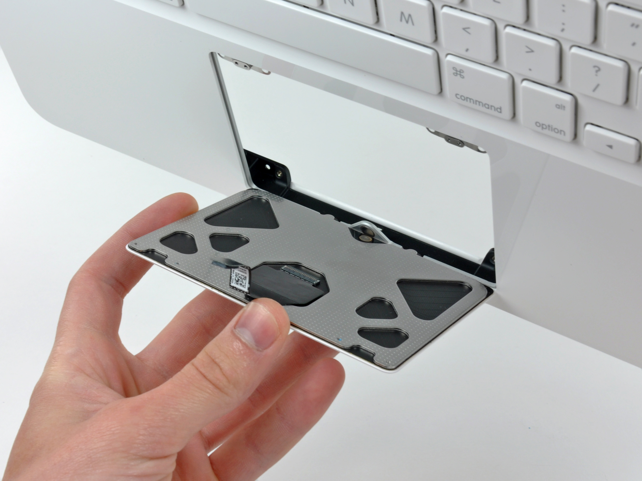

  42. MacBook Unibody Model A1342 Upper Case Replacement, Upper Case: step 42, image 1 of 1
    • Remove the four 1.3 mm Phillips screws securing the upper edge of the trackpad to the upper case.
  43. MacBook Unibody Model A1342 Upper Case Replacement: step 43, image 1 of 1
    • Carefully tilt the trackpad away from the keyboard side of the upper case.
    • Pull the trackpad away from its opening in the upper case to clear the two mounting tabs on its lower edge.
