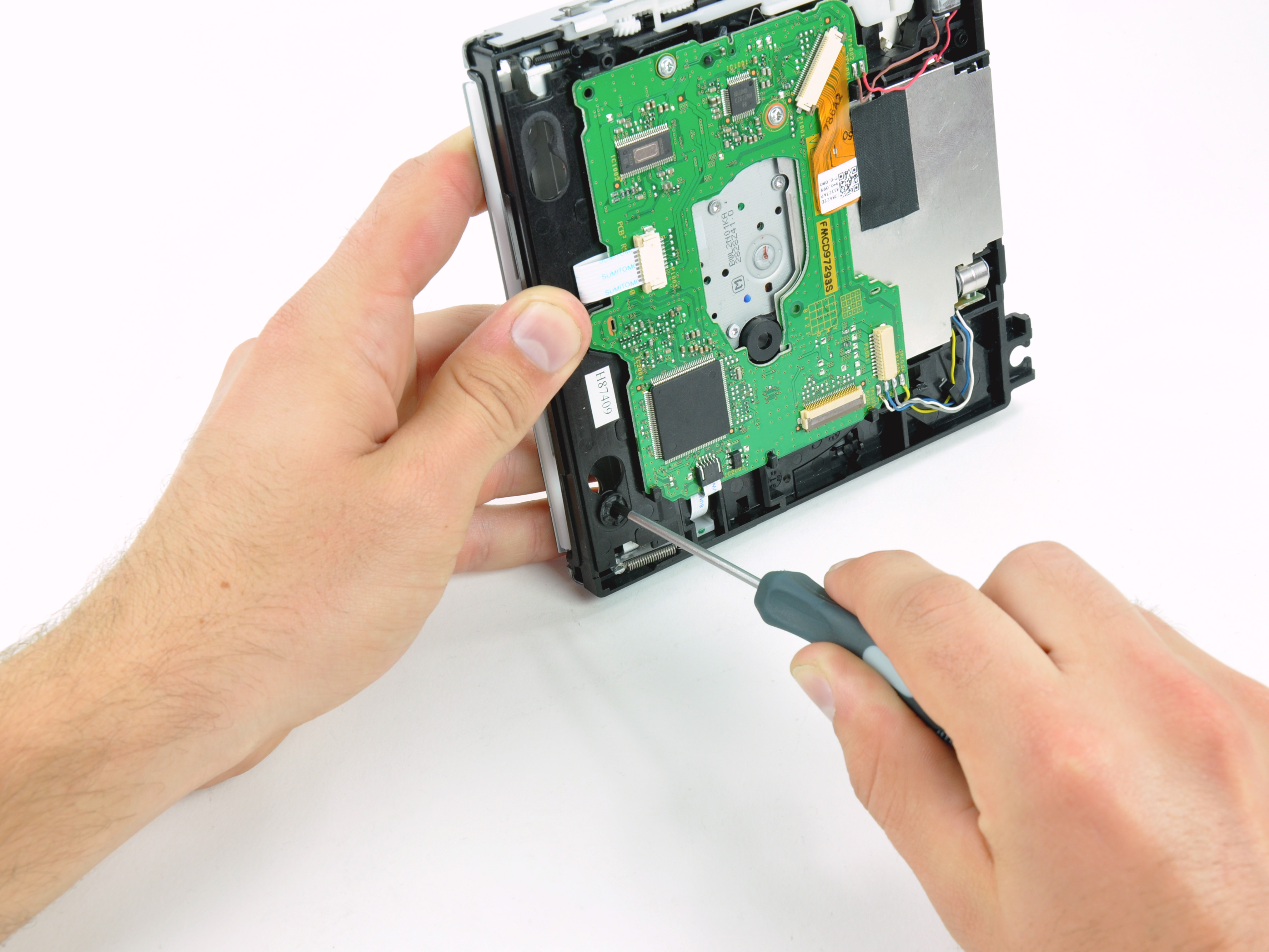

Use this guide to replace a broken DVD drive. Depending on your new part, you may have to swap out the four rubber grommets on the DVD drive housing.

Insert the tip of a long, skinny screwdriver into the hole in the center of the first grommet on the rear of the DVD drive housing.
Pull the grommet straight away from the DVD drive housing until it is free.
