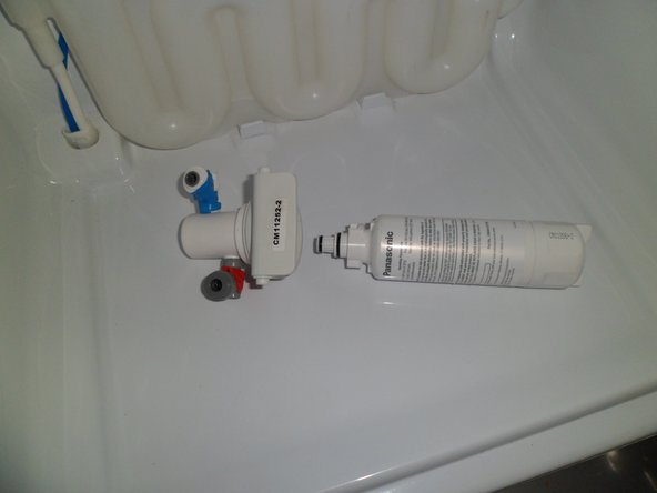

    • BEFORE DEINSTALLING THE FILTER CUT OFF THE WATER LINE. Lay a Towel in the Fridge. Also cut off AC Mains. This is an opened Waterfilter. Inside is a sort of coal which adsorbs unhealthy particles. It has to be changed every 6 months or less.

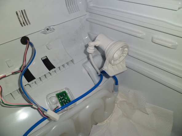

    • Behind the lowest drawer is an plastic panel, which can easy be pulled off. Now you can see the Water-reservoir for the Water Outlet. Also you can see on the right the hosing for the Waterfilter. There are no screws.

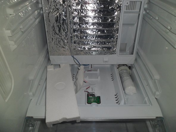

    • The Botton above the lowest drawer has a heating foil. Unscrew on the back a PH2 Head screw. Also is a PH2 in front left at the Filter's place. Now carefully lift the Bottom. Take out the Styroporfoam-Element. Then open the Plasticbag which contains the Connector for the Heating. You should cut-off the AC-Mains before unplugging this Connector.
    • Now you can remove the Heating; Top of the Bottom.
    • Open the shorter PH2 Screw to release the LED-Light on the Bottom. That's necessary because with the wires at it you could not pull out the chassis of the Bottom.

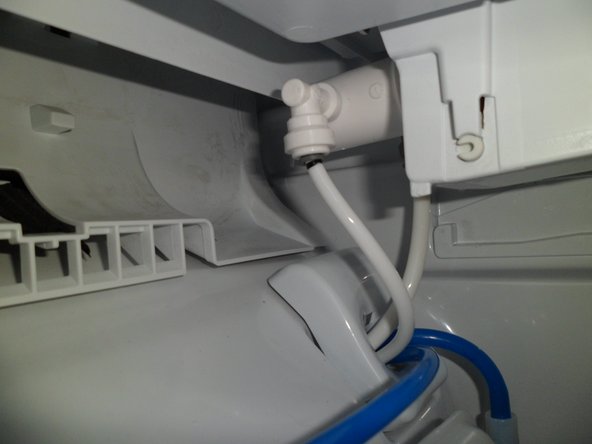

    • Now you can pull out the Chassis of the lower Bottom, use a Plastictool for the Clipse. Pull off the holder of the Waterfilter.

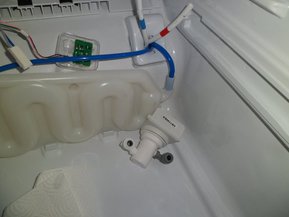

    • Here you have the a picture of the Filterholder. The Towel soaks the water
    • The Inputhose has 8 mm. The Output has 6,35 mm (1/4"). Lay a small Towel under the Holder.
    • Pull off the hoses. Some Water could come out. Mark the tubes with red and blue tape. So it will be easier to reasemle if a warrranty-check could occur.

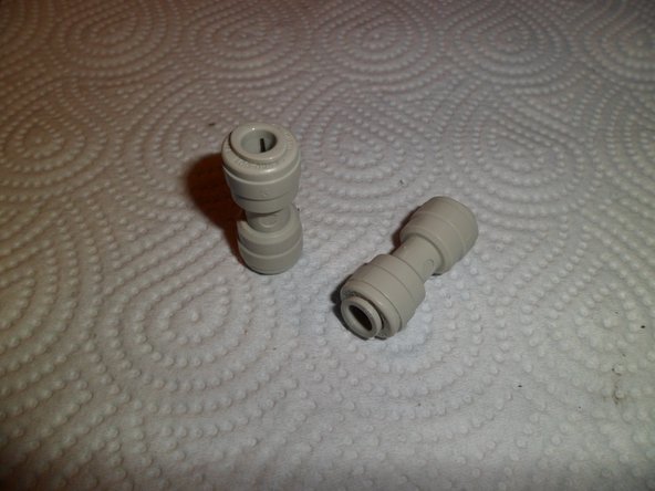

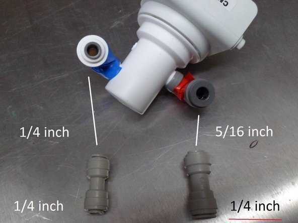

    • Now you need some plug couplings. Adapter from 6,35 mm (thats 1/4 inch) to 8 mm (thats 5/16 inch), Coupling 6,35 to 6,35 and a piece of hose 6,35. Carefully cut the hose nice and clean with a ahrsp cutter. Now easy click these parts together. Now you have a Bypass for the original Filtermount. :)

in order to bypass the original filter, it need as 1/4 inch coupler? or asking differently,- Panasonic works with 1/4 inch hoses?
roli - Reply
Hello,
the hose from outside has 1/4 inch diameter, that's 6,35 mm. Right. :)
But inside, where the original bottle-filter is connected, the inlet hose has 5/16 inch (ca 8 mm) and the outlet hose has 1/4 inch.
In STEP 6 picture 2 is shown the different diameters. The second grey coupler is thicker, thats an adapter from 1/4 inch to 5/16 inch. I've made a new picture for you in STEP 7.
Friendly greets. :)
Schwarzstein -
