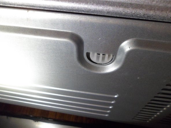

  2. Panasonic NR B 53 V1  Refrigerator ventilator / fan cleaning: step 2, image 1 of 2 Panasonic NR B 53 V1  Refrigerator ventilator / fan cleaning: step 2, image 2 of 2
    • There are PH2 screws on the backplate. One is hidden behind the waterhose.
    • All screws have the same length
    • In the green circle, there is the water outlet from the reservoir of the defrosting automatic. there is water in it ! So open the plate slowly.
    • I had to cut the waterhose, when you do this too dont forget to close the faucet. I put some aluminiumfoil on the hose, so there cant get any dust in the hose, because there is lots of dust and its not good when dust gets into the waterhose of the fridge. You must have a 1/4" coupler to reassmble the waterhose when you are done !!!

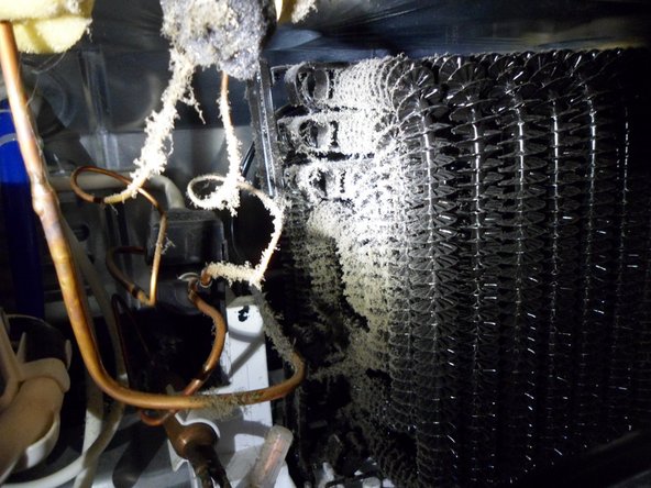

  3. Panasonic NR B 53 V1  Refrigerator ventilator / fan cleaning: step 3, image 1 of 3 Panasonic NR B 53 V1  Refrigerator ventilator / fan cleaning: step 3, image 2 of 3 Panasonic NR B 53 V1  Refrigerator ventilator / fan cleaning: step 3, image 3 of 3
    • No words necessary. So that are pictures from the inside, behind the backplate. ... Thats the pollution from ONLY 3 years, and you would not believe me but we have a "clean" household...

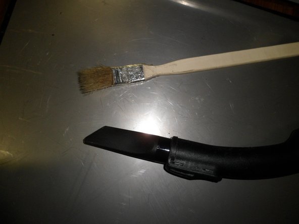

  4. Panasonic NR B 53 V1  Refrigerator ventilator / fan cleaning: step 4, image 1 of 3 Panasonic NR B 53 V1  Refrigerator ventilator / fan cleaning: step 4, image 2 of 3 Panasonic NR B 53 V1  Refrigerator ventilator / fan cleaning: step 4, image 3 of 3

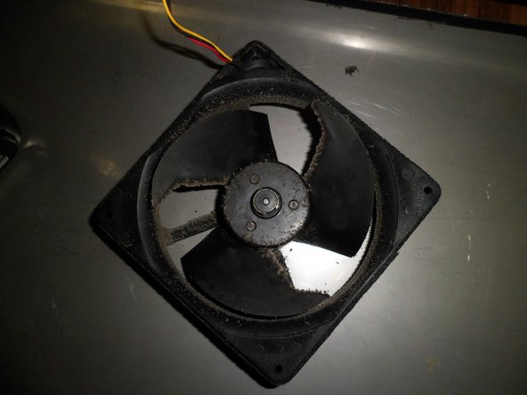

    • So take a new, clean & long paintbrush and the vacuum-cleaner and do the best you can to remove all the dirt. Ja, much better now.

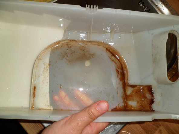

    • Also clean the waterreservoir, It can easy pulled out, but slowly, there is water in it. Looks like Bratensosse zu my Schnitzel.

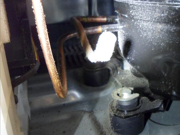

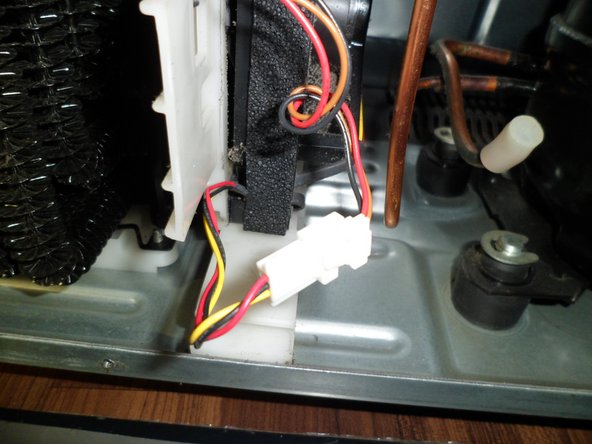

  6. Panasonic NR B 53 V1  Refrigerator ventilator / fan cleaning: step 6, image 1 of 3 Panasonic NR B 53 V1  Refrigerator ventilator / fan cleaning: step 6, image 2 of 3 Panasonic NR B 53 V1  Refrigerator ventilator / fan cleaning: step 6, image 3 of 3

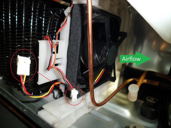

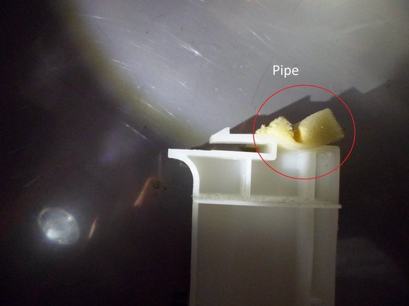

    • The fan has a white Bracket with some foam at a gaspipe. I have no Photo of that part, but you can see it in Step #9. Goto to #9, Ja. ...carefully remove it. There is a plug with a clip. The fan has no screws and no clipse. Just pull it carefully. Very easy !

    • Here you can read the Print on that Fan.
    • It says: NMB MAT - 1L12A79 - g51 - Model 4715JL-09W-S29 - DC 11.5V - 0,19A - Minebea Motor China ...

  9. Panasonic NR B 53 V1  Refrigerator ventilator / fan cleaning: step 9, image 1 of 3 Panasonic NR B 53 V1  Refrigerator ventilator / fan cleaning: step 9, image 2 of 3 Panasonic NR B 53 V1  Refrigerator ventilator / fan cleaning: step 9, image 3 of 3
    • The direction of the fan, just slide it in, watch the wires and the gaspipe. Then put in the white part as shown on the second picture, the pipe lays in that foam. ja.

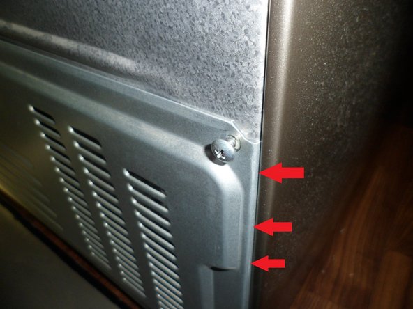

    • So you can close the plate, look where I made the red arrows, that has to fit in the crack on the side, also take care at the waterhose.
    • So revolve the scrtews like shown in Step#2
