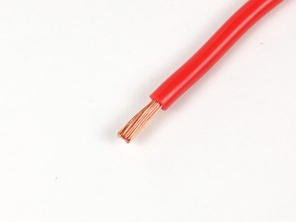

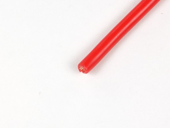

  2. Constructing a Capacitor Discharge Tool: step 2, image 1 of 2 Constructing a Capacitor Discharge Tool: step 2, image 2 of 2
    • Begin the process by stripping one side end of each length of wire.
    • To ensure a solid solder joint, strip at least .25" of insulation off the wire.
