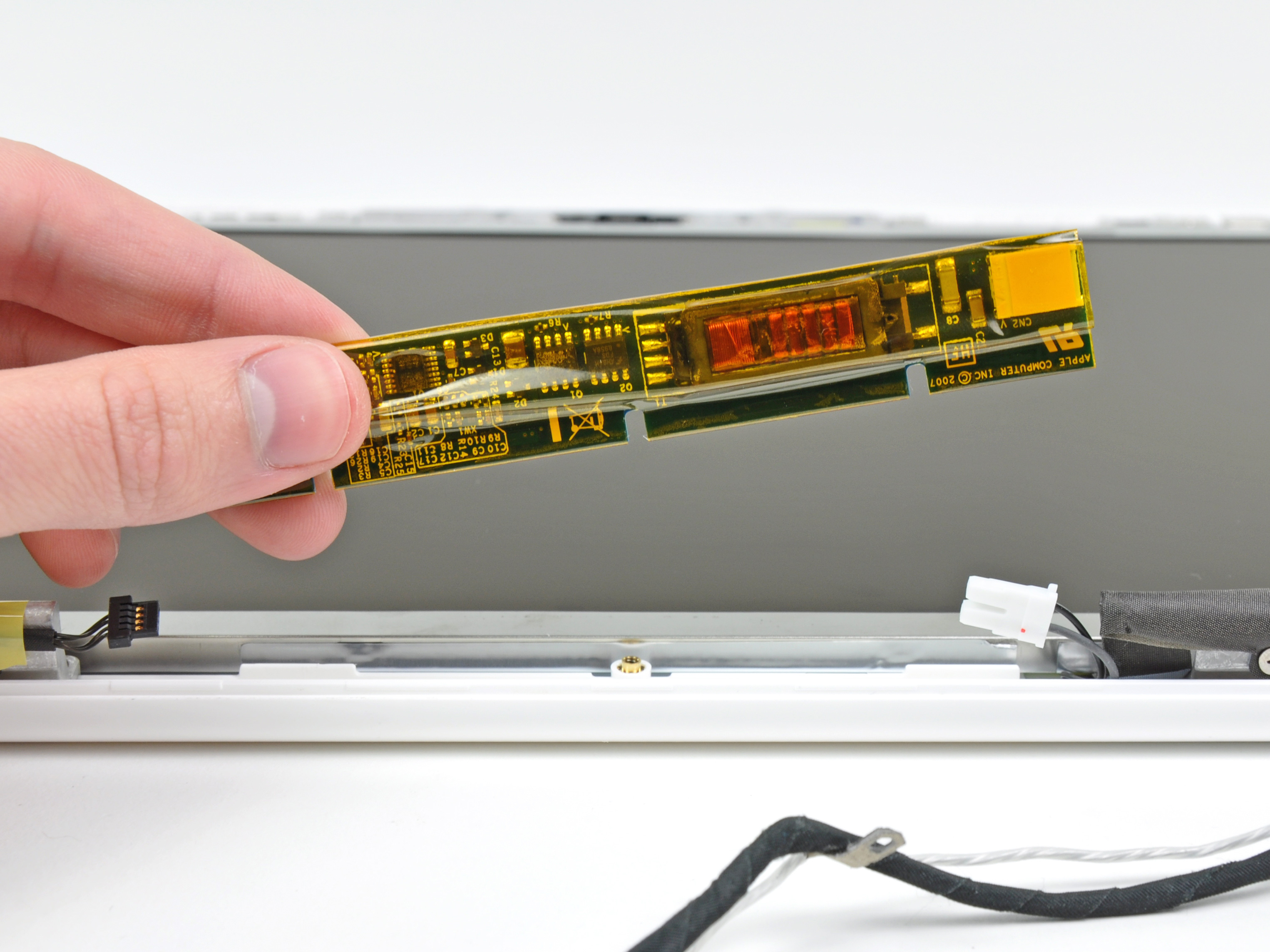

  43. MacBook Core Duo Inverter Replacement, Inverter: step 44, image 1 of 2 MacBook Core Duo Inverter Replacement, Inverter: step 44, image 2 of 2
    • Slightly lift the newly-revealed inverter board out of its housing and disconnect the black inverter cable from the left end of the board.
  44. MacBook Core Duo Inverter Replacement: step 45, image 1 of 2 MacBook Core Duo Inverter Replacement: step 45, image 2 of 2
    • Disconnect the white inverter cable from the right end of the inverter board.
  45. MacBook Core Duo Inverter Replacement: step 46, image 1 of 1
    • Remove the inverter board from the display.
43 other people completed this guide.
