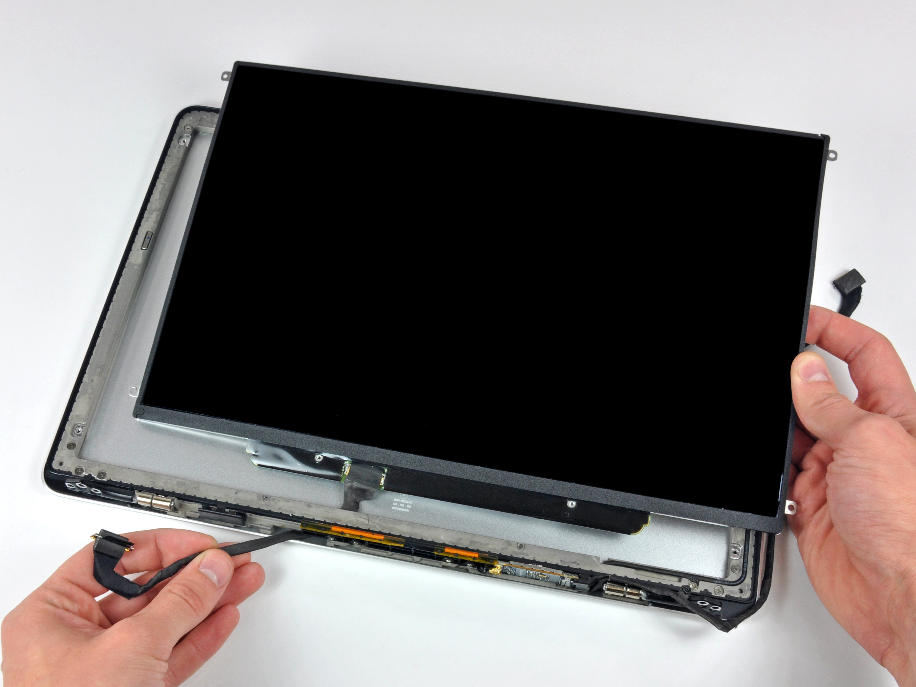

  27. MacBook Pro 13" Unibody Mid 2009 LCD Replacement, LCD: step 27, image 1 of 1
    • De-route the display data cable from its retaining bracket near the lower left edge of the display.
  28. MacBook Pro 13" Unibody Mid 2009 LCD Replacement: step 28, image 1 of 1
    • Remove the following six screws securing the LCD panel to the front bezel:
    • Four 3.25 mm Phillips with large heads.
    • Two 3.2 mm Phillips with small heads.
  29. MacBook Pro 13" Unibody Mid 2009 LCD Replacement: step 29, image 1 of 1
    • Do not try to remove the LCD yet. The circuitry along its lower edge is wedged in a gap along the lower edge of the display recess in the aluminum display assembly.
    • Hold the display vertically and tip it enough to grab the top edge of the LCD and rotate it slightly out of the display assembly, being careful not to break the circuitry off its lower edge.
  30. MacBook Pro 13" Unibody Mid 2009 LCD Replacement: step 30, image 1 of 1
    • Pull the LCD toward the top edge of the display to slide the circuitry along its lower edge out of the recess in the aluminum display assembly.
    • It may be helpful to use one hand to feed the display data cable through its channel in the aluminum display assembly as you pull the LCD toward the top edge of the display with the other hand.
  31. MacBook Pro 13" Unibody Mid 2009 LCD Replacement: step 31, image 1 of 1
    • Peel the piece of tape covering the display data cable connector away from the edge closest to the LCD.
  32. MacBook Pro 13" Unibody Mid 2009 LCD Replacement: step 32, image 1 of 2 MacBook Pro 13" Unibody Mid 2009 LCD Replacement: step 32, image 2 of 2
    • Use the tip of a spudger to flip up the thin steel retaining clip securing the display data cable to its socket on the LCD.
    • Pull the display data cable straight away from its socket on the LCD.
    • Lift the LCD out of the display assembly and set it aside.
