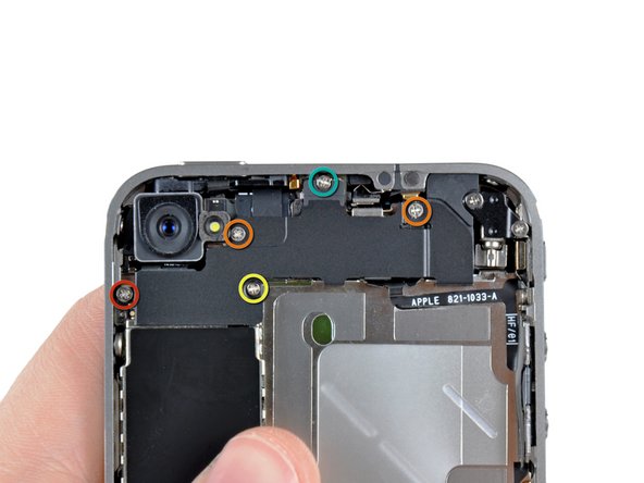

  7. iPhone 4 Rear Camera Replacement, Rear Camera: step 7, image 1 of 1
    • Remove the following five screws securing the connector cover to the iPhone:
    • One 2.3 mm Phillips
    • Two 1.6 mm Phillips
    • One 1.4 mm Phillips
    • One 4.8 mm Phillips
    • Remark: in order to remember their proper positions, it might be helpful to draw 5 circles on a sheet of paper, placing each screw in the corresponding circle.

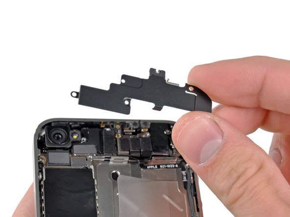

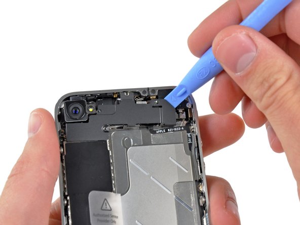

  8. iPhone 4 Rear Camera Replacement: step 8, image 1 of 3 iPhone 4 Rear Camera Replacement: step 8, image 2 of 3 iPhone 4 Rear Camera Replacement: step 8, image 3 of 3
    • Use an iPod opening tool to slightly lift the top edge of the connector cover away from the logic board.
    • Use the tip of a spudger to pull the connector cover retaining clips away from the inner frame.
    • Remove the connector cover from the iPhone.
    • Before reassembly, be sure to clean all metal-to-metal contact points on the connector cover with a de-greaser such as windex. The oils on your fingers have the potential to cause wireless interference issues.
    • There is a tiny metal part on the top screw hole, make sure this stays on. It's a key part of the wireless and GPS antenna.

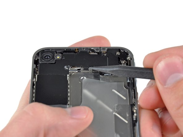

  9. iPhone 4 Rear Camera Replacement: step 9, image 1 of 1
    • Use an iPod opening tool to carefully lift the rear camera connector up off its socket on the logic board.
