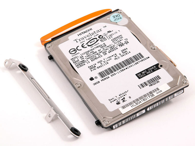

  36. iBook G4 12" 800 MHz-1.2 GHz Hard Drive Replacement, Hard Drive: step 36, image 1 of 1
    • Lift the metal restraining bracket from the hard drive and place it aside.
  37. iBook G4 12" 800 MHz-1.2 GHz Hard Drive Replacement: step 37, image 1 of 1
    • Turn the computer over and disconnect the orange hard drive cable, removing tape as necessary.
  38. iBook G4 12" 800 MHz-1.2 GHz Hard Drive Replacement: step 38, image 1 of 1
    • Remove the two Phillips screws securing the hard drive to the metal framework.
  39. iBook G4 12" 800 MHz-1.2 GHz Hard Drive Replacement: step 39, image 1 of 1
    • Lift the hard drive up, carefully guiding the cable through the slot in the lower case.
  40. iBook G4 12" 800 MHz-1.2 GHz Hard Drive Replacement, Hard Drive: step 40, image 1 of 1
    • Remove the hard drive bracket from the left side of the hard drive.
  41. iBook G4 12" 800 MHz-1.2 GHz Hard Drive Replacement: step 41, image 1 of 1
    • Remove the two black T8 Torx screws from either side of the hard drive (four screws total).
  42. iBook G4 12" 800 MHz-1.2 GHz Hard Drive Replacement: step 42, image 1 of 1
    • Use the transparent orange loop to disconnect the large orange ribbon cable from the hard drive.
    • This is a bit tricky. Try rocking the cable gently from side to side while applying even pressure. If you bend the pins, do your best to straighten them, using the hard drive cable as a guide.
    • If you are installing a new hard drive, we have an OS X install guide to get you up and running.
