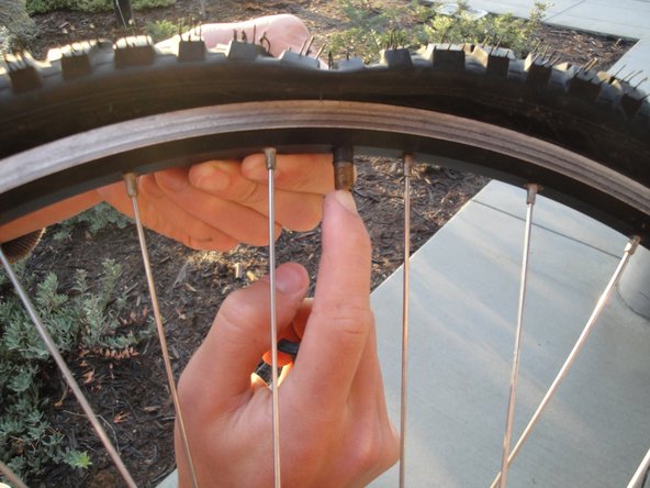

  4. Patching a Bicycle Tire Inner Tube, Inner Tube: step 4, image 1 of 1
    • Press the valve core while applying pressure to the tire to deflate the tire.

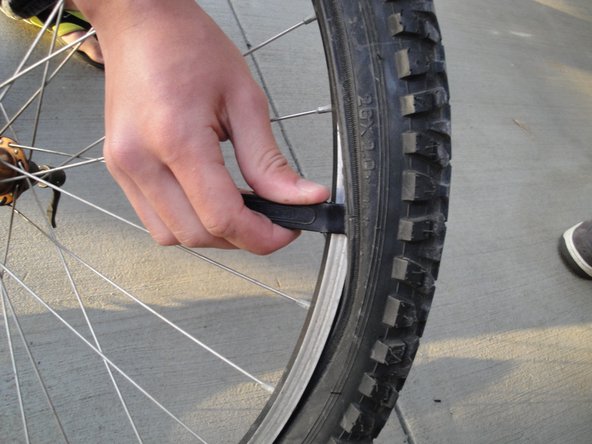

  5. Patching a Bicycle Tire Inner Tube: step 5, image 1 of 2 Patching a Bicycle Tire Inner Tube: step 5, image 2 of 2
    • Insert the flat part of a tire lever under the tire coping. Apply pressure to the other end of the lever to lift the tire up and out of the wheel.
    • Slide the lever around the circumference of the wheel to completely remove the tire.

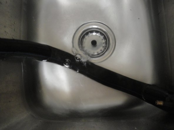

  10. Patching a Bicycle Tire Inner Tube: step 10, image 1 of 2 Patching a Bicycle Tire Inner Tube: step 10, image 2 of 2
    • Locate the leak by first over inflating the tire.
    • Place the tire under water and look for bubbles to find the leak.

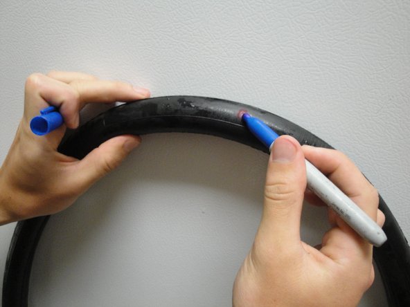

  11. Patching a Bicycle Tire Inner Tube: step 11, image 1 of 1
    • Mark the hole with a marker, and completely deflate the tire.

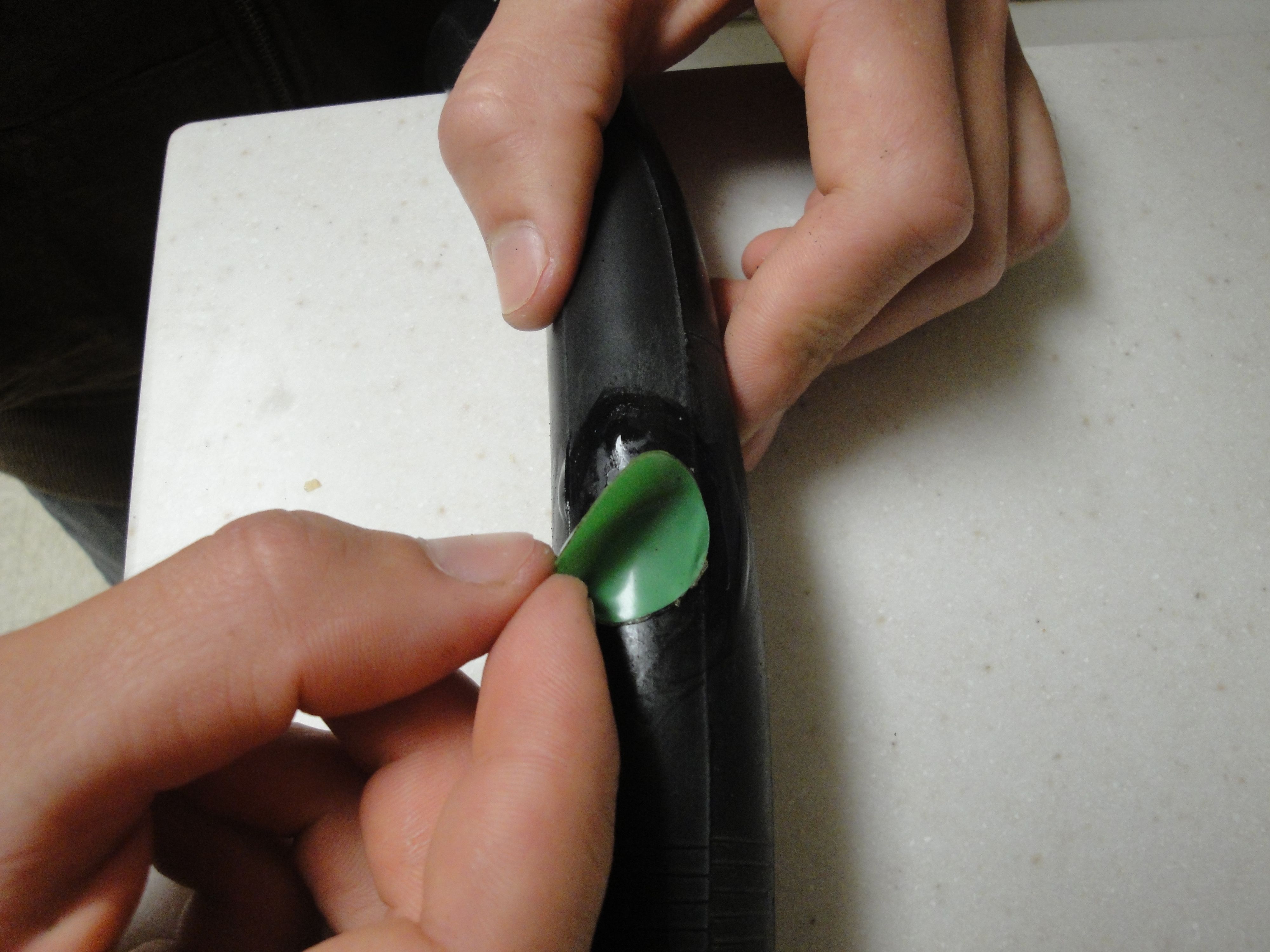

  15. Patching a Bicycle Tire Inner Tube: step 15, image 1 of 1
    • Apply the patch to the area.
  16. Patching a Bicycle Tire Inner Tube: step 16, image 1 of 1
    • Apply pressure to the patch until the rubber cement is dry.
