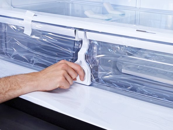

  3. Samsung Water Filter (Horizontal Filter) Replacement, Remove the filter: step 3, image 1 of 2 Samsung Water Filter (Horizontal Filter) Replacement, Remove the filter: step 3, image 2 of 2
    • Twist the water filter cap counter-clockwise until it's loosened from its housing.
  4. Samsung Water Filter (Horizontal Filter) Replacement: step 4, image 1 of 2 Samsung Water Filter (Horizontal Filter) Replacement: step 4, image 2 of 2
    • Pull the water filter straight out of its housing and remove it.
    • When you install the replacement filter, remember to remove the cap on the new filter.
