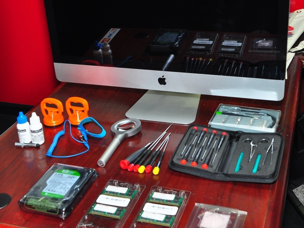

Start by gathering your parts, tools, anti-static strap and gloves (gloves are for glass & LCD)

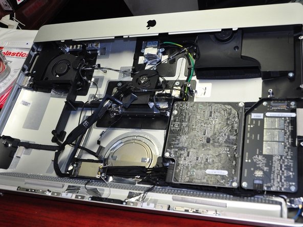

Remove glass
Then remove LCD. iFixit has step-by-step- write-ups on how to do this.

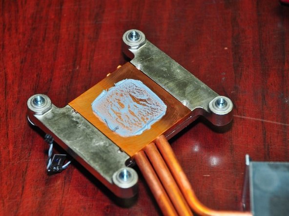

Core i7 2.93GHz Quad Core processor, Arctic Silver thermal compound and iFixit + OWC tools
Processor is Intel Core i7 870 2.93GHz 8MB LGA 1156 Quad Core Processor 95W. I bought this CPU used on eBay.

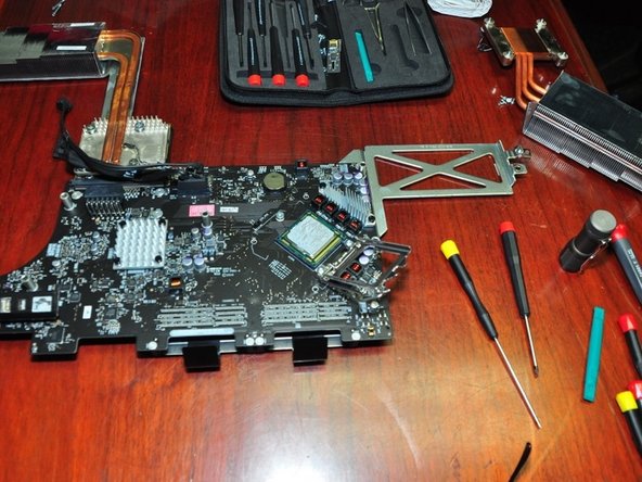

Remove HD, Superdrive and motherboard. Follow the excellent iFixit guides to remove these items.
To remove motherboard (a little tricky), I followed this excellent guide - http://www.btobey.com/learn/imac-ssd-ins...
Not mentioned in the guide is that you have to remove the IR sitting in back of the front Apple logo before you can remove the motherboard.
Goodbye Core i3 and hello Core i7.

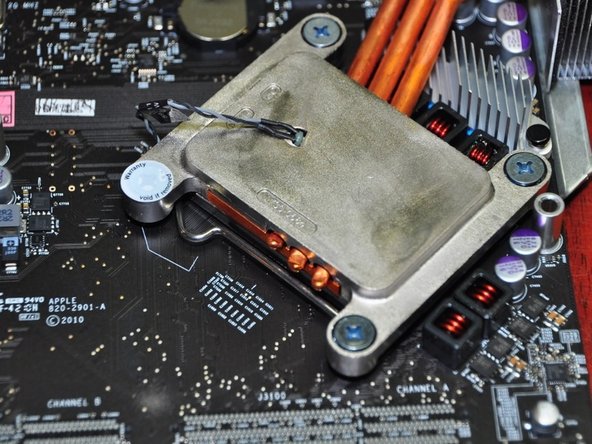

Note arrow on CPU (bottom left in picture). New CPU must be installed in the same orientation.

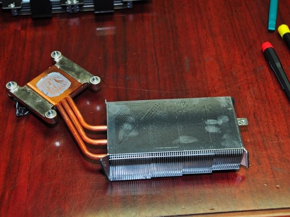

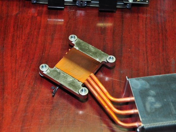

Apply Arctic Silver thermal compound with finger covered in plastic. Spread evenly on CPU only. Guide is here - How to Apply Thermal Paste
