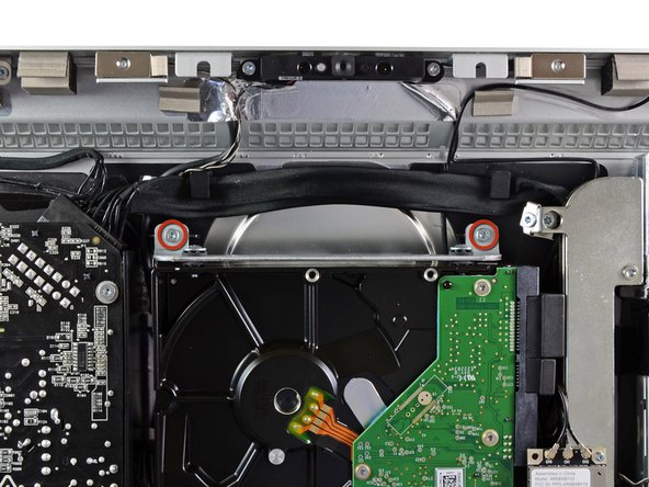

Remove the two 9 mm T10 Torx screws securing the upper hard drive bracket to the outer case.

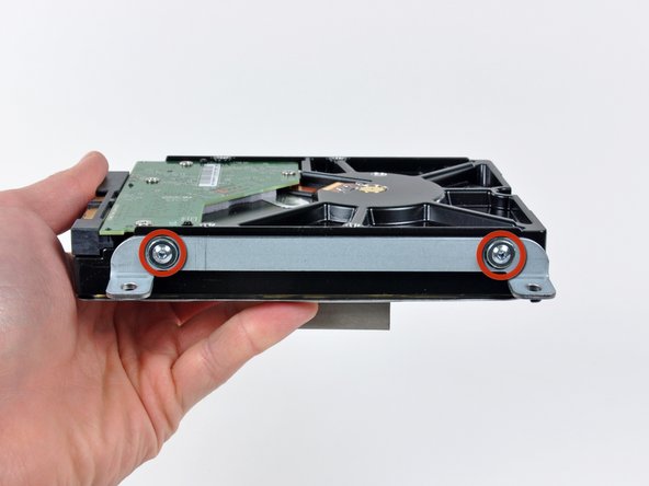

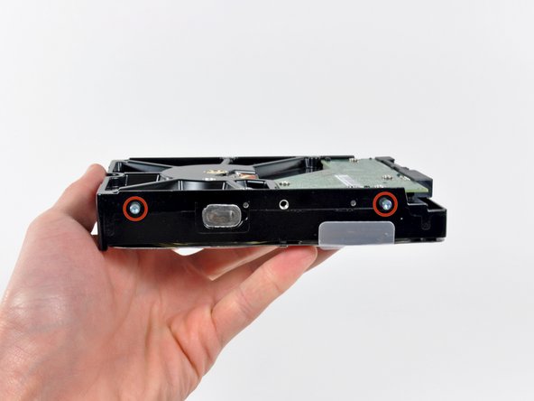

Remove the two T8 Torx screws securing the upper bracket to the hard drive.
Remove the upper bracket from the hard drive.

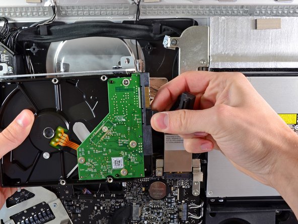

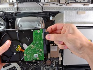

Line up the SSD connectors with the metal enclosure's sockets.
Press the drive against the enclosure sockets until the SSD is firmly seated.

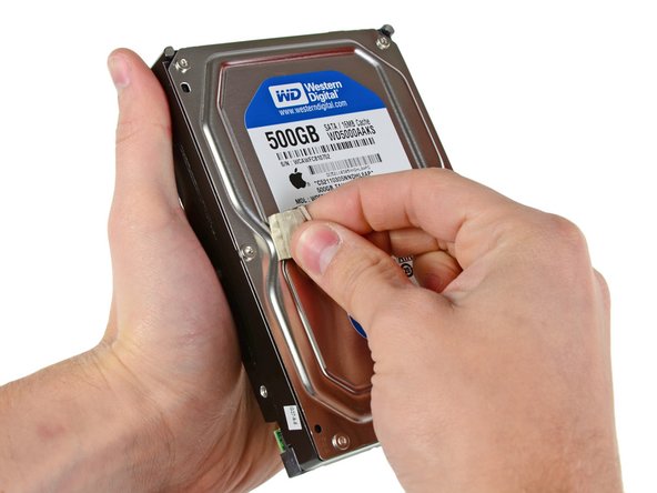

Peel the white liner off the back of the small temperature sensor board in order to expose the adhesive.
Adhere the temperature sensor board to an exposed, metal surface of the SSD, close to the SATA connector.
