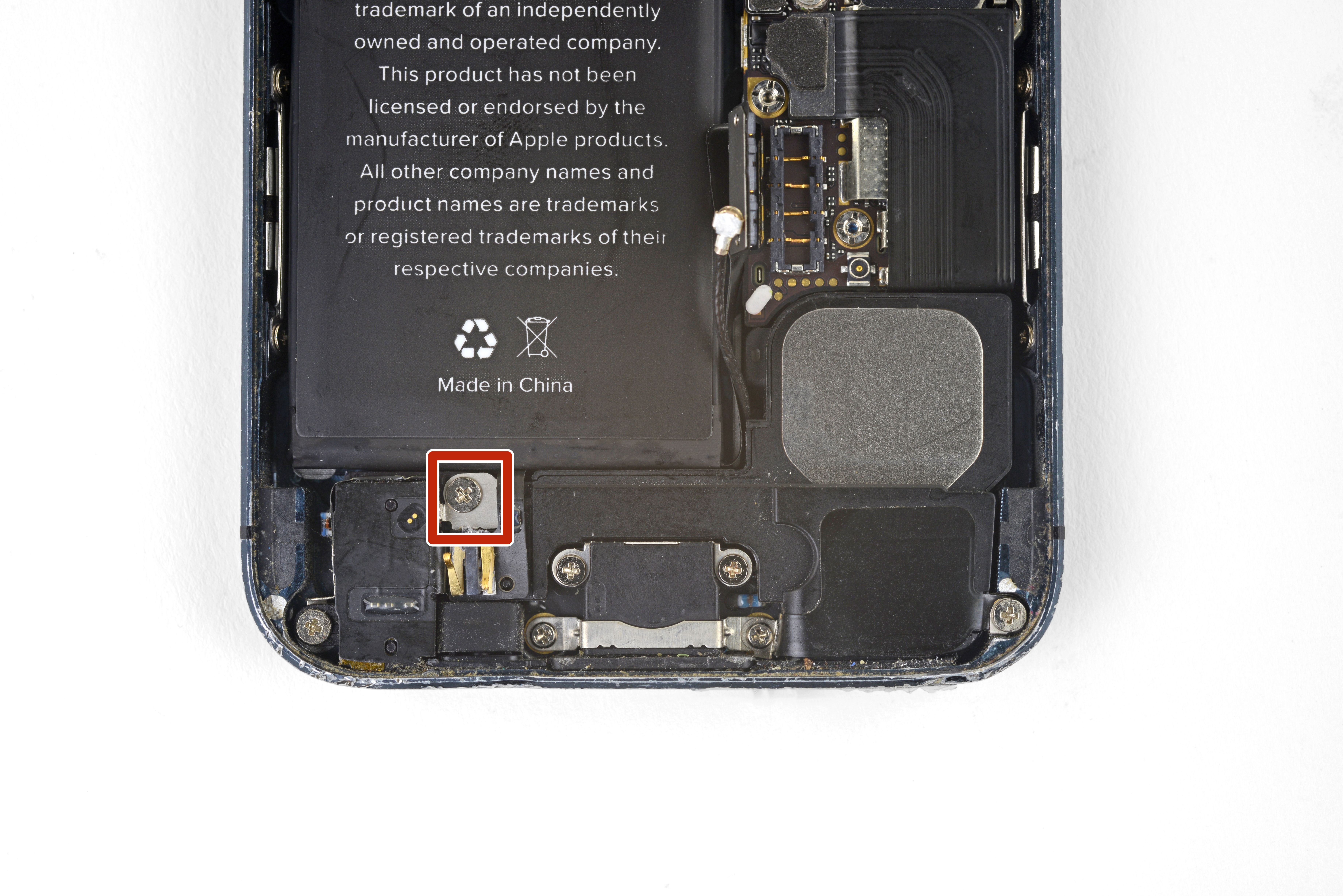

  22. iPhone 5 Lightning Connector and Headphone Jack Replacement, Lightning Connector and Headphone Jack: step 22, image 1 of 1
    • Remove the following screws securing the Lightning connector assembly to the rear case:
    • One 2.9 mm Phillips screw
    • During re-installation, make sure that the headphone jack's plastic protrusion lies above the metal washer.
    • One 1.5 mm Phillips screw
    • Two 3.3 mm Phillips screws
