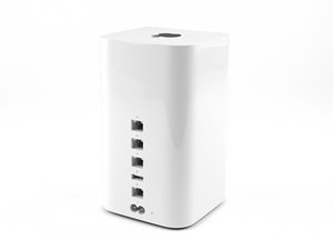

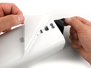

  2. AirPort Extreme A1521 Teardown: step 2, image 1 of 2 AirPort Extreme A1521 Teardown: step 2, image 2 of 2

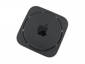

    • First to go are the protective stickers.
    • What's behind sticker number one?
    • Ports, lots'o'ports.
    • What's behind sticker number two?
    • The way in....

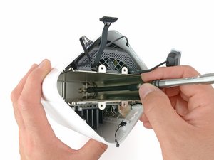

  3. AirPort Extreme A1521 Teardown: step 3, image 1 of 3 AirPort Extreme A1521 Teardown: step 3, image 2 of 3 AirPort Extreme A1521 Teardown: step 3, image 3 of 3

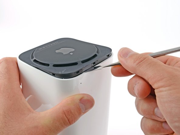

    • Alright! Enough lollygagging! Let's get inside this white brick of wonder.
    • Our method of entry involves using a metal spudger to release the retaining clips holding the black base of the device.

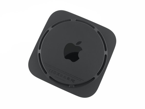

    • Base aside, our first glimpse is what appears to be a heat sink… But it's not. <Suspense>
    • Before we cast the base to the darkest depths, it has one final message for us: a new model number.
    • This year's AirPort Extreme sports the model number A1521. Neat.

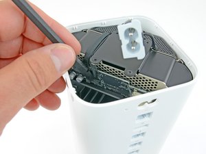

    • Just like an earlier advancement in Mac Mini technology, this new device's power supply moves inside, contributing to its extreme stature.
    • We begin to free the internals with a flick of the spudger and a twist of the Torx screwdriver. The non-proprietary T8 Torx screws come out with ease.

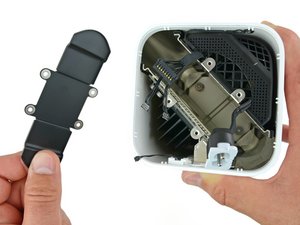

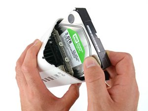

  5. AirPort Extreme A1521 Teardown: step 5, image 1 of 3 AirPort Extreme A1521 Teardown: step 5, image 2 of 3 AirPort Extreme A1521 Teardown: step 5, image 3 of 3

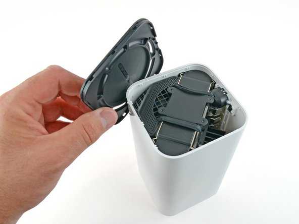

    • We free the top cover, only to find…3.5" of empty space.
    • While the AirPort Extreme doesn't come equipped with storage, we dug up a standard 3.5" SATA hard drive, just to test it out. Perfecto!
    • This could potentially be good news to DIYers who want to turn their AirPort Extreme into a Time Capsule—except we can't find any connectors where we'd plug in the hard drive, only empty spaces on the logic board. But we'll keep our fingers crossed until we've had the chance to crack open a Time Capsule.

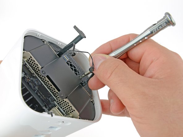

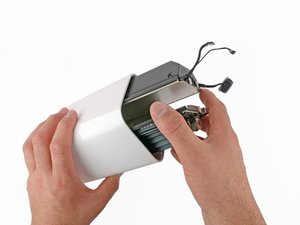

  6. AirPort Extreme A1521 Teardown: step 6, image 1 of 2 AirPort Extreme A1521 Teardown: step 6, image 2 of 2
    • We hate to see our tools collect dust, so we're happy to find that opening the AirPort Extreme requires busting out the flexible shaft extension from our 54 bit driver kit.
    • Two spring-loaded, captive Torx T10 screws are the last fasteners clinging to the outer case, but not for long.
    • Like a shucked corn cob, the innards of the AirPort Extreme escape their white plastic prison and are borne from captivity.

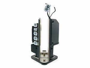

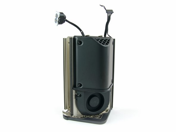

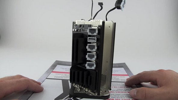

    • Using the latest in turn-table technology, we bring you the full 360º of the Extreme's internals.
    • Looking for your own turn-table technology solutions? Look no further.
    • For those of you who just can't wait to get the latest Apple product made up of vertical circuit boards surrounding a big empty space, the AIrPort Extreme is the best available for now.
  8. AirPort Extreme A1521 Teardown: step 8, image 1 of 3 AirPort Extreme A1521 Teardown: step 8, image 2 of 3 AirPort Extreme A1521 Teardown: step 8, image 3 of 3
    • Video is great and all, but let's break it down.
    • Port side
    • Starboard Slot side
    • Fan side

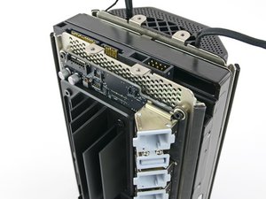

  9. AirPort Extreme A1521 Teardown: step 9, image 1 of 2 AirPort Extreme A1521 Teardown: step 9, image 2 of 2

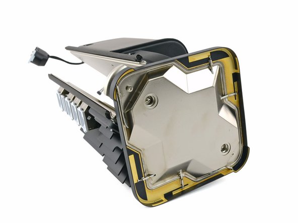

    • Next on our path of deconstruction, we work on the shiny plate that caps the innards of the Extreme, and just happens to be the new-and-improved antenna array.
    • The six antenna cables run under the apparent hard drive slot, up the center of the device, and into a big plate at the top, which functions as the antenna.
    • The updated 802.11ac Wi-Fi is designed to have multi-station WLAN throughput of at least 1 gigabit per second and a single link throughput of at least 500 megabits per second (500 Mbit/s).
    • Compared to 802.11n, 802.11ac has up to four times the RF bandwidth (up to 160 MHz), twice the MIMO spatial streams (up to 8), and four times the modulation (up to 256 QAM).

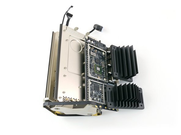

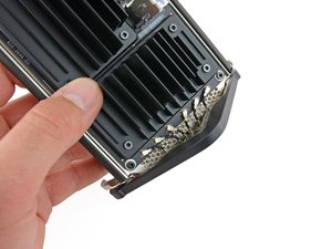

    • A slew of T8 Torx screws secure the heat sinks to the logic board, and the logic board to the possible hard drive slot.
    • With the screws out of the way, the layers slide right apart.

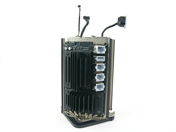

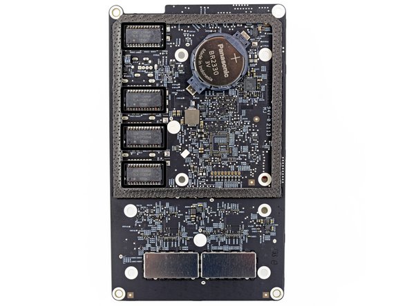

  11. AirPort Extreme A1521 Teardown: step 11, image 1 of 2 AirPort Extreme A1521 Teardown: step 11, image 2 of 2

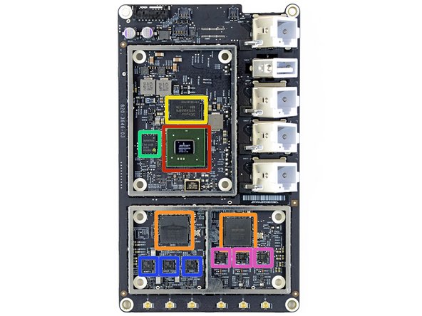

    • We finally get a closer look at the logic board. We find:
    • Broadcom BCM53019 router SOC with gigabit switch
    • Broadcom BCM4360KLMG, the same IC we found in yesterday's MacBook Air Teardown
    • Hynix H5TC4G63AFR 4 Gb (512 MB) synchronous DDR3 SDRAM
    • Micron 25Q256A 32 MB serial flash
    • Skyworks 5003L1 5GHz WLAN power amplifier
    • Skyworks 2623L 2.4GHz WLAN power amplifier
    • TDK TLA-7T201HF (which appears to be a pulse transformer)

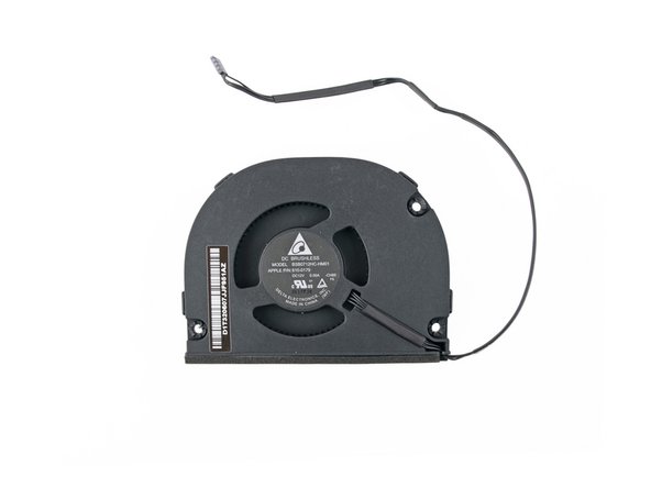

  12. AirPort Extreme A1521 Teardown: step 12, image 1 of 3 AirPort Extreme A1521 Teardown: step 12, image 2 of 3 AirPort Extreme A1521 Teardown: step 12, image 3 of 3

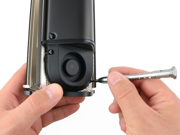

    • Fans-away! Our trusty Torx screwdriver tackles the two screws holding the fan in place.
    • The DC brushless fan is labeled BSB0712HC-HM01 and is made by Delta Electronics.
    • We quickly blow off the fan in favor of peeking under the metal casing.

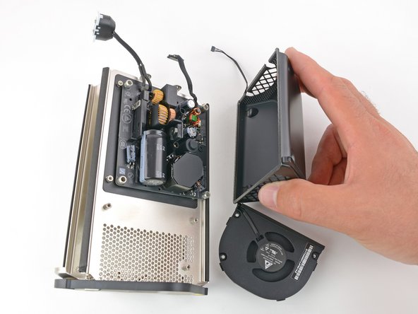

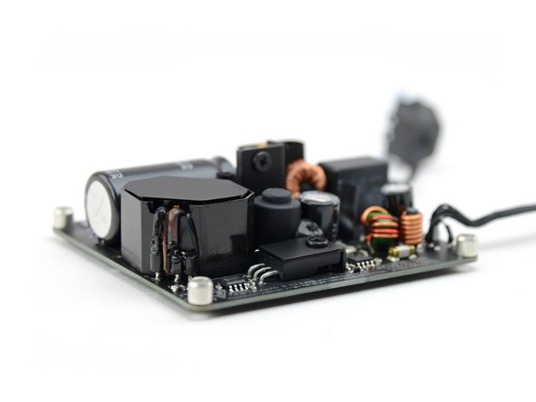

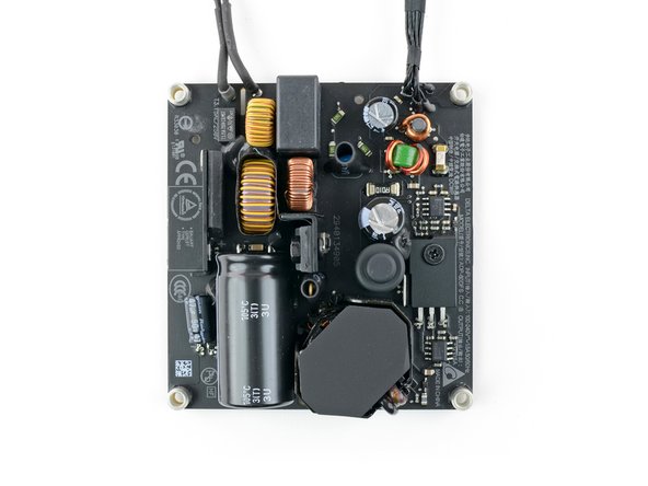

    • We've got the power…supply.
    • From the looks of it, it is a fairly standard 12 V, 5 A power supply with your standard large capacitors and coils.
    • Whatever you do, don't lick your fingers and then touch the large black cylinder. You may be shocked to discover what 400 V can do.
    • Like the fan, this unit is made by Delta Electronics. They have named it ADP-60DFS, so as not to be confused with other, less-powerful power supplies.

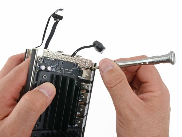

On the first images we can see 4 connectors used. Later I can only see the 2 cables. Being one of the cables the power supply and the other one the fan. What are the other two cables used for? I guess one of them is for a led in the case. is that right? No clue about the fourth one.
Mauricio Scaff - Reply
The third is for the tiny status LED, and the fourth is for the reset switch that resides next to the power plug. Both cables disappear early on in the teardown since both components are attached to the white plastic case.
