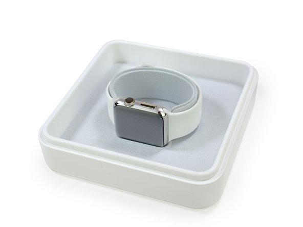

  2. Apple Watch Teardown: step 2, image 1 of 3 Apple Watch Teardown: step 2, image 2 of 3 Apple Watch Teardown: step 2, image 3 of 3
    • So ends the wait. The Apple Watch has arrived, and our first course of action is to unbox it.
    • While we'd hoped to find a golden ticket inside, we'll settle for the next best thing: the Apple Watch Sport, complete with its Sport Band, charging cradle, and power adapter.

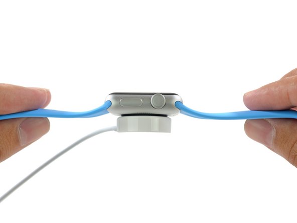

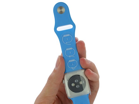

  5. Apple Watch Teardown: step 5, image 1 of 3 Apple Watch Teardown: step 5, image 2 of 3 Apple Watch Teardown: step 5, image 3 of 3
    • Before laying it out on the chopping block, we'll try something non-destructive: removing the band.
    • Pressing this button on the back case releases a spring-loaded metal peg in the band, allowing it to slide right out.
    • If you're looking forward to swapping out bands, there's not much to it, physically. However, Apple would prefer that you only use bands from the same collection. No Link Bracelets on your Watch Sport, please.

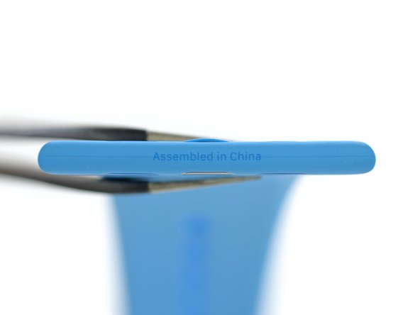

    • The Sport Band is all plastic—or, more accurately, elastomer—with no metal watch band pins.
    • Assembled in China!

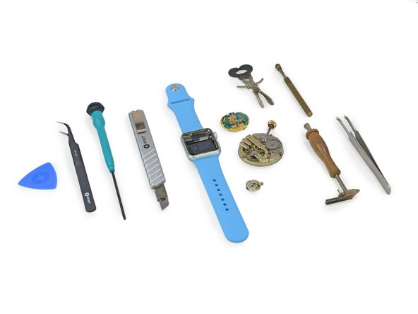

    • With this first photo, we take a moment to compare the internals of the Apple Watch with that of a classic mechanical watch as old as time itself.
    • On the right, a pocket watch mechanism, circa 1890. (At 125 years old, it doesn't look a day over 39.) On the left, a smartwatch from 2015.
    • Which of these will outlast the other?
    • Although we're still dealing with a watch, this second photo makes it clear that the tools required for routine repairs have very much changed with the times.
    • You're already familiar with our friends on the left: opening pick, tweezer, driver, and tech knife.
    • On the right, the tool with the Mickey Mouse ears is none other than a pallet fork tool. To its immediate right, we've got a pin vise. Below that, a roller jewel shlacking tool...
    • ...and to its right, tweezers! Some things really don't change. (Though our resident watchmaker informs us that it's perhaps more accurately called "the lazy man's screw holder.")

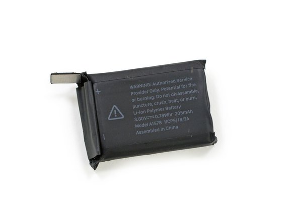

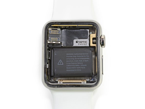

    • A quick flick of a plastic opening tool is all it takes to dispatch the light adhesive securing the battery.

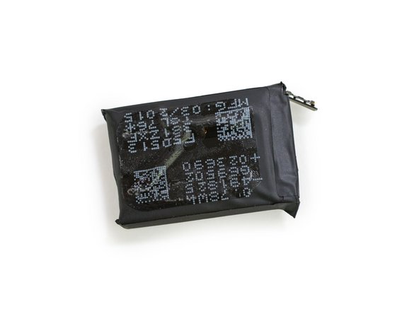

    • This wee 3.8 V, 0.78 Wh lithium-ion battery is the power behind the 38 mm Apple Watch. No gears here! Apple claims the 205 mAh battery should provide up to 18 hours of use (which translates to 6.5 hours of audio playback, 3 hours of talk time, or 72 hours of Power Reserve mode.)
    • According to Apple, the "battery performance claims are based on test results from the 38 mm Apple Watch. A 42 mm Apple Watch typically experiences longer battery life."
    • A 205 mAh battery seems miniscule in comparison to the 300 mAh batteries found in the Moto 360 and Samsung Gear Live. Hopefully, Apple's Watch OS will help the battery stand the test of time and avoid the problems that initially plagued the Moto 360.

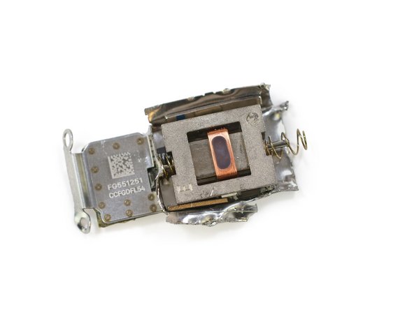

    • It's time to remove the Taptic Engine, which is attached at the hip to the speaker.
    • The Taptic Engine is Apple's take on the linear actuator. It creates motion in a straight line (as opposed to the circular motion of an electric motor), which in turn provides haptic feedback.
    • It makes sense that the Taptic Engine is attached to the speaker. When combined with subtle audio cues from the specially engineered speaker driver, the Taptic Engine is designed to output a unique motion.

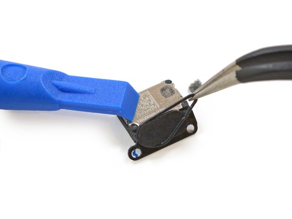

    • We carefully remove the antenna assembly, which is discreetly tucked into the recesses of the case.
    • We're betting that this 'lil guy handles the Apple Watch's Wi-Fi and Bluetooth capabilities. Recent Apple patents suggest that part of the antenna assembly may be integrated into the case.

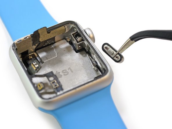

    • We quickly dispatch two very small tri-point screws holding a tiny panel to the watch case.
    • Behind the tiny panel we find a set of contacts that align perfectly with the location of the hidden diagnostic port.
    • Not wanting to make contact, we quickly dispatch this little connector.
    • Still unable to remove the diagnostic port door, we resort to pushing it free through the little holes on the inside of the case.
    • There's got to be an easier way to access the door than disassembling the whole watch—but we're not privy to Apple's secrets.

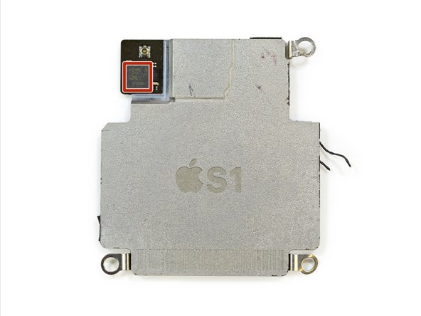

    • We remove the Digital Crown bracket, the final obstacle keeping us from the S1 SiP.
    • Cue the epic rising of the monolith.
    • We can feel the power as we slowly peel the future of humanity S1 out of the case.
    • The back of the S1 isn't as pretty as the front—with ribbon cables running to every peripheral and gobs of adhesive gripping it in place, the chip leaves a nasty mess in its wake.
  20. Apple Watch Teardown: step 20, image 1 of 3 Apple Watch Teardown: step 20, image 2 of 3 Apple Watch Teardown: step 20, image 3 of 3
    • Pulling this mess out is a destructive procedure, but after ripping out some soldered connectors we get our first real look at the S1.
    • Despite rumors (and hopes) of an upgradable product, the difficulty of removing the S1 alone casts serious doubt on the idea of simply swapping out the internals.
    • Unfortunately, our first look is obstructed—that S1-emblazoned silver cap isn't a cap at all. It's a solid block of plasticky resin, hiding treasures deep within.
    • Update: Chipworks has identified this small IC as the STMicroelectronics C451 gyroscope + accelerometer.

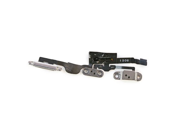

    • The Digital Crown seems to have an encoder system, like the Nest Thermostat, to read the spinning of the dial.
    • Rotary encoders work by translating the angular position of a shaft into analog or digital code that computers can understand.
    • The encoder branches off of the button cable, along with the single push button and the diagnostic port contacts.
    • All these peripherals leave us wondering whether Apple has any intention of offering an upgrade program for the Apple Watch. Stripping out the internals will be difficult and time-consuming—not the sort of thing your local Genius is equipped to handle, but we suppose Apple could provide a mail-order option.

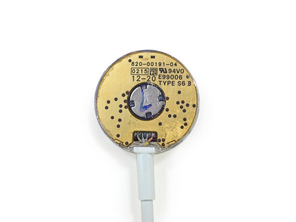

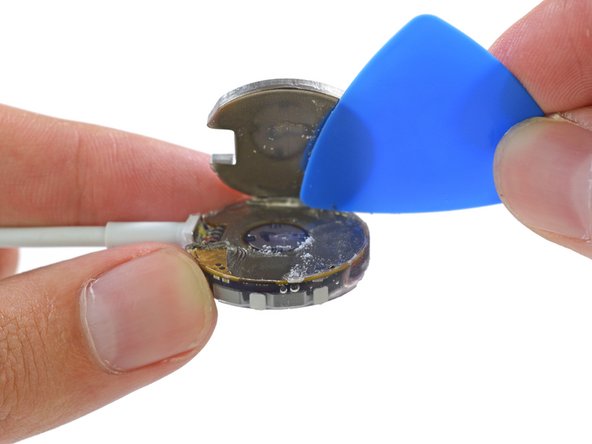

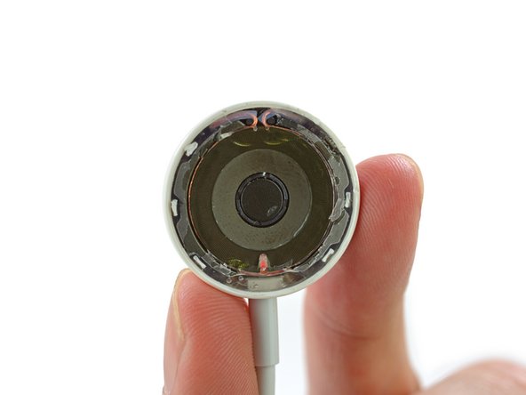

    • Apple's inductive charger is a pretty big deal, and we're always itching to open their newest adapters.
    • Officially known as the Apple Watch Magnetic Charging Cable, it features a 6.7 mm thick cradle with a diameter of 28 mm.
    • After some heat, we try to pry, and end up ripping up the back case of the mag-safe-ish charger.
    • To find it filled to the brim with glue!

    • Once you're inside, the battery is quite easy to remove—only mild adhesive holds it in place.
    • While not proprietary, incredibly tiny tri-point screws are a repair hinderance—especially when Torx or Phillips could have been used.
    • Removing any other component is essentially impossible—all peripheral cables are soldered onto the back of the S1.
    • The fully encased S1 system makes board-level repairs impossible.

    • But wait, there's more! For a limited time only, view one teardown, and get a second one free. You heard us, 100% absolutely free!
    • Meet the true Apple Watch: the Stainless Steel model.
    • Curiously enough, the standard Apple Watch has an entirely different box than the Watch Sport. This may be to accommodate the various bands that can't be laid out flat like the Sport Band.
  28. Apple Watch Teardown: step 28, image 1 of 3 Apple Watch Teardown: step 28, image 2 of 3 Apple Watch Teardown: step 28, image 3 of 3
    • Having perfected our pick procedure, we pop the hood on the Apple Watch Stainless Steel.
    • No surprises here. The same clips and connectors greet us inside.
    • It looks like not too much has changed. The mounting bracket for the Digital Crown looks significantly more substantial, and the bottom features gold tri-point screws.
    • That's all for now—but we're not done yet. With several mysteries left, iFixit will be back soon with more analysis.
