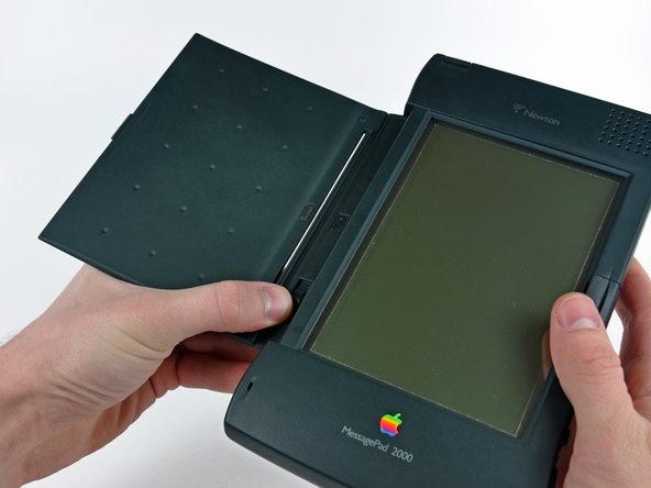

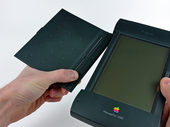

  8. Apple Tablet Teardown: step 8, image 1 of 2 Apple Tablet Teardown: step 8, image 2 of 2
    • Push the sliding tab attached to the inner hinge of the display cover toward the top of the Newton.
    • Pull the bottom edge of the display cover away from the outer case and remove it from the Newton.

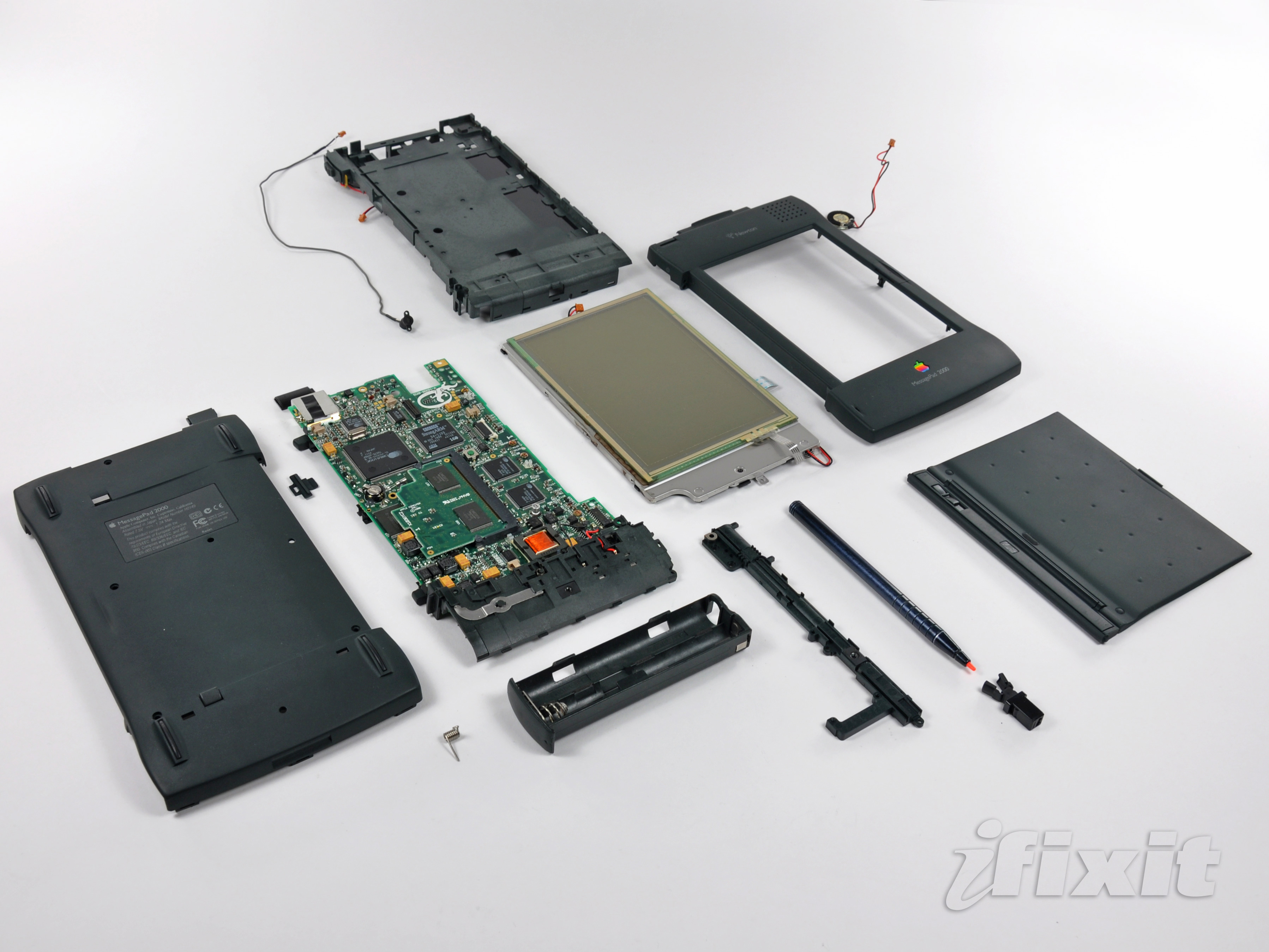

    • As always, the final layout shot of our finished process.
    • Our hunger for an Apple tablet teardown has been satisfied for the moment. The countdown has begun for the ever elusive Apple iPad.
    • The time has come once again when we must part ways, but worry not, for we will be reunited again soon.
