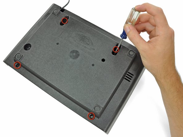

  3. Atari 2600 Teardown: step 3, image 1 of 2 Atari 2600 Teardown: step 3, image 2 of 2
    • There are four screws holding the upper and lower case together.
    • Hmm, these screws in the back are at an odd angle: almost 30 degrees off of vertical! Strange.
    • With such a large console, there must be a ton of awesome components inside...

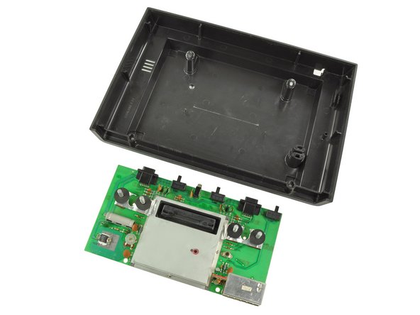

  4. Atari 2600 Teardown: step 4, image 1 of 1
    • ...Or not. Seriously? That's it? The case design team must have wanted to give lots of breathing room to the motherboard team, just in case. (Actually this is the third version of the internal hardware, the first took up much more of the case.)
    • Jay Miner was able to integrate the display and sound chip into a single IC, thereby reducing the footprint of the motherboard, but the case size still seems rather hyperbolic.
    • With a design that is unseen in just about any other electronic device, the motherboard is propped up and sits at an angle of 30 degrees inside the Atari. Now those case screws make sense!

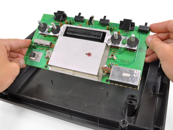

  5. Atari 2600 Teardown: step 5, image 1 of 3 Atari 2600 Teardown: step 5, image 2 of 3 Atari 2600 Teardown: step 5, image 3 of 3
    • Finally, cables that are not soldered to the board! (Take note, Studio II.) The RCA cable is easily removed.
    • The motherboard easily lifts out, as there are no additional screws or clips holding it in place. The only thing securing it down were the angled screws we removed from the outer case.
    • The motherboard measures 9.75" x 5.25" and the lower case measures 13.75" x 9.75".
    • The case of the 2600 is 2.6 times larger than the motherboard!

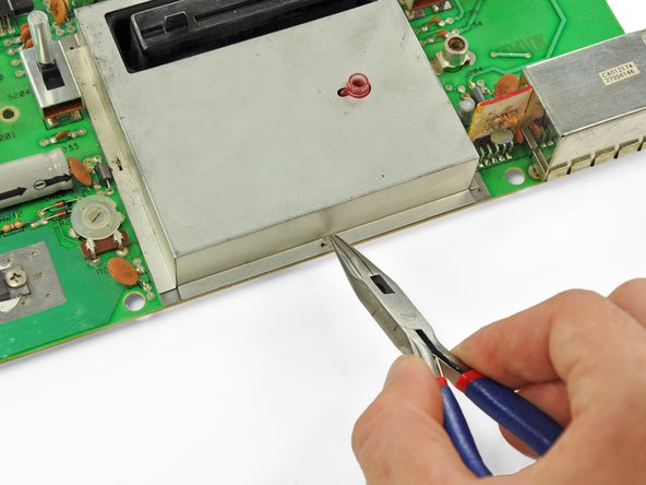

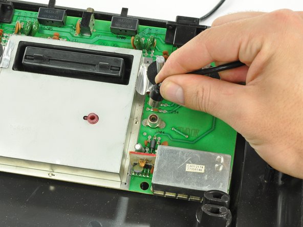

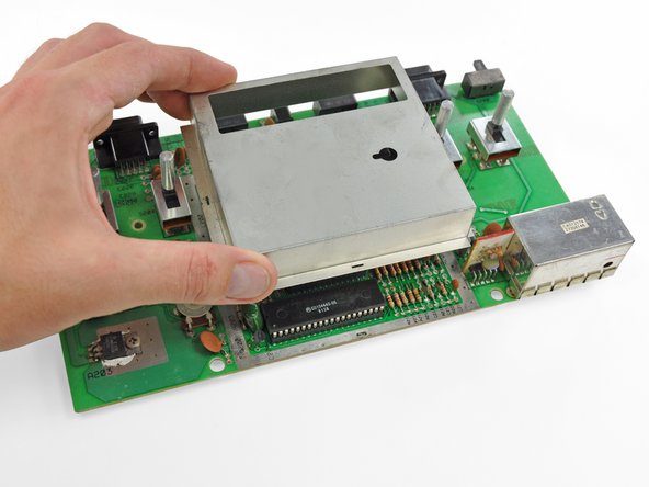

  6. Atari 2600 Teardown: step 6, image 1 of 3 Atari 2600 Teardown: step 6, image 2 of 3 Atari 2600 Teardown: step 6, image 3 of 3
    • The motherboard of the 2600 is dominated by an ominous metal box, likely the EMI shield covering the ICs.
    • Our efforts to access the brain of the Atari are temporarily thwarted by four metal tabs.
    • A few short twists with pliers and the EMI shield lifts free.
    • Atari gets a +1 on repairability for not soldering the shield to the motherboard, as some recent manufacturers have done.

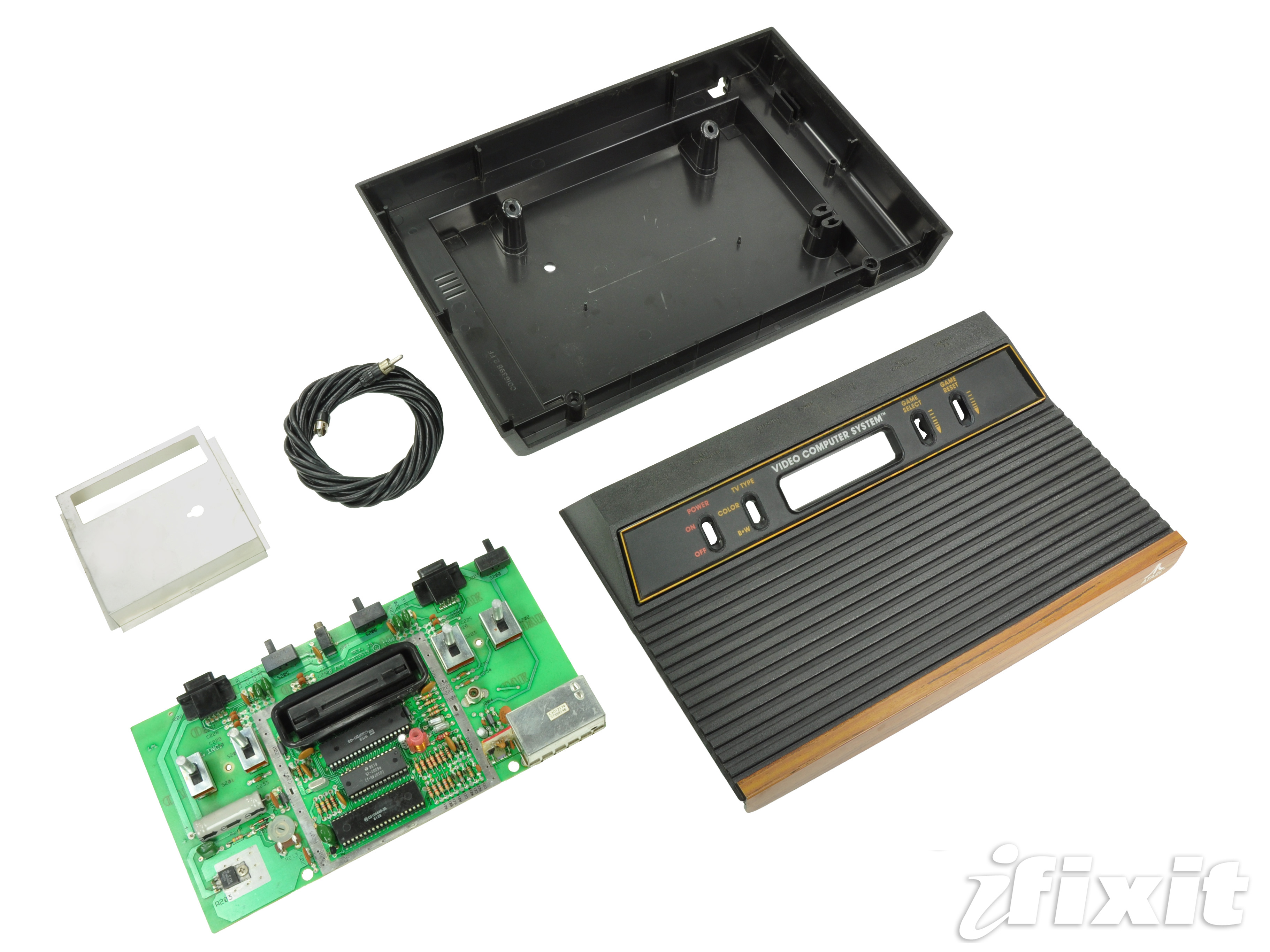

  11. Atari 2600 Teardown: step 11, image 1 of 1
    • Behold the Atari in all five of its parts!
    • We give the Atari 2600 a big plus for repairability. Every component is attached via through-hole solder, so replacing a burnt out resistor or IC is quite feasible.
    • We're sad to say that we don't have parts for the Atari 2600, but we do have a brand new game console parts store to help keep your (slightly more modern) consoles running.
