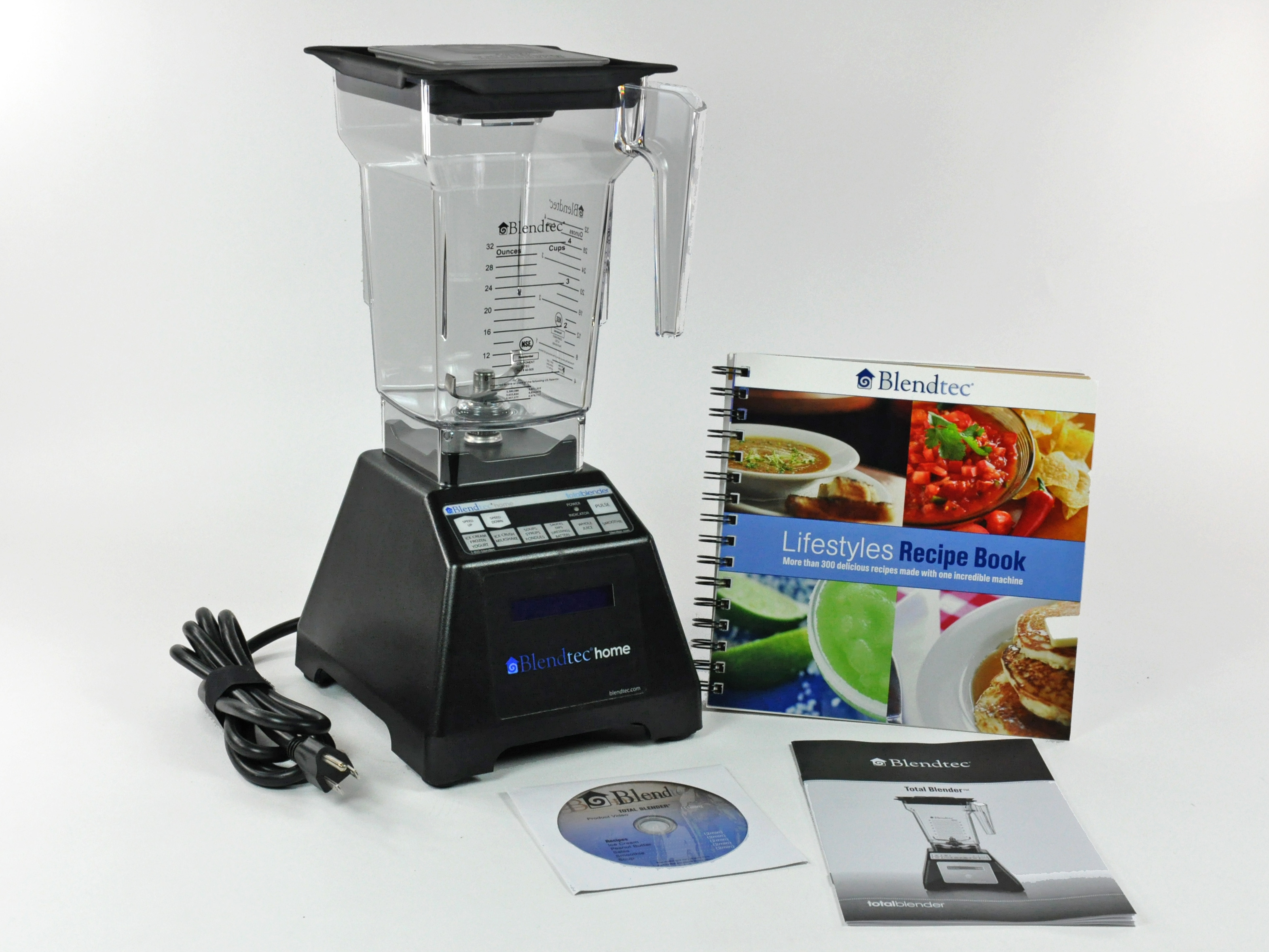

    • Our friends at Blendtec were awesome enough to lend us a blender for this teardown!
    • $400 gets you:
    • Their awesome "base" 1560W Total Blender (as if you can call anything with 1560 Watts "base")
    • Instruction manual
    • CD-ROM with product tour and video recipes
    • Lifestyles Recipe Book, good for many blenderiffic creations

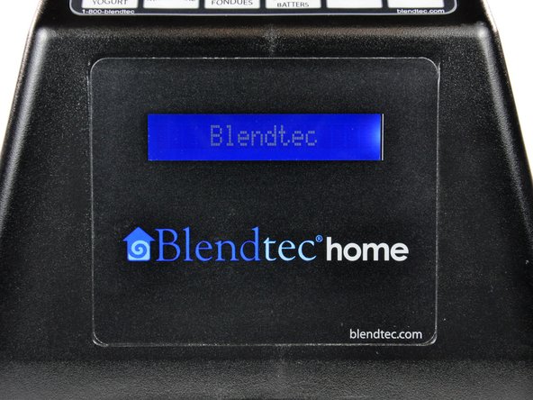

    • Fully digital controls, along with an LCD display. None of that "push-button" stuff found on $30 blenders.
    • But will it blend?
    • We were so anxious to open up this puppy, we never found out. We'll take the word of thousands of satisfied customers, as well as Blendtec's hilarious videos.

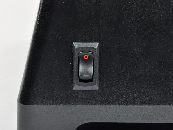

    • A mechanical switch on the back of the unit stops any bad ideas from turning into deadly ideas.

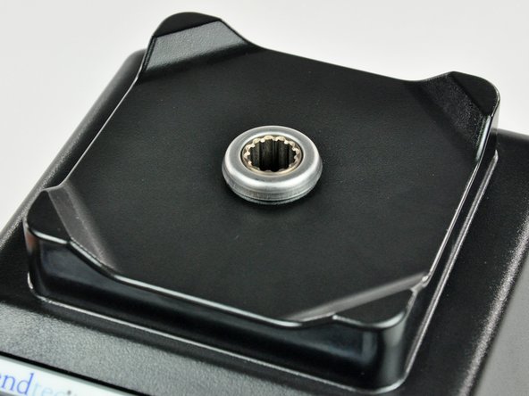

    • You'll notice the absence of plastic. Other blenders use plastic shafts as a safety mechanism. If the blade gets stuck, the blade/motor connection will sever, as the plastic will either break or melt.
    • The Total Blender has several electronic monitors that enable it to have a full metal shaft. That's how it transfers all that power to your ice cubes.
    • The splined connection between the motor shaft and the blades is perfectly suited to transfer the astronomical torque of the motor to the edge of the rotor blades.

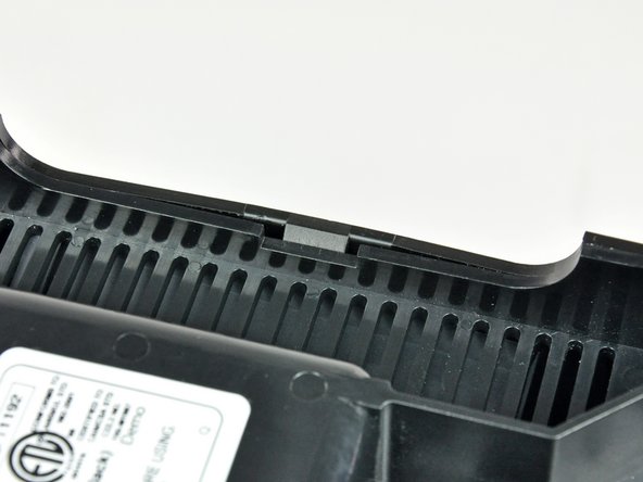

    • The bottom of the blender. Best place to go if you need your serial number.
    • Remove the two Phillips screws (deeply) recessed into the bottom housing.
    • Four side tabs hold the plastic bottom housing in place. Opening the blender is as easy as one, two, three, four.
    • The bottom housing is very ventilated -- essential for cooling the 1560W motor housed within.

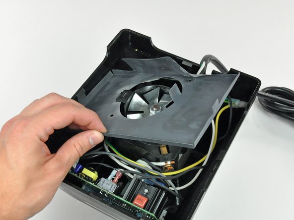

    • There's another thin plastic cover underneath the main cover. Nothing too exciting yet.
    • The cover most likely directs air toward the vents in the bottom housing.
    • Notice all the free space. This is the type of device mostly unaffected by the trend to shrink all components as much as possible.

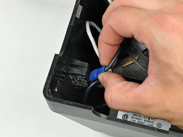

    • Now onto the fun stuff.

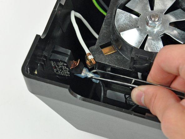

    • Connectors abound!

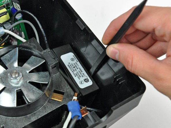

    • We begin by pulling out the power switch -- can't be too careful nowadays, especially with the recession and all...
    • Another spade connector lies underneath. We pulled that one out too.
    • Insert a spudger between the EMI power line filter and the case to separate the double sided tape. The unit comes right off after a couple of spudger twists.

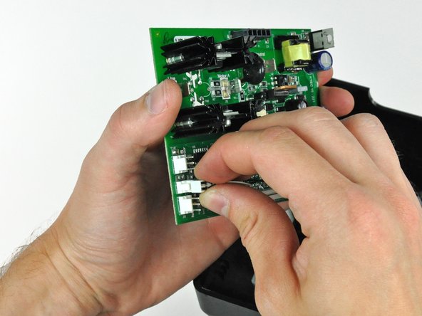

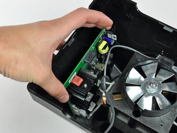

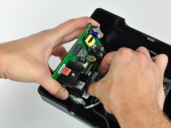

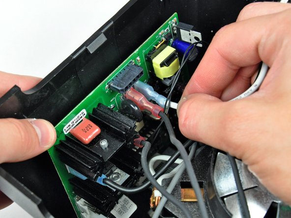

    • Onto the logic board, which may be the most important of all the internal goodies. It regulates all the aspects of operation and safety for the device.
    • The logic board simply sits on brackets molded into the plastic housing. No screws!
    • Disconnect a couple of spade connectors from it, and slide it out a bit to reach the control panel ribbon cable connector.
    • Disconnect the control panel ribbon cable from the board. This should almost free the logic board from the rest of the blender.
  8. Blendtec Total Blender Teardown: step 8, image 1 of 2 Blendtec Total Blender Teardown: step 8, image 2 of 2
    • Two more connectors, and the logic board is free to roam about the country!

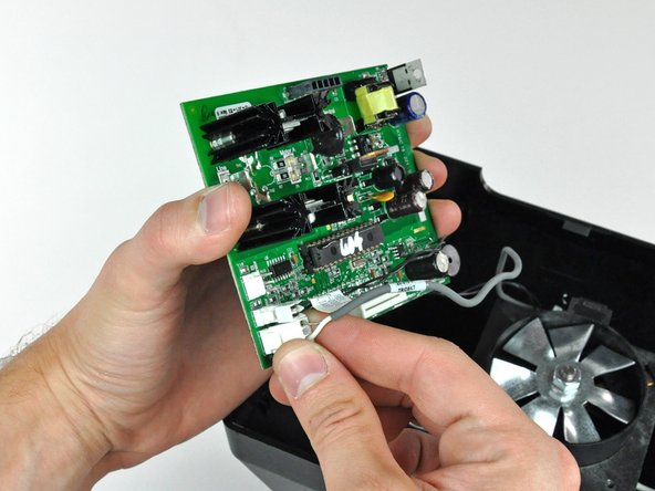

    • The logic board.
    • First picture shows the shininess of the logic board. The board is clear-coated to prevent condensation from attacking the electronics.
    • The hi-res version of the board shows all the intricate details -- inductive pickup/rotor sensor plugs, the thermistor plug, etc.
    • The LCD panel is located on the back of the board, thus eliminating the need for any extra circuit boards.
