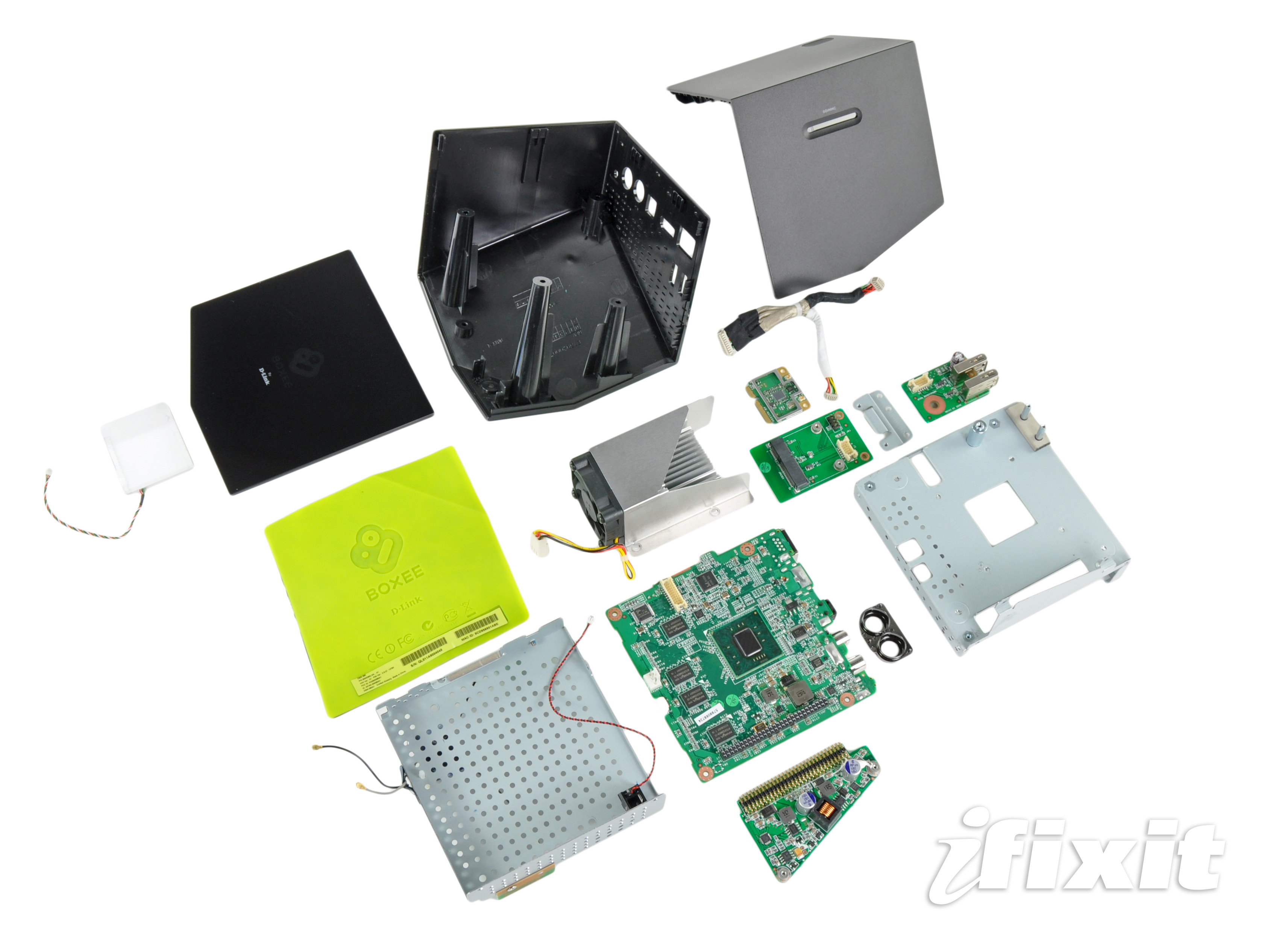

    • Ladies and gentlemen, iFixit is proud to present the Boxee Box by D-Link.
    • It's hard to ignore how much taller the Boxee Box is than the Apple TV and Logitech Revue. This half-sunken cube will definitely stand out in your entertainment system.
    • Yet, we feel that the Box has build quality that rivals Apple's, and is much more solid-looking than the Revue. The front panel is made of glass sturdy plastic and displays a Boxee logo once you power on the device.

    • Boxee Box Repairability: 7 out of 10 (10 is easiest to repair)
    • The Boxee has a separate power board that can be replaced independently from the motherboard, should it ever fail.
    • All Phillips screws were used inside the device, requiring you to have just one screwdriver.
    • Once inside, all components come apart pretty logically.
    • The green rubber bottom of the Boxee Box is difficult to remove, and will never look the same once you've removed it.
