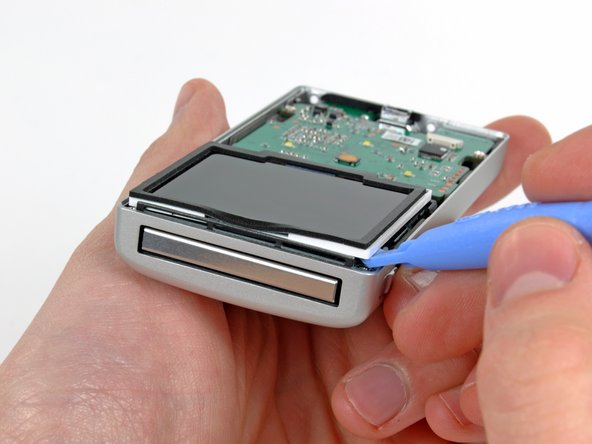

  8. Flip MinoHD Teardown: step 8, image 1 of 2 Flip MinoHD Teardown: step 8, image 2 of 2
    • Use a plastic opening tool to carefully lift the top edge of the display out of its bracket.
    • It may be necessary to use a metal spudger to release a small piece of film stuck between the LCD and the display bracket.

    • To access the display data cable, use a plastic opening tool to pry the metal and plastic display brackets off the logic board.
  10. Flip MinoHD Teardown: step 10, image 1 of 2 Flip MinoHD Teardown: step 10, image 2 of 2
    • Carefully use your fingernail to flip up the retaining flap on the display data cable ZIF socket.
    • Pull the display data cable out of its socket and remove the display.

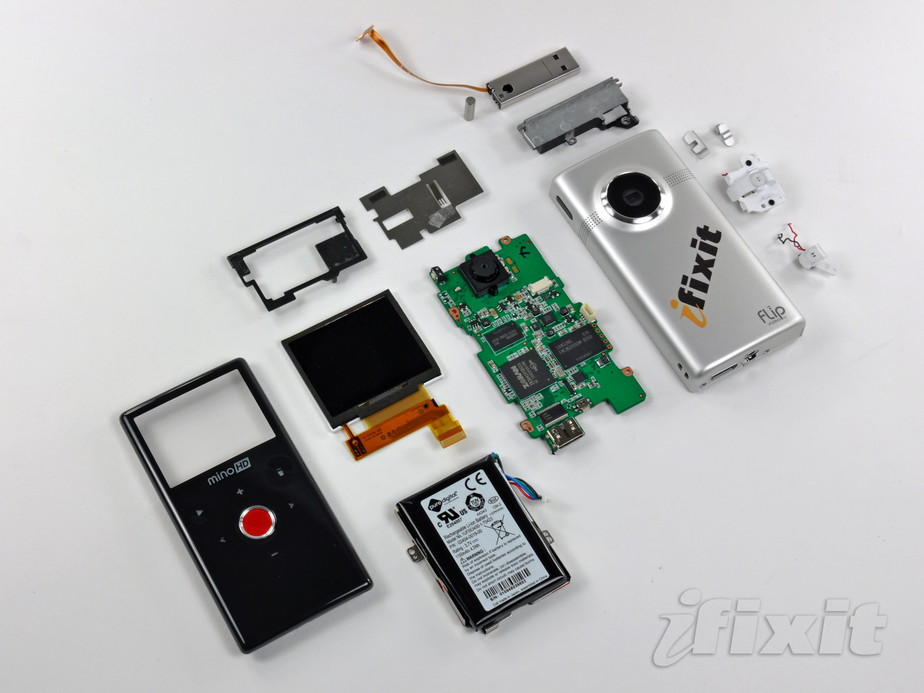

    • The big players on the logic board include:
    • A Zoran COACH (camera on a chip) 12 processor featuring real-time lens distortion compensation and noise reduction.
    • Samsung's 934 KMCMG0000M-B998 8 GB NAND flash memory for video storage.
    • One Samsung K4T51163QG 512 Mb DDR2 SDRAM chip.
    • Texas Instruments' TPD12S521 to protect the board from electrostatic discharge through the HDMI port.
    • Cypress' CY821434-24LXTI PSoC presumably for encoding signals received from the capacitive touch controls.
